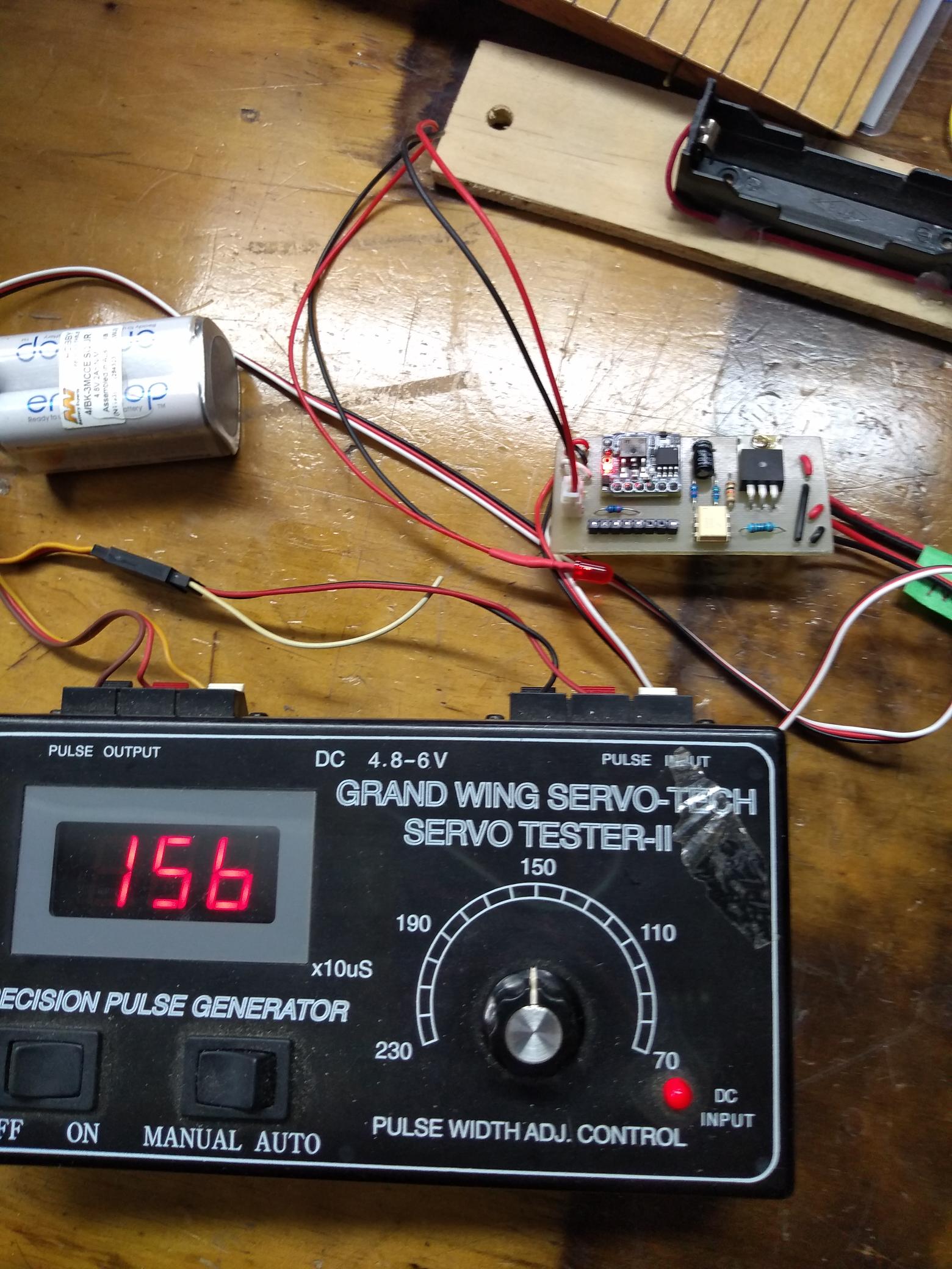

Dragged out the Citabria from the rafters which I had fitted a Supertigre 3000 to previously.
Remember the Nephew sold out all his prop driven gear and he gave me a near new Evolution 33cc spark engine way back when.

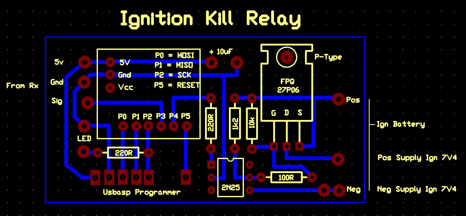

Short story, fitted that but requires and ignition kill operated from the radio.
So made up one with an ATtiny85 module and an opto operated high side mosfet.
Nothing new about it, just thought I'd poke it in here.
