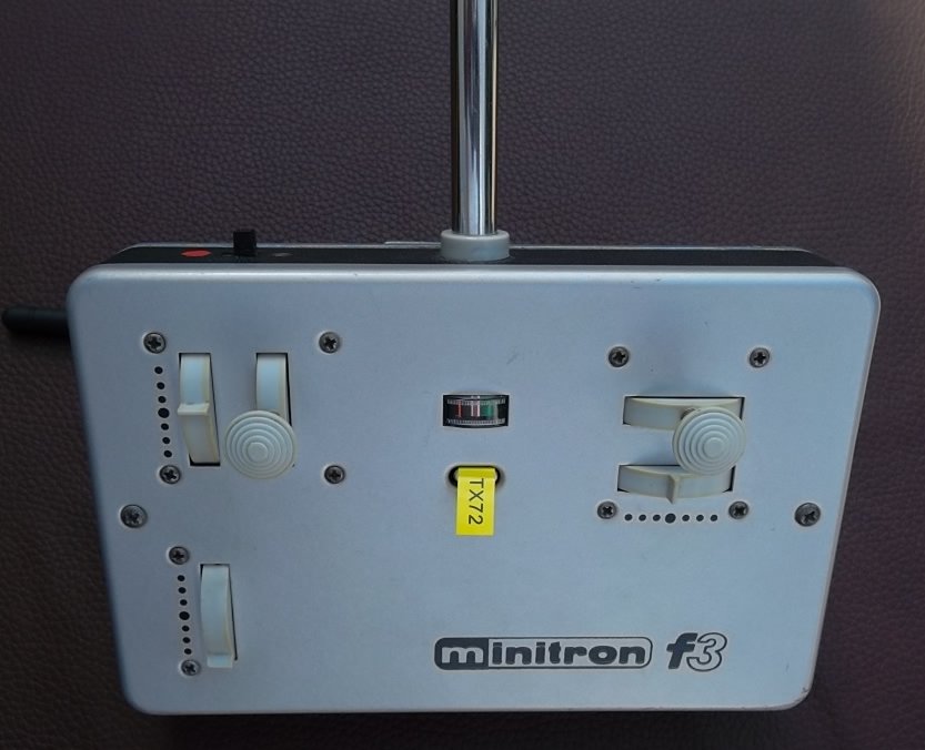

Thanks for posting the pictures of the Minitron, it is a lovely set and a manufacturer I had never heard of before.
At first, I thought it was a model of OS Minitron that I was not familiar with, but after reading your post, I realise it is a German-made set and has no link to the OS Minitron sets, it's just a coincidence they were both called Minitron. It looks in new condition, had it previously been used?

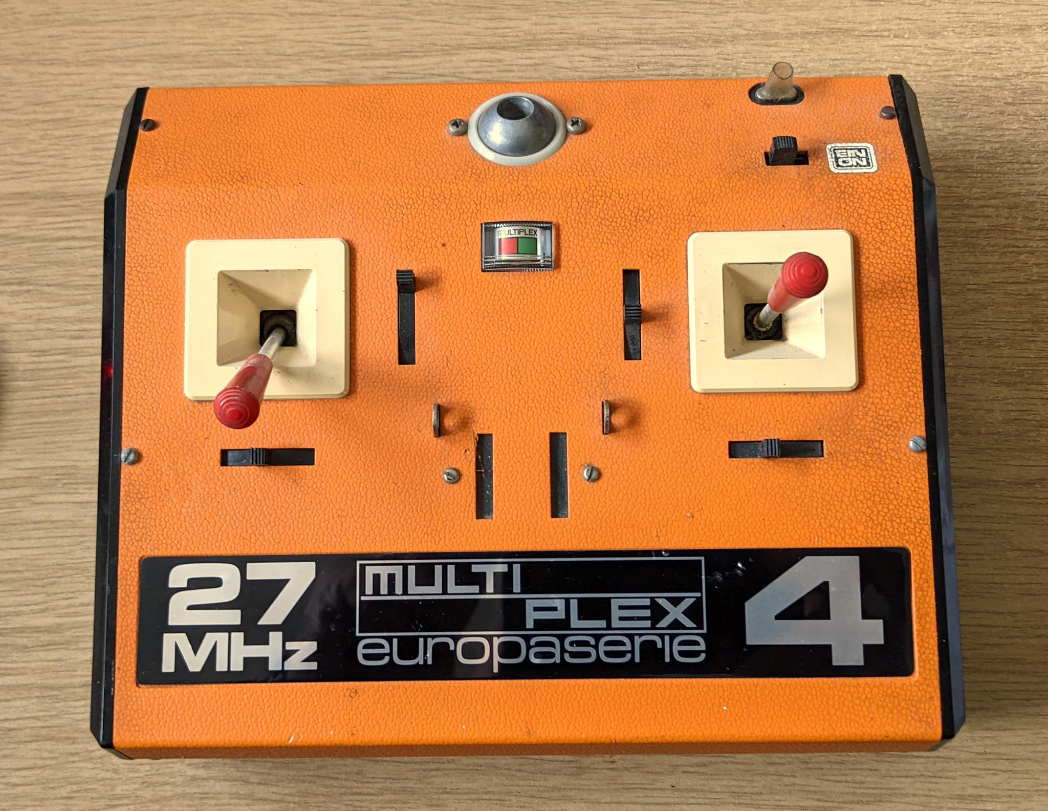

Which Multiplex Europa Serie were you planning to convert? The orange Multiplex Europaserie is one of my favourite transmitter, I have the one below waiting for conversion with a GTB encoder and probably LemonRx module, it should all fit nicely :)

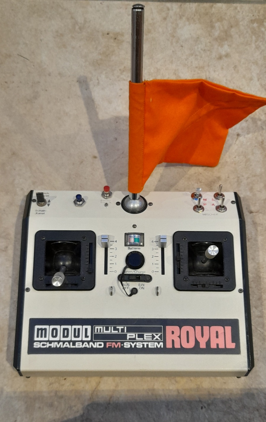

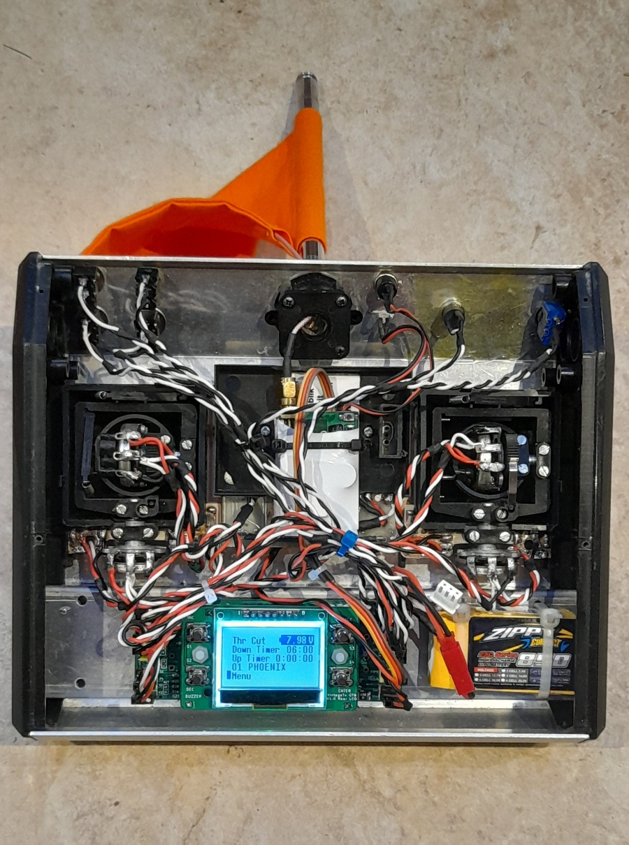

As it 'appens I have just finished converting a Multiplex Royal using one of Mike's new boards. This is basically a GTB board but because I didn't think I could remove the front label without damaging it and because the back of the case comes off quickly and easily, I went for the "R" version which faces inwards and has the screen raised above the main board.
It uses 7 of the available 8 channels, the four switches at top right of the case are three Rate/Expo switches + Throttle Cut. To the left of the antenna the Red button is the Bind button for the Orange Tx module and the Blue button is Trim Memory. The switch at top left is the switched channel.
The model I am using it with is an electric glider with Ailerons and separate Flaps. I am using the Aileron differential and Aileron/Rudder mix functions and the encoder also has up to eight programable mixers of which I have used two...... One to apply a little down Elevator with Flap and the other to mix Throttle with elevator to cope with a huge trim change with power. The mixers are really easy to program and I have to say that the tranny is just a delight to use.......... PFM!
