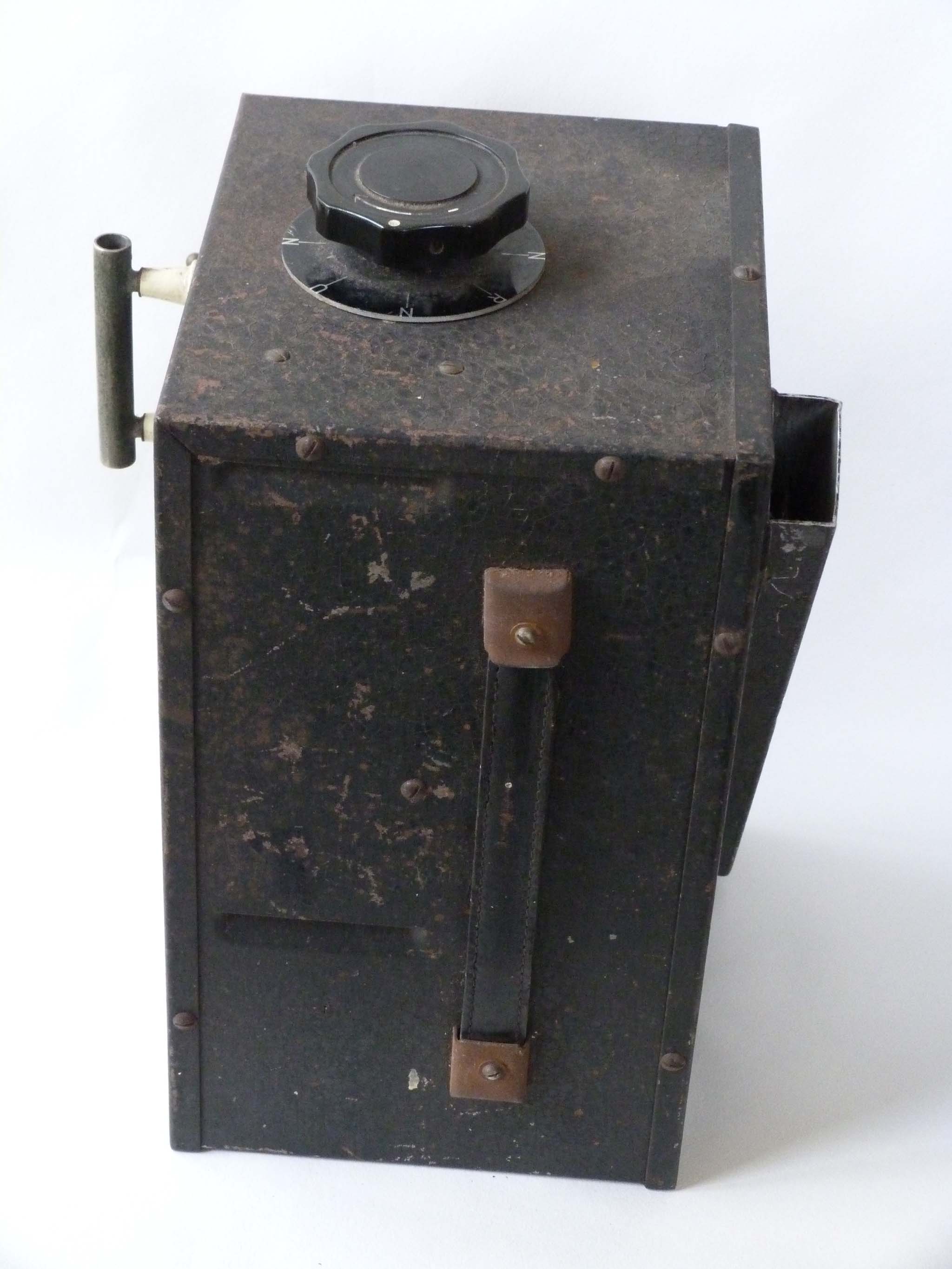

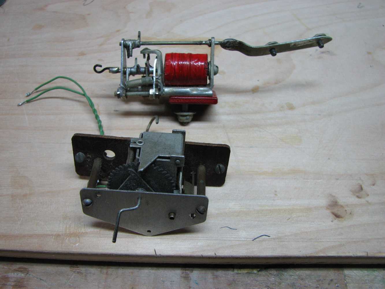

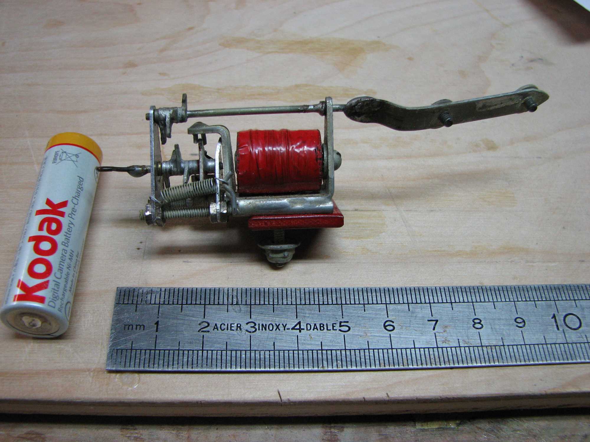

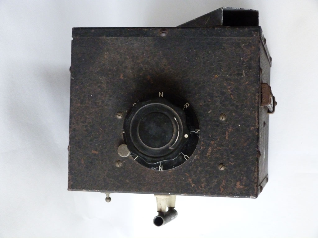

Got a working unit of the Rudevator cheap off the Ebay. The seller though it was some sort of relay...Here are a couple of pictures.

Great find!
