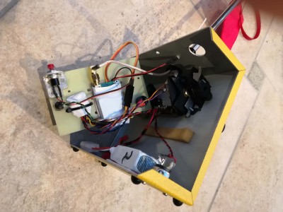

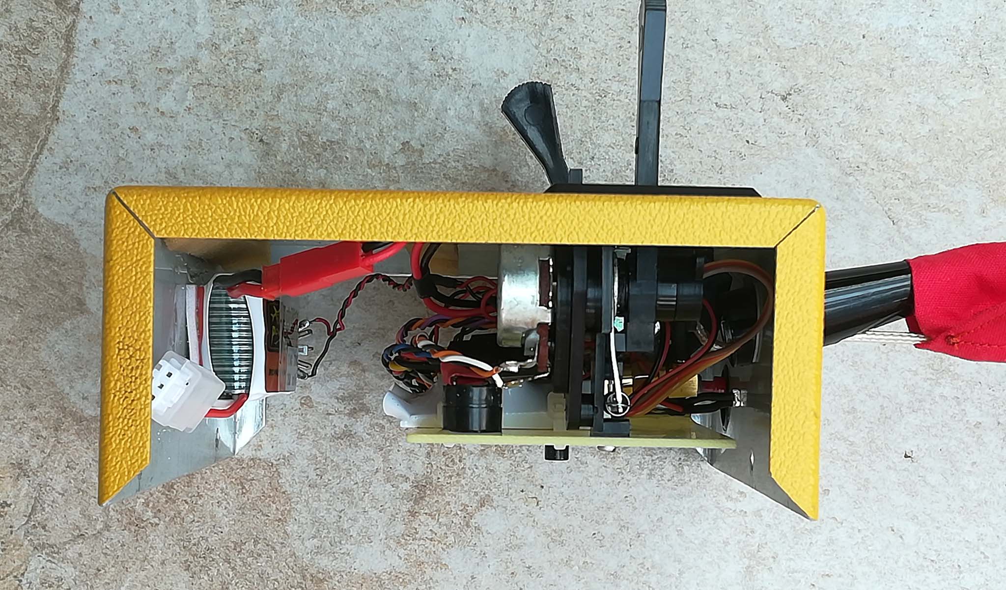

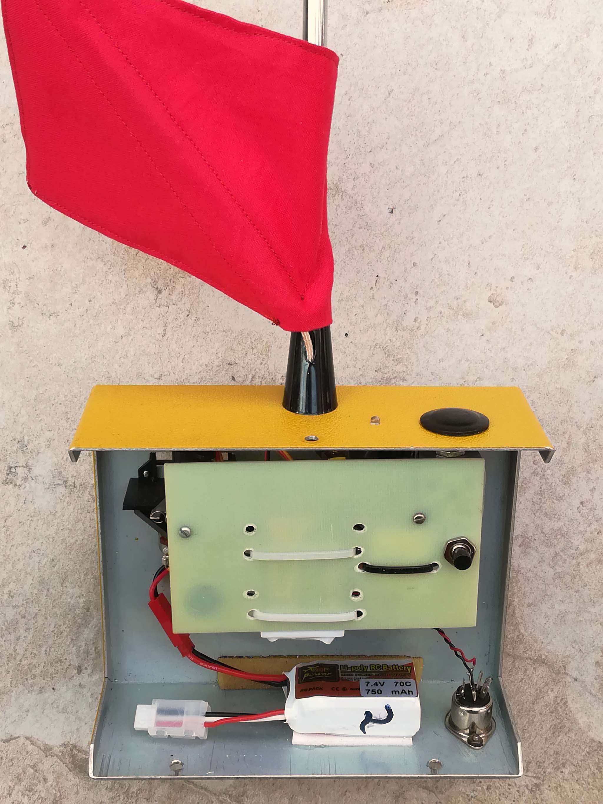

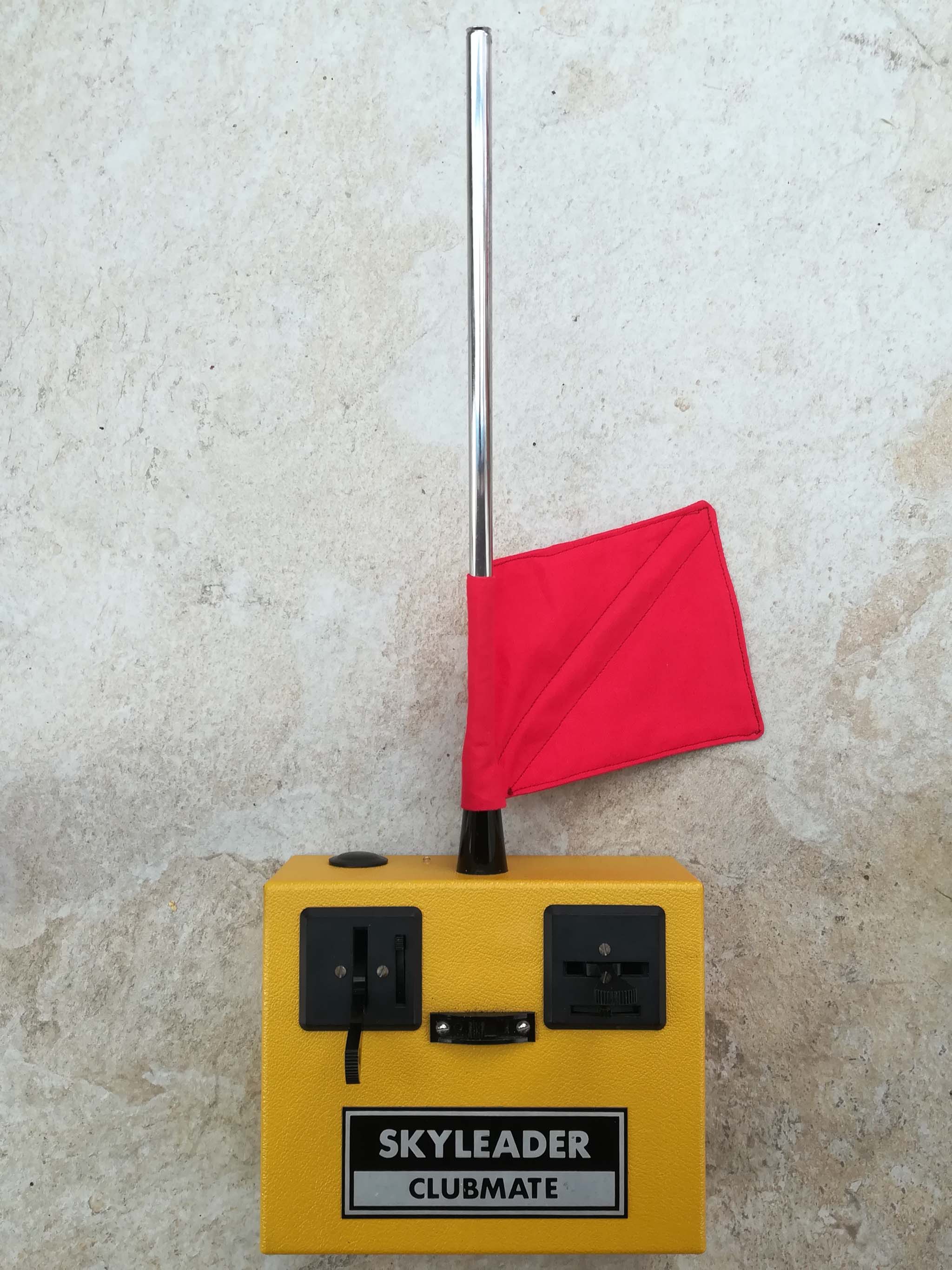

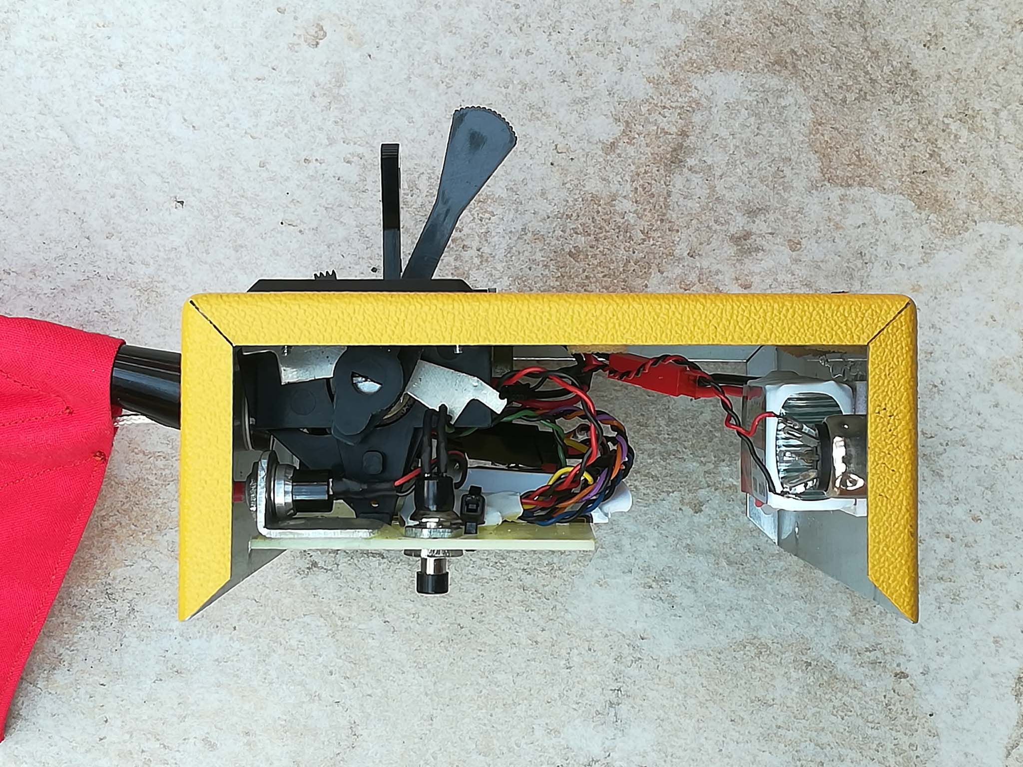

I confess that I had never seen a 2 channel Skyleader Clubmate until I found this one but when I saw it, I just had to have it as it is perfect for the "Rudder Only" Spot Landing events at Old Warden. Conversion using a rudder/throttle variation of Phil's 2+1 Digispark and an Orange DIY Tx module was really simple and though I haven't flown it yet, it is bound to the new model I've built for the May OW event and now I'm just waiting for some decent weather......
Outwardly I have tried to keep it as it was, the only external sign of the conversion is the flashing LED in the top. The antenna is hidden in the frequency pennant and the binding button is accessed through the hole in the top that was originally used for changing the crystal. The extra (black) button on the board is the "+1" channel that was the throttle button on the 2+1 which, though not used for a throttle, is used for calibration. The whole thing is just delightfully simple and in keeping with the spirit of "Retro". :)
