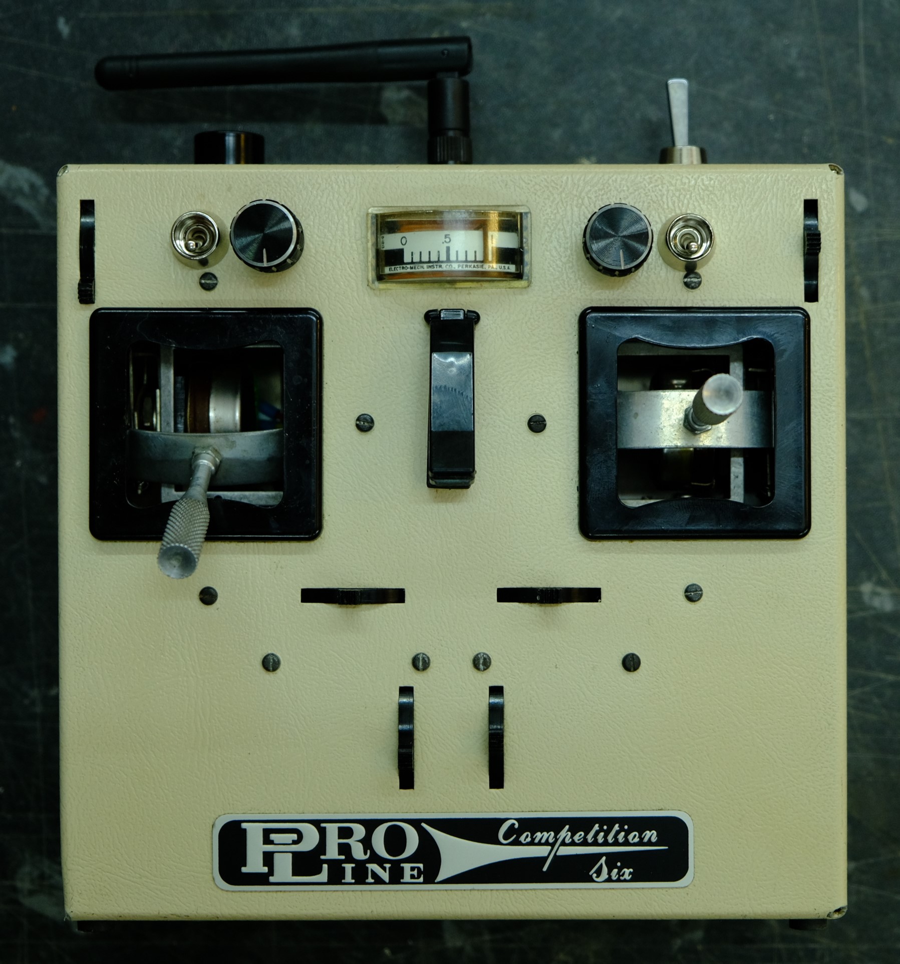

Built a Heathkit GD-19 in 1969. Been flying RC ever since!
