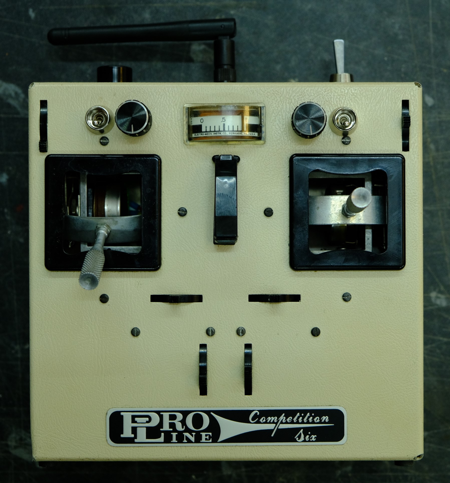

My DIY module found its way with one of Mike's Encoders into this fella..
Range and boot up time is comparable with the Orange DSM modules, but as Paul has said it is so tiny...not much bigger than a Digispark!
