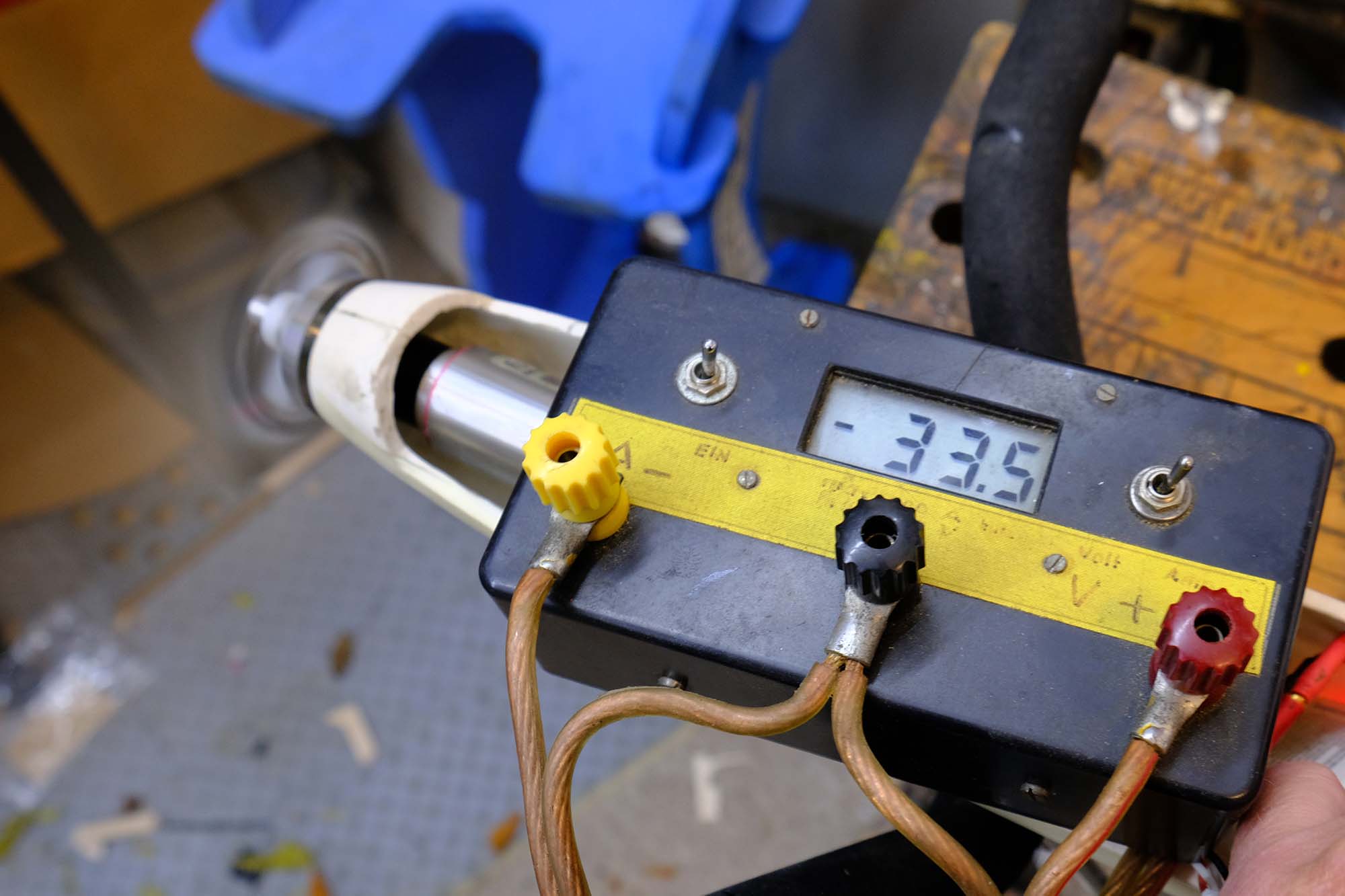

12/ 6 seemed to cause a current drop to about 20A so need to look at that again with a freshly charged battery.
Tried an AeroNaut 12x7 with a fresh battery and current was initially high thirties and dropped to a steady state of 33.5 Amps.
