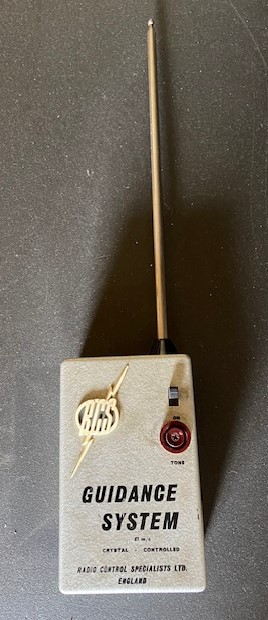

Hi Stew - I'd like to see some pictures of how it all connects together inside please, if you have them.
Once I'd mentioned that I was making some vintage models and planning to convert some old transmitters one of my flying pals brought a shoebox full of goodies to the field, including one of those RCS single channel transmitters, which looks to be in good condition, together with several escapements. I'd forgotten how long 27mhz aerials were :)
