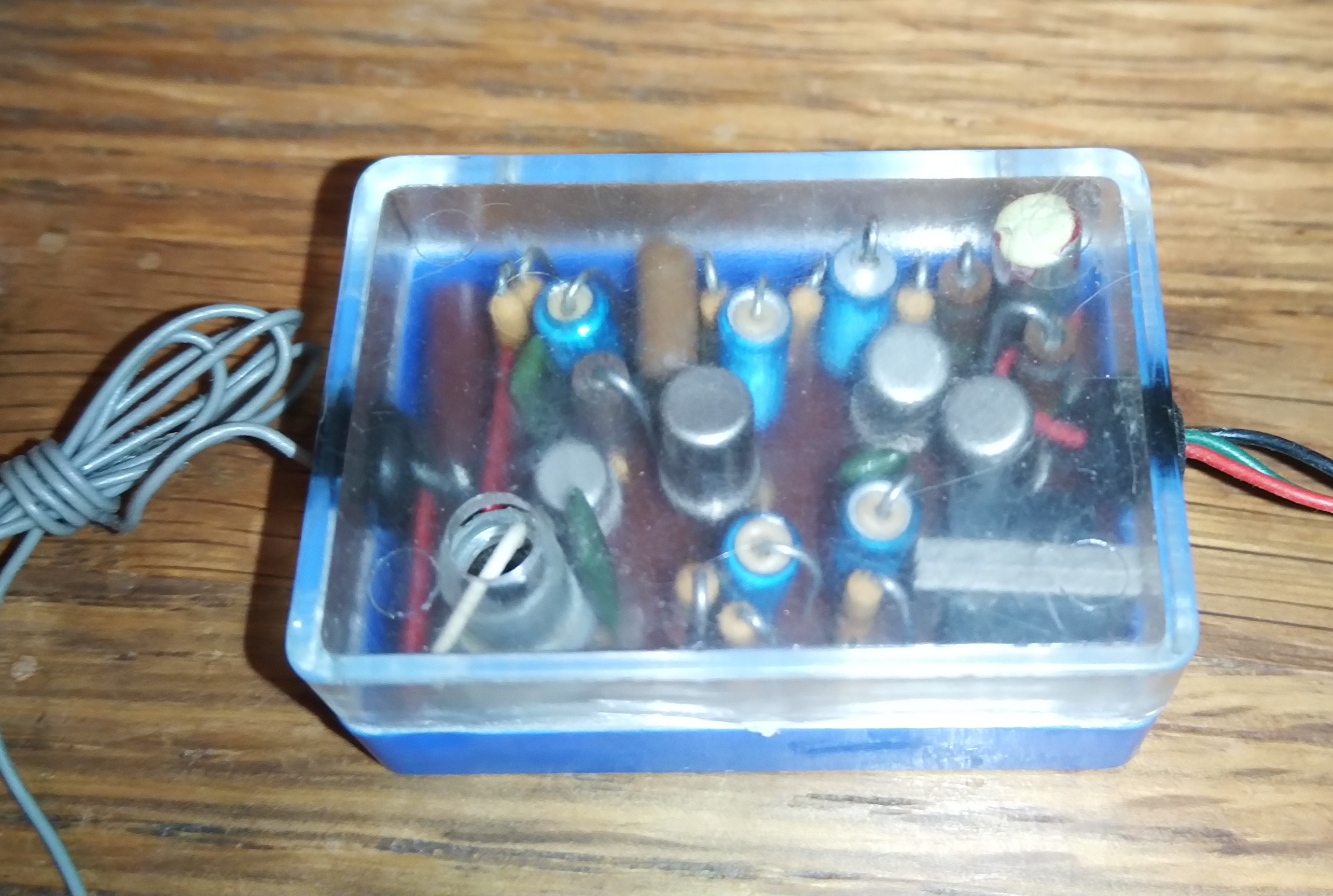

It looks like a MacGregor MiniMac to me. I'll see if I can find mine tomorrow and compare.
IIRC the escapement connects to the battery positive, and the signal lead from the receiver shorts to ground on receipt of a signal.
The MiniMac was also intended to run off 3 cells, so running it on 6V would probably increase the noise output considerably!

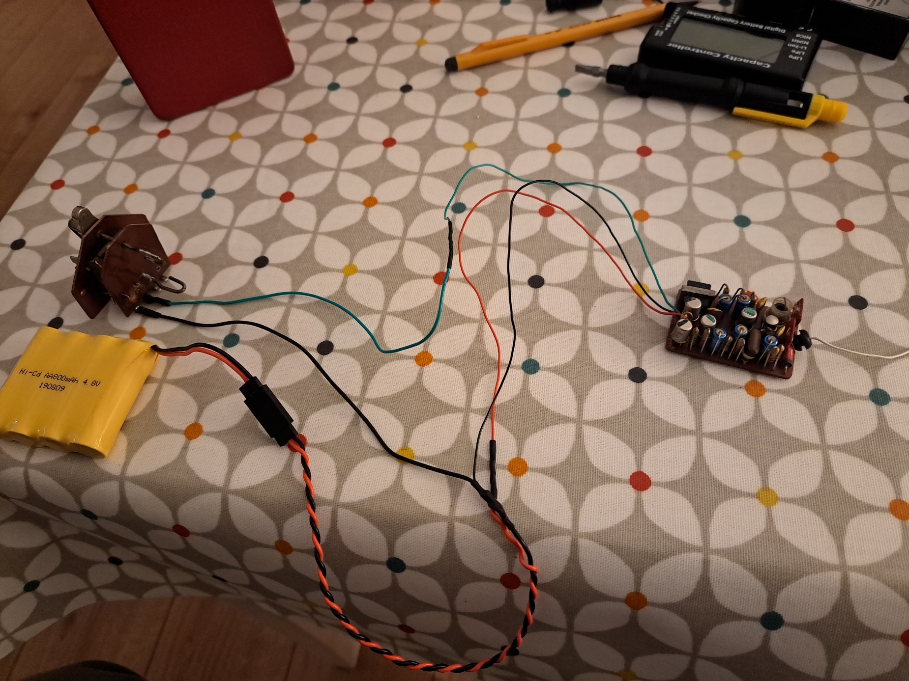

The Elmic Commander instructions say the two wires on the left of the escapement, looking from the rear, should be Rx- and Rx output, so I have it wired on the bench thusly.

I know the 4.8v pack is still higher than recommended, but it doesn't seem to be chattering now, and my Ripmax Pathfinder seems to be getting it to click in and out when I press the tone button.

Hi Pete, defo a Macgregor, I have the identical rx here in front of me.Pchristy wrote: 24 Nov 2022, 19:53 It looks like a MacGregor MiniMac to me. I'll see if I can find mine tomorrow and compare.

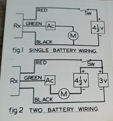

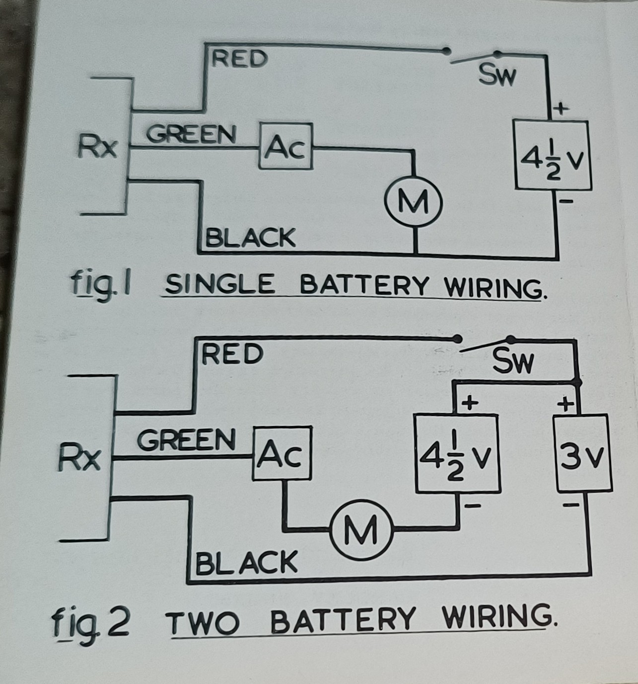

Ah, I was wrong! The escapement does connect between the Rx and -ve.

I've shopped these for perspective as best I can and put them all into a PDF, item M57 on the Archive page of singlechannel.co.uk
They're quite readable so will be ok until theres an opportunity to scan the originals
Weird that the spec page says 3v maximum but the diagram shows 4.5v ???
Edit: as Pete says, probably a typo for 3 cells maximum
