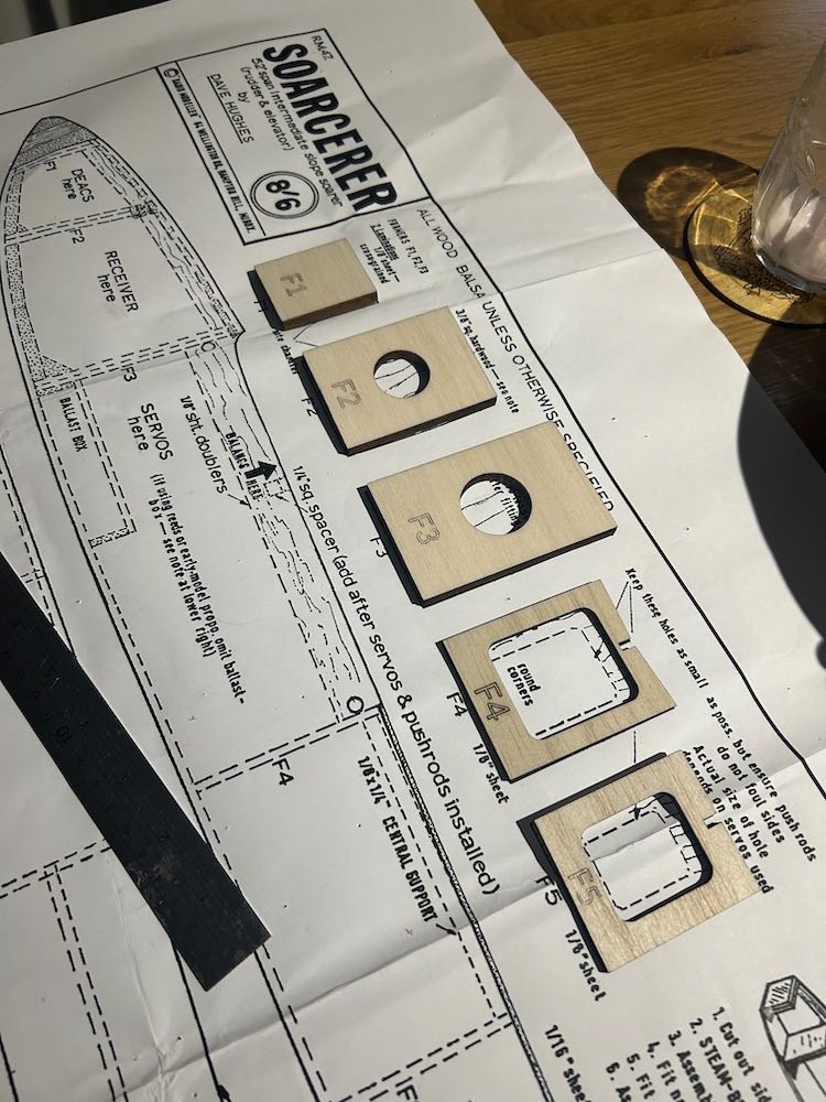

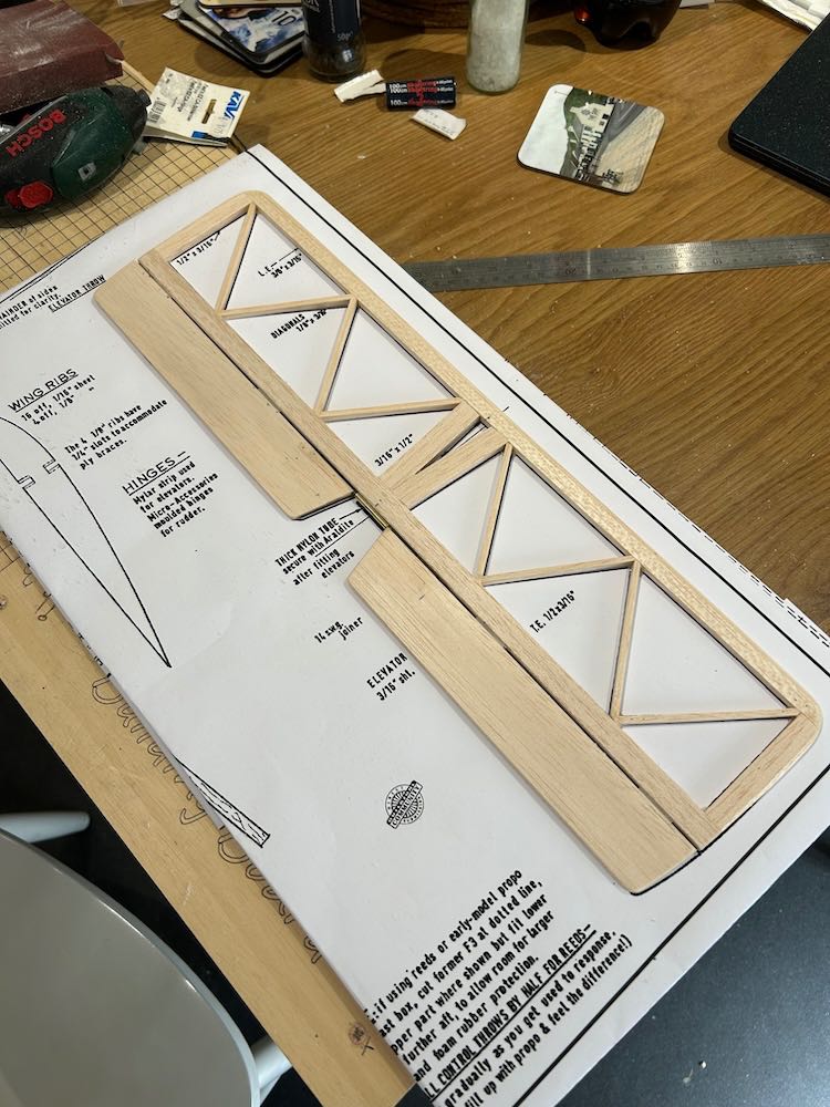

Hi Paul
I’m just in the process of building another 2 channel Soarcerer.
What’s the purpose of the little delve just behind the trailing edge on the fuselage? I see it on the plan but not sure if it’s purpose. I’ve seen a few pics of models without the v shape.
Also did you use a locating dowel on the tailplane to stop it moving and altering the elevator trim? Not sure if it’s a good idea.

Hi Ron,
The Vee in the fuz behind the wing saves it from getting chewed if the wing gets knocked askew on landing..... 'Highly recommended!
No, I didn't use a dowel to locate the tailplane, I made the little plate under the L.E. of the tail a little wider and put a "locating block" in front of the Tailplane....... 'seems quite secure.
