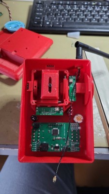

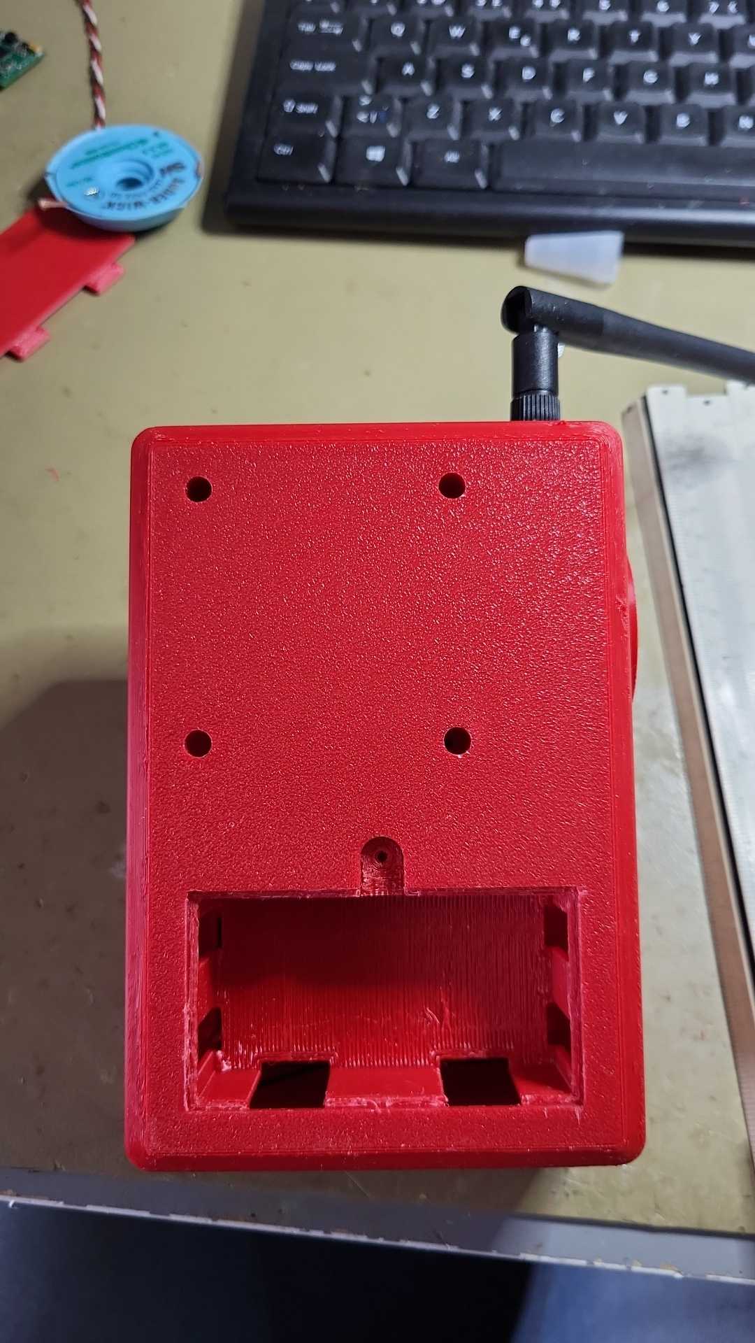

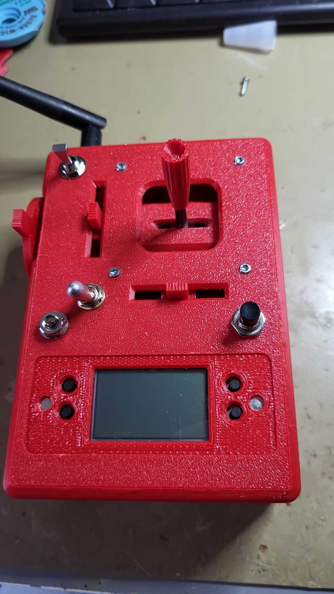

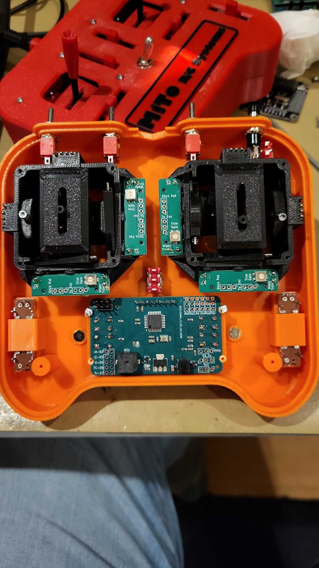

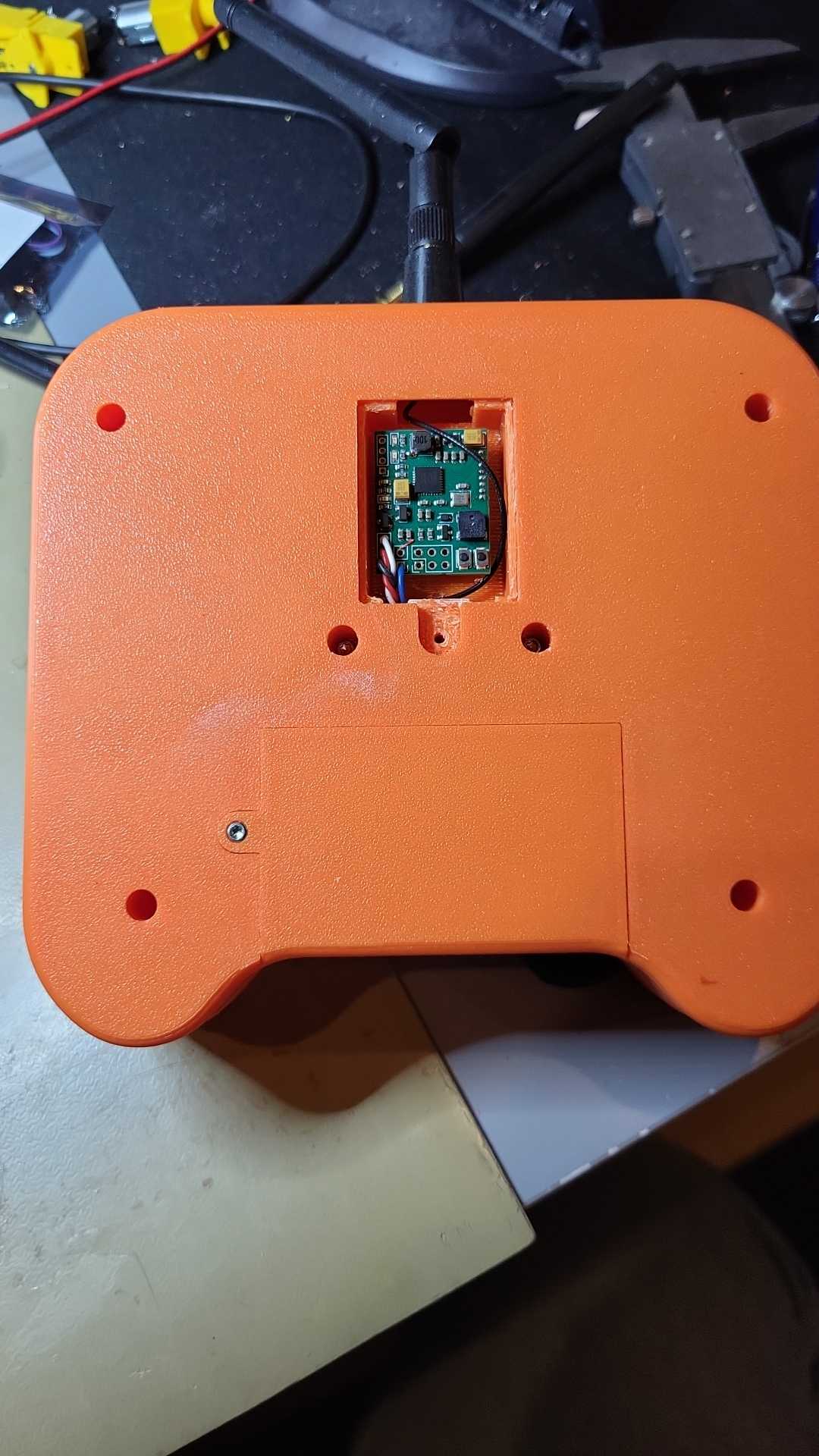

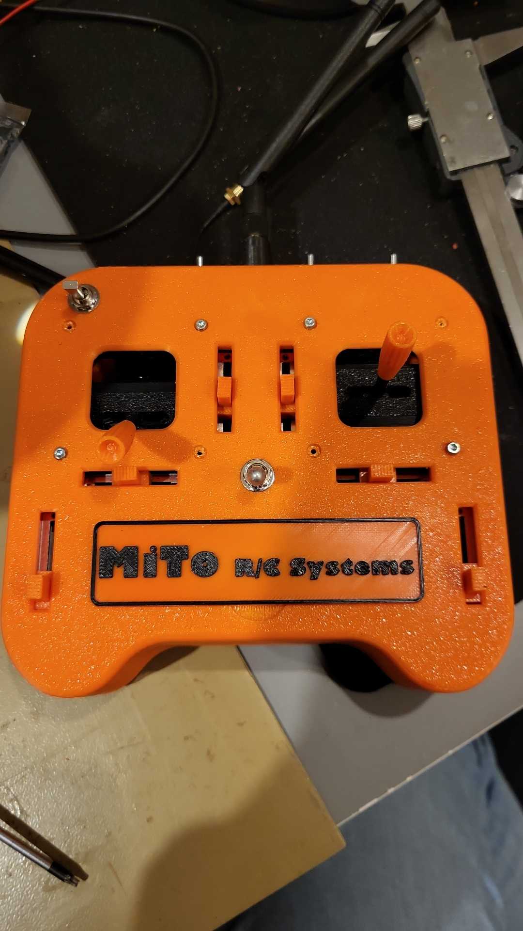

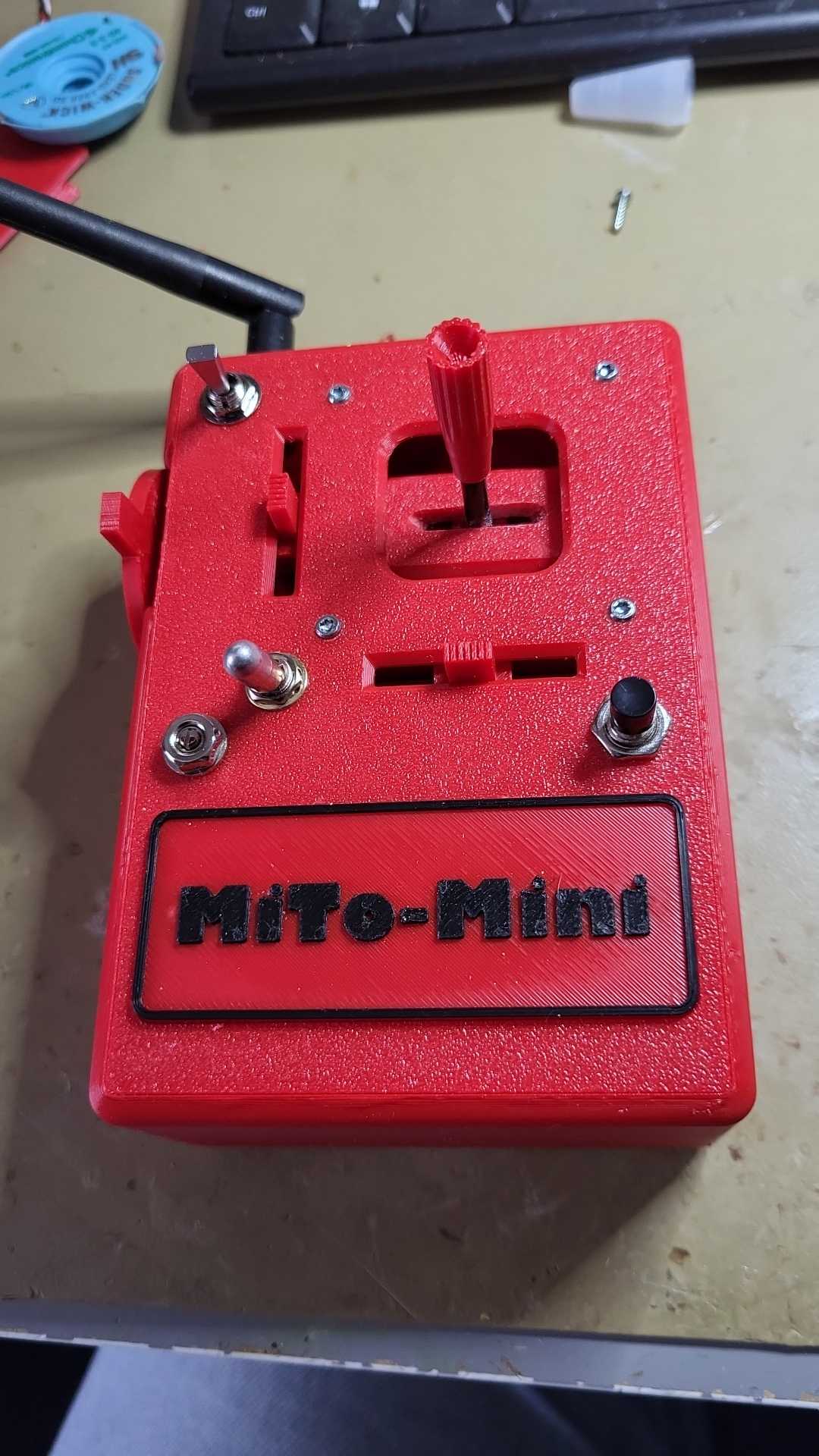

...but of course there is a more Mike&Tobe version!
Here comes the MiTI MKII that match the above RX
....and for those going light there is a mini version:

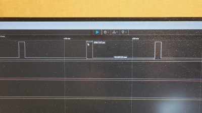

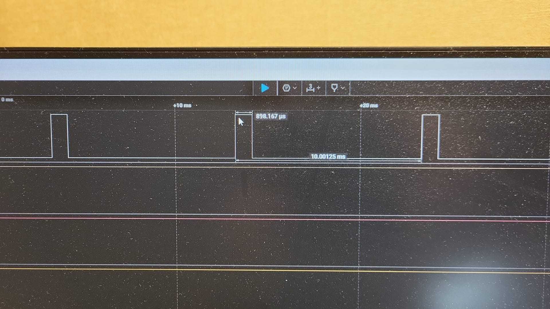

Did some math around my version for nRF24_FHSS, so this is based on my code with the packeting as Mike with failsafe flag for 8 channels:
NRF24L01+ Single Packet Transmission Timing Analysis
1. SPI Communication (Pre-transmission)
SPI Clock: 8MHz
Command bytes to NRF24: ~10 bytes
Time per byte: 1µs
Command transmission: 10µs
Mode switching delays: 90µs
Total SPI Setup: 100µs
2. NRF24 Internal Processing
TX FIFO loading via SPI: 50µs
Packet Assembly:
Preamble (1 byte): 32µs
Address (4 bytes): 20µs
Control field: 10µs
TX settle time: 40µs
Total Internal Processing: 150µs
3. RF Transmission
Payload: 17 bytes = 136 bits
Data rate: 250kbps
Calculation: 136/250,000 = 0.544ms
Total RF Time: 544µs
4. Post-transmission Processing
Status register read: 10µs
Flag clearing: 10µs
Mode switching: 80µs
Total Cleanup: 100µs
Total Theoretical Minimum Time
CopyPre-transmission: 100µs
Internal Process: 150µs
RF Transmission: 544µs
Post-transmission: 100µs
Total: 894µs (0.894ms)
The total theoretical minimum time for a single packet transmission is 0.894ms under ideal conditions, not accounting for any environmental interference or retries.
