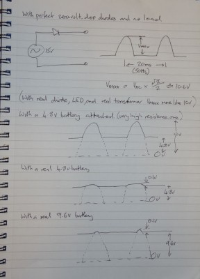

After a quick look at the PCB, it seems to me that the circuit just consists of 6 identical half-wave rectifiers. Three of the rectifiers: Rx1, Rx3, Tx1 work on one half wave and the other three: Rx2, Rx4, Tx2 work on the other. Each of the rectifier circuits consists just of a diode, a resistance, and an LED. There is a switch that switches different resistors into the resistance and so varies the charging current.
What surprises me - and perhaps I've missed something - is that the 'transmitter' 9.6V rectifiers are identical (save having different resistances) to the 4.8V 'receiver' rectifiers. Both types are just half-wave rectifying the AC voltage coming from a 15V transformer wiring. So you could charge a transmitter battery from one of the receiver connectors and it would still charge up fully - just taking a bit longer because of the higher resistance.
In terms of the charging current, it's a pulse-charger. The pulses come every 20 milliseconds and last for rather less than 50% of the whole cycle (just how much less depends on how much higher the peak voltage of the unloaded AC is, compared to the voltage of the battery on charge). If I'm right about the same circuit and transformer winding being used for both receiver and transmitter batteries, then the transmitter batteries will be charged with shorter pulses, occupying a smaller fraction of the total time, than the receiver batteries.

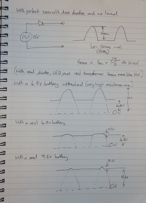

Posts: 782
Re: RCMW DIY Multi Output Charger
Yes, still 20 ms pulse spacing, but the charge current only flows when the half-wave voltage exceeds the battery voltage. With a 4.8V battery on charge this will be perhaps 25% of the whole cycle time, but with a 9.6V battery on charge it will only be about 10% of the whole cycle time because only the topmost part of each peak is higher than the battery voltage.
I've scribbled and photographed something as it's difficult to explain just with words but no pictures.

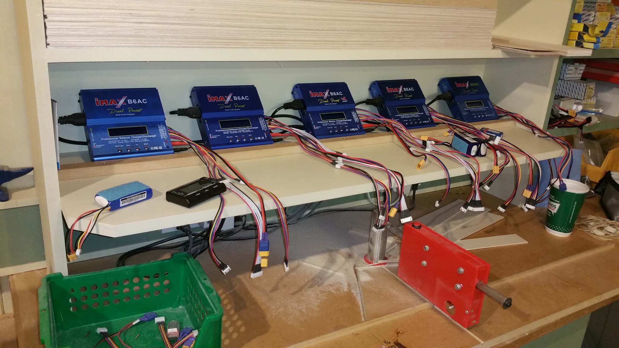

Mike_K wrote: 11 Sep 2018, 11:17 But why not invest in a modern charger? They nearly all use PWM for current control, so you still get you pulsed charging, albeit at a higher frequency. You can still slow charge if you want or if in a hurry do a quick charge. Better still you can occasionally do a full discharge - charge cycle to see their true capacity which is a good indication if they're still up to the job. And they're not much more expensive to buy than building your own geriatric charger© (I think I should Copyright that name :D )
You mean like this lot on my charging station :lol:
These el cheapo 4 button chargers have sufficed for a number of years - built in PSU's too - or DC 12v. The main thing is that they're separate and NOT a multi charger which is one down all down :?
I also have 2 ISDT Q6 lite chargers for other odd jobs and a few DIY pulse chargers I made some years ago plus there's at least one old astroflight 110D in the garage that charges some odd things too - and of course, my Geriatric Charger (tm) for my slopers :D

Post by Igull »
Martin wrote: 10 Sep 2018, 22:07 Yes, still 20 ms pulse spacing, but the charge current only flows when the half-wave voltage exceeds the battery voltage. With a 4.8V battery on charge this will be perhaps 25% of the whole cycle time, but with a 9.6V battery on charge it will only be about 10% of the whole cycle time because only the topmost part of each peak is higher than the battery voltage.
Yep, that all looks about right :lol:
I think the 'shorter pulses' you mentioned were really ones of lower amplitude rather than shorter period :)
