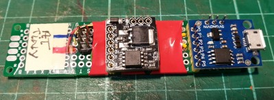

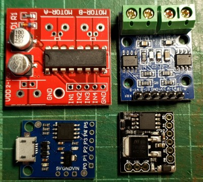

I managed to 'borrow' a few hours during the week to do some experiments with the DIY sketch and 2 different ATtiny85 boards and 2 cheap H-Bridge boards off the Bay. These are the boards:
The 2 x H-Bridge boards at the top, the 2 x ATtiny85 boards at the bottom.
One ATtiny board is the DigiSpark with the USB tab removed (as per Phil's post) & the other is a slightly different configuration with a micro-USB socket fitted. I had an oops moment when sawing off the USB tab - the saw slipped & knicked the board cutting a track but fortunately I was able to repair it.
Note that the spacing between the power pins & the P0-P5 pins is different between these 2 boards - this prompted me to modify my ATtiny85 ICSP programming board to accommodate both types, thus:
Both boards are fitted in this view for demonstration, but only one board at a time is fitted when programming.
The two H-Bridge boards have similar specs, the blue board is smaller & costs a few more cents, but neither is expensive! The physical configuration is different and the labeling is subtly different too, as evident in the pictures.

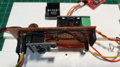

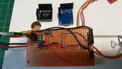

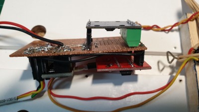

For my experiments, I made up a board with sockets & pin headers, so all 4 boards could be easily inserted/removed to test all combinations.
The ATtiny boards had sockets fitted so that I could plug them onto my ICSP programming board if code changes were needed.
the double vertical row of black 5xPin headers is to accommodate the different hole spacing on the 2 x ATtiny boards tested.
Once I found the one (of course :x ) bridged solder joint (suitably & colourfully cursed, of course :roll: ) all worked as it should, on 3 different motor+g/box combinations.

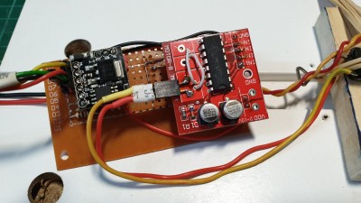

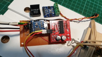

DigiSpark board fitted. Red H-Bridge plugs onto top of my test board
blue board fitted
blue board fitted
blue H-Bridge plugs onto bottom of board
Red H-Bridge plugs onto top of my test board while blue H-Bridge plugs onto bottom of board.<br />Only one H-Bridge is fitted at a time for operation/testing.
