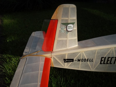

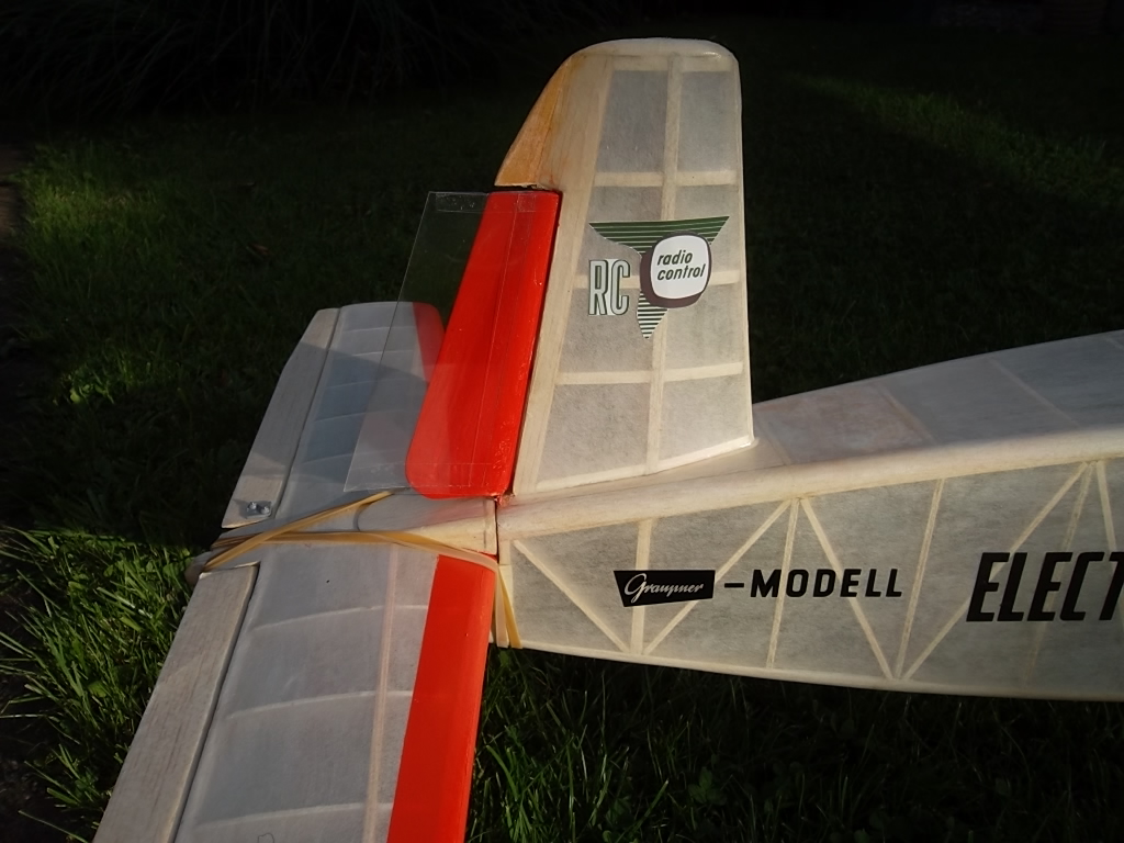

The forward fin location is the reason for sure, and an additional subfin will impove things also. But it is a classic model, one of the first kitted R/C models here in Germany and I will fly it as close to its original appearance as possible. Therefore I will not add a subfin or move the rudder further back.
I increased the rudder area with a transparent plastic part which is almost invisible in flight or from a short distance but works a treat. As you can see in the picture you have to look very closely to see it.
The model flies quite nicely now and I am pleased with its behavior. Frank

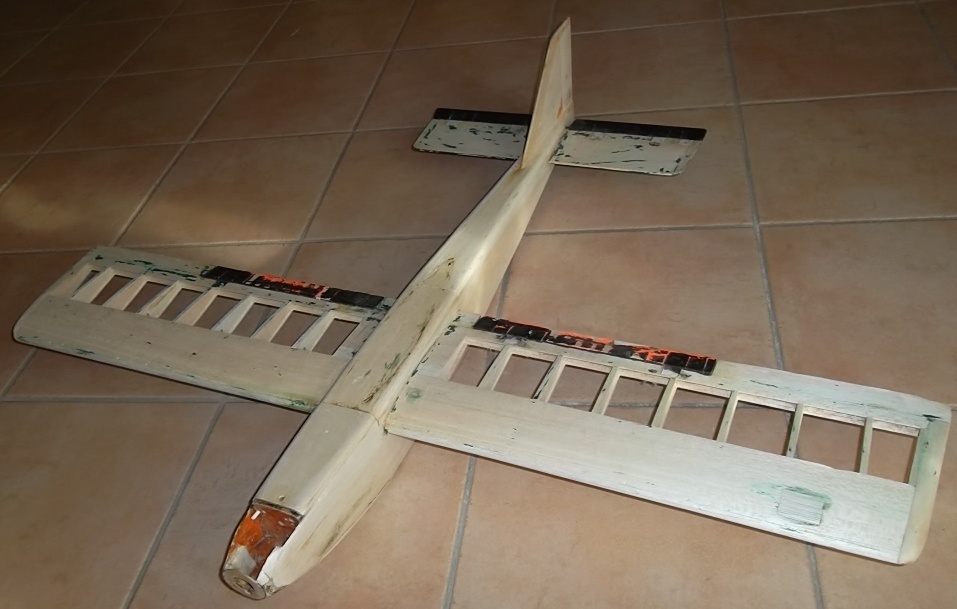

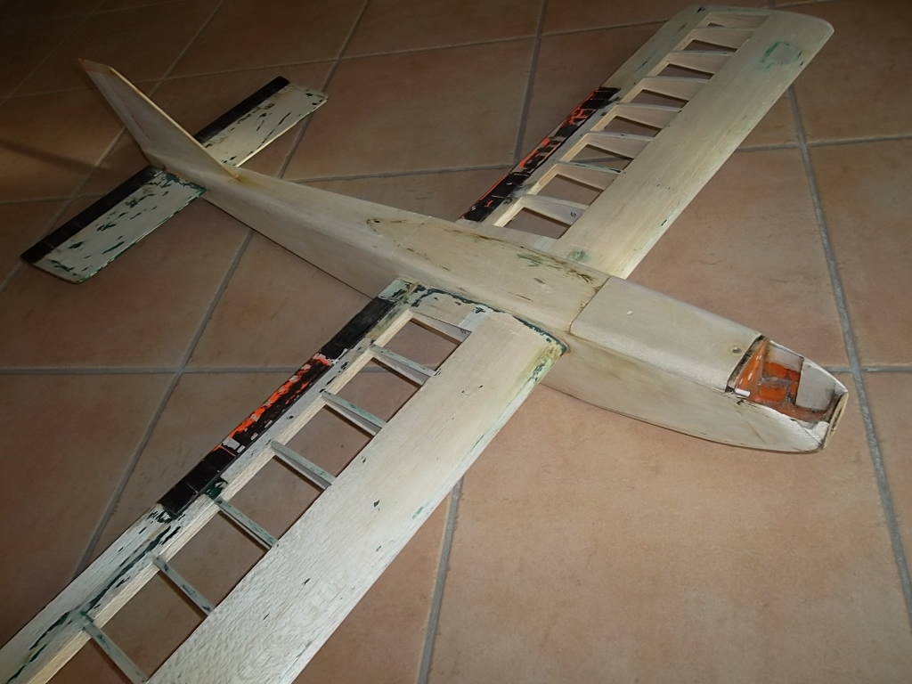

A new restauration had started.
I got the model some time ago in very bad shape and rescued it from the garbage bin.
Most of the woodwork , mostly repair, is already done, a little more sanding, covering and painting and it will be ready to go.
Power will be a HB15 IC engine and three servos, aileron, elevator and throttle.
The plane is called Chico, a Graupner model from 1979, it´s no old-timer but it qualifies as a vintage model. More pictures maybe next week.

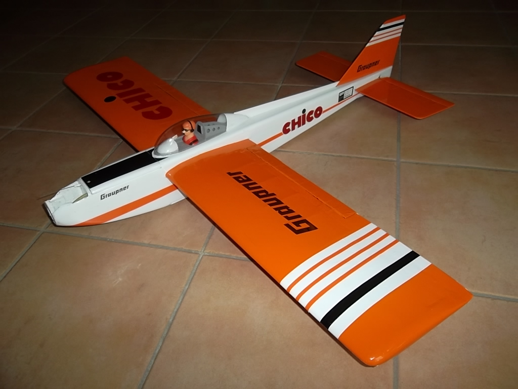

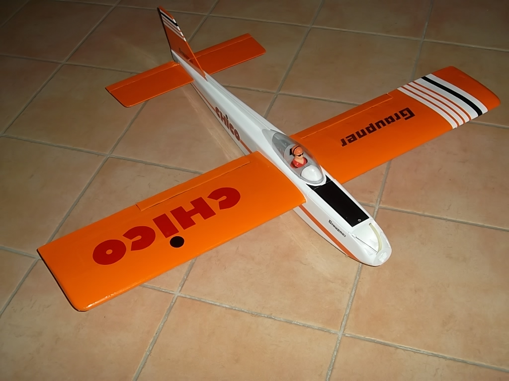

The Graupner Chico is almost ready.
Only the engine is missing. RC equipment and tank are installed.
Due to our complete lockdown, the maiden flight will be in February at the earliest, all our flying fields are closed UFN.
That will give me plenty of time for furhter projects. Frank

Lovely job, as always, Frank! Did you 3D-print the cockpit tray and pilot's headrest?
- Posts: 406
Re: New mystery model
Thanks Martin,
no, they are made of Balsa. That is faster than 3D-print.
