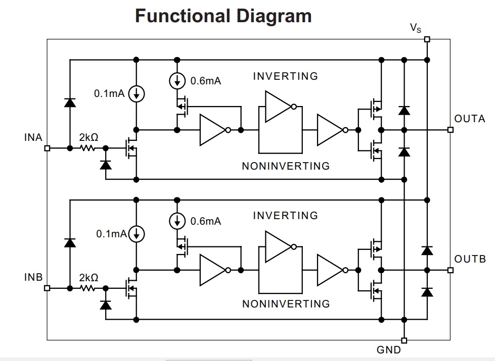

When looking at the internals of the MIC 4427, there is a (clamping) diode at the input, preventing the first FET's gate voltage rising any higher than Vs + ~o.6 volt.
Without any external supply, the input will supply the entire circuit with Vs = Vin - ~o.6 volt, estimate ~4 volt.
This, apparently is also enough to power the output stage, hence your LED lights up.

I can see it now. Thanks Bruno, I will sleep again tonight.....
Edit: I did lose some sleep last night trying to work out what will happen when I connect a low impedance load, like the Picco. Will it draw too much curent from the Arduino port and destroy it? I could not work it out, so I decided to install a 1K resistor between the two chips to curb the current just in case.
