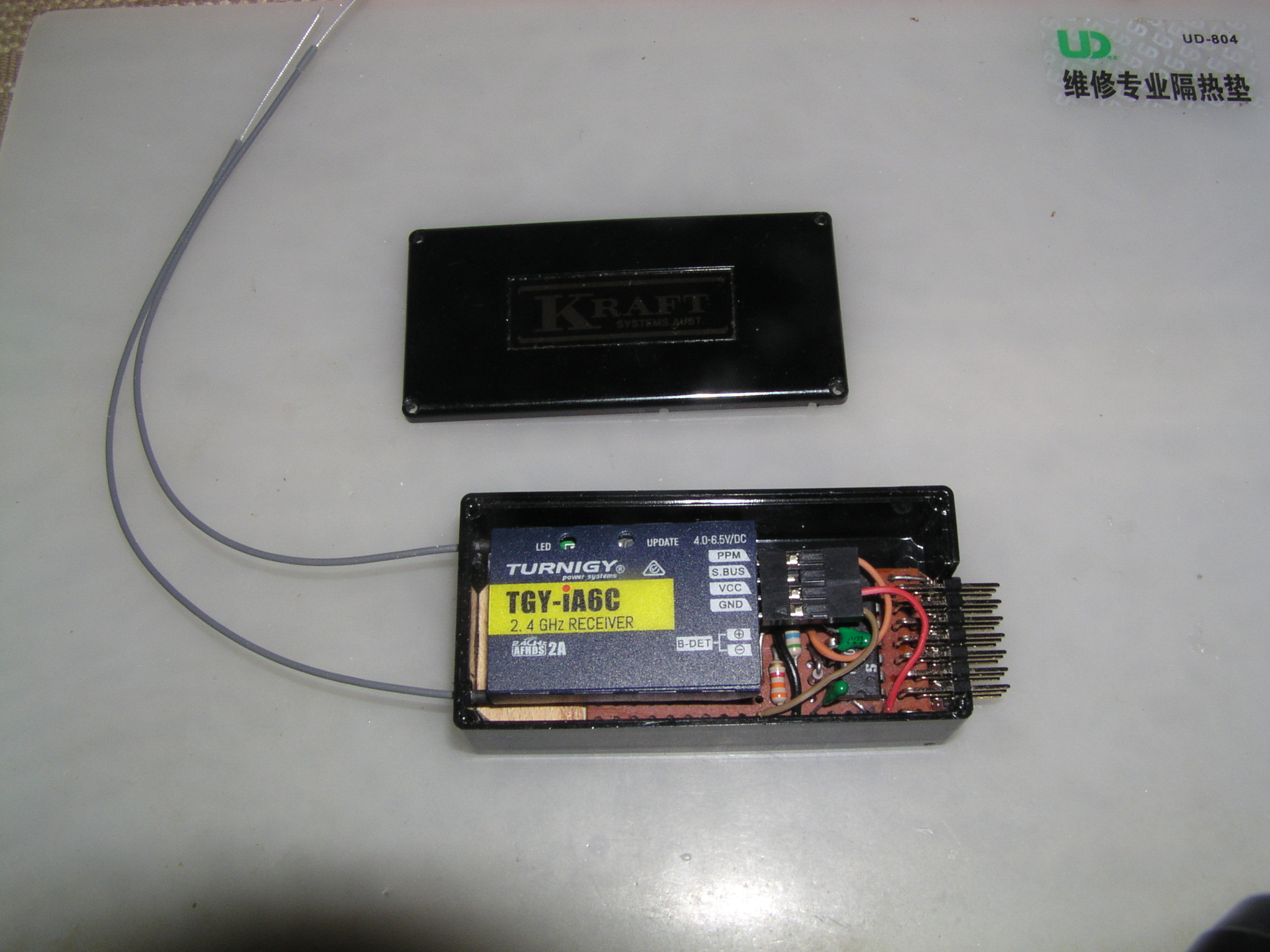

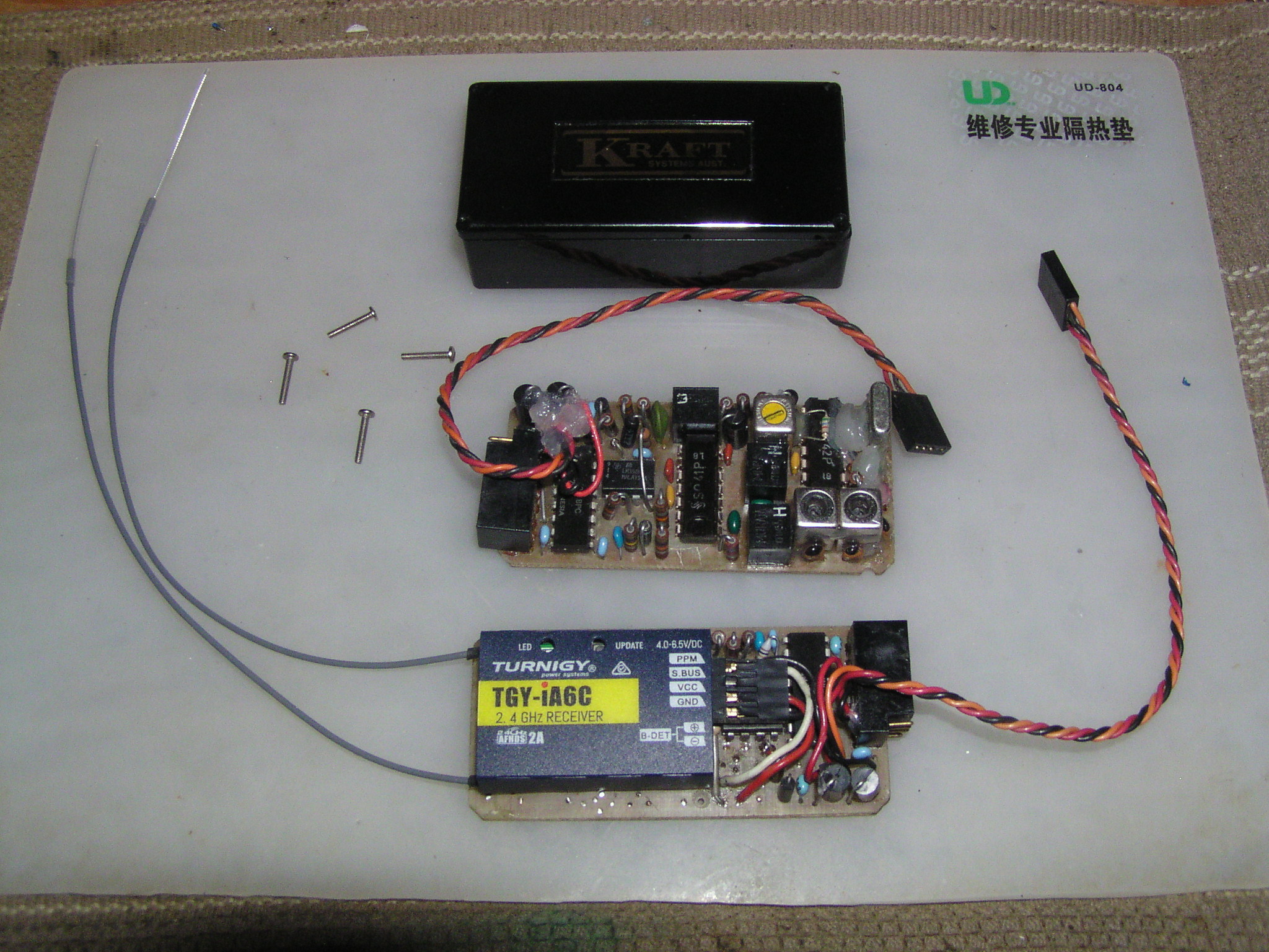

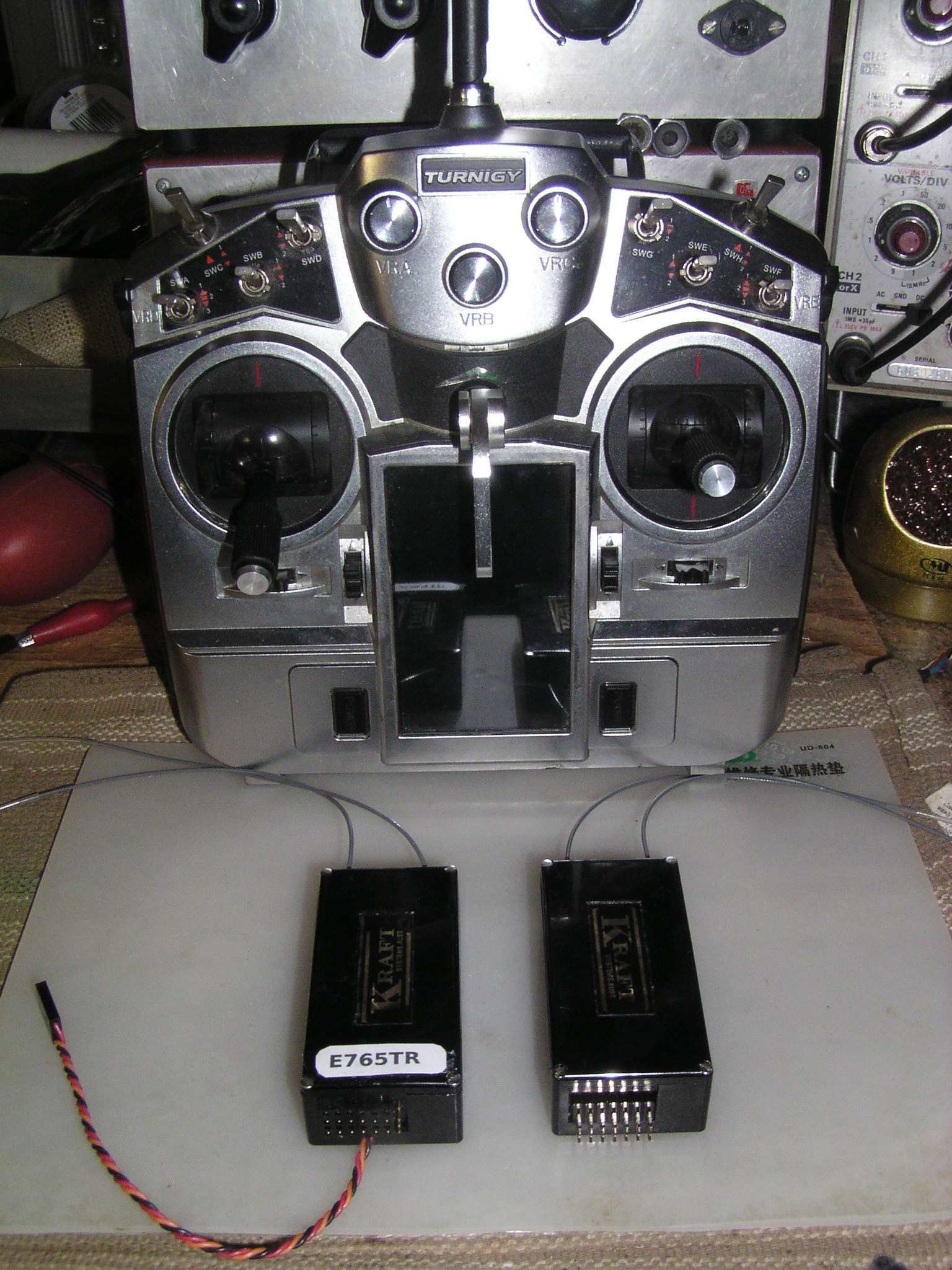

I agree, in fact I have just built a 5045 powered PPM decoder to make use of a TGY-1A6C receiver I was given by a club mate, (actually 3 of them, he had "goofed-up" an order and didn't get what he really wanted), and as dedicated recycler (and hoarder), I can't bear to throw anything out.
So I have a few old Kraft 7FM receivers laying around from the 1970's, when we were flight-testing FM stuff down here in OZ for KSI. We, (KSA) could use FM modulation here before it become legal in the US, and we also had a permit to use 35 and 72MHz for limited testing purposes.
My first thought was to sweep all the 72MHz RF components off the 7FM boards and re-jig the decoder to accept the negative CPPM pulse input. This worked quite well, but removing the unwanted components. entailed a fair bit of work. I was about to start on the other Rx when I remembered I had some 4045 chips somewhere in the spares bins.
A little scrap of Veroboard, a few components, a bit of solder, and another PPM encoder is born, also in a 7FM Rx case. The 5045 input can be set up for either P or N pulse streams, and I have 2 "New" receivers for my TGY-i10 Tx. (Not all my transmitters have a Gold Case)...

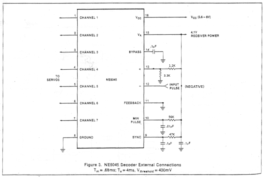

The 5045 sync pause can be adjusted if necessary, but my i10-iA6C combo runs a 20ms frame, and I seldom use more than 5 channels anyway. I built a test circuit with 50K pots in place of R9 and R10, to optimise values to the nearest std. value, and the V/D pair at pin 13 can make fine adjustments to the comparator switch point.
All the complex noise reduction circuitry can be removed when using CPPM input, its' already been taken care of by the 2.4GHz radio system.
