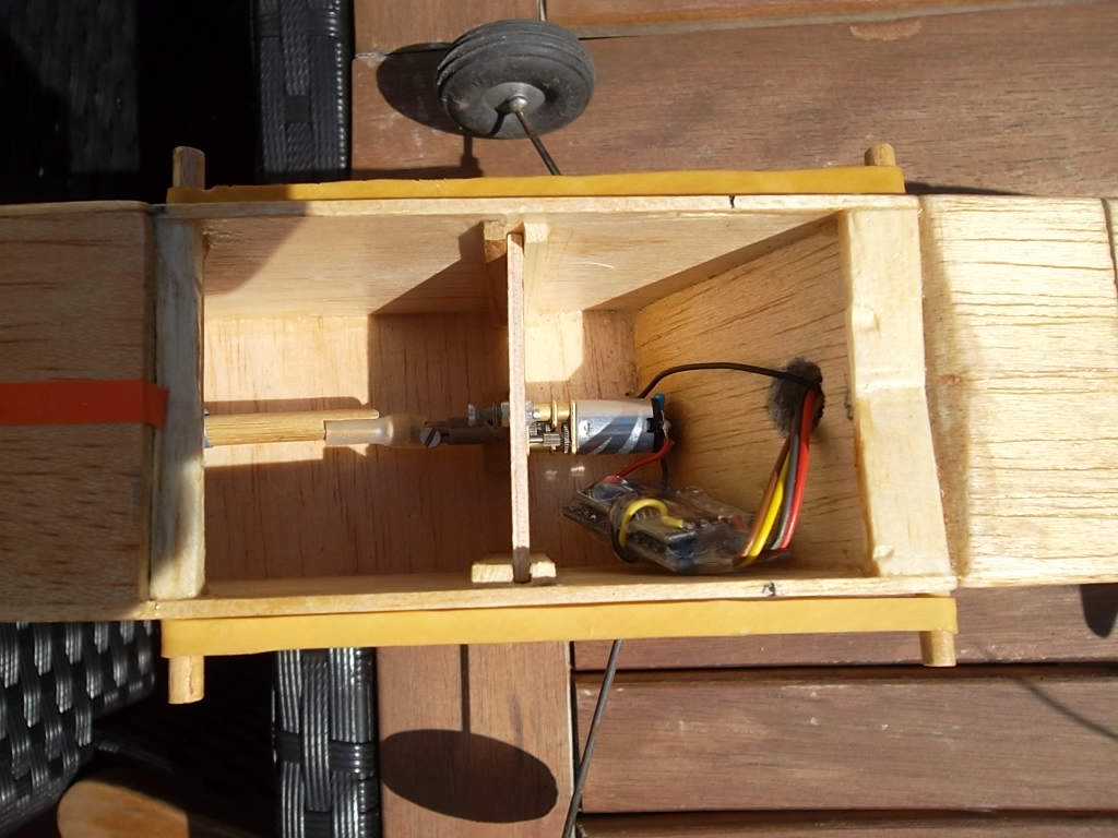

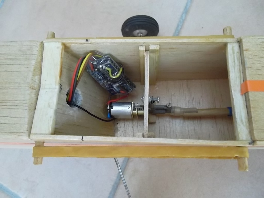

This morning I tested my new GG pulser. It is installed in the Blunderbird, just to test it out. I had two great 10 minute flights without any problem. Good control and it does not even get warm although we had 32° in the shadow and the bird had to fly in the sun. It was well worth to build and test it.
Meanwhile I have finished three sets, one for rudder only, one for rudder-elevator and one with full setup. All are working great.

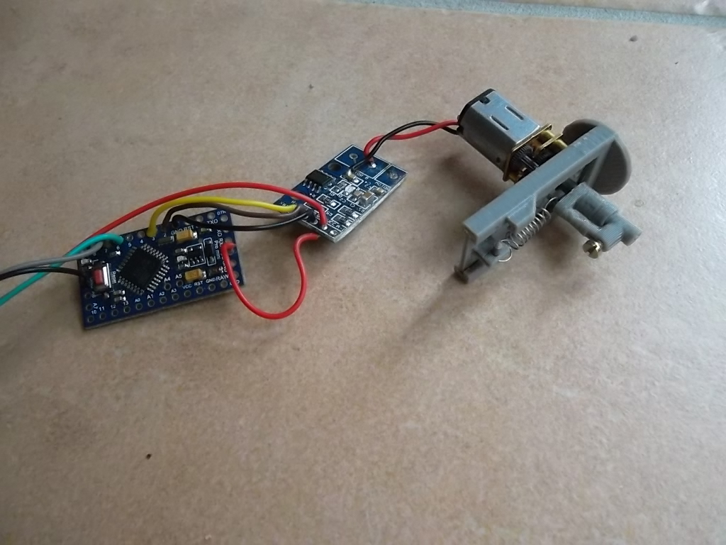

I updated the Arduino sketch attached to the post on the first page (pulser.zip). You probably don't want to alter yours Frank if it's already working, but I modified it a bit to suit the latest batch of pulsers I've built. These have the fast motor/gearbox that is happy to work from 5V, so I dispensed with the 'power' wiring and they just operate from the normal receiver (usually BEC) 5V supply to keep the wiring simple. I also altered the sketch so that it auto-detects whether or not the Elevator and Auxiliary channel signals are present and runs without either/both of them if they're not there. So in the simplest installation you only have to plug one 'servo connector' into your receiver rudder channel to fly.
I tweaked the default timing signals to suit 5V operation and the new motors, so again if you already have a working system don't update it or you'll have to retune your rudder/elevator/auxiliary end points on your transmitter.

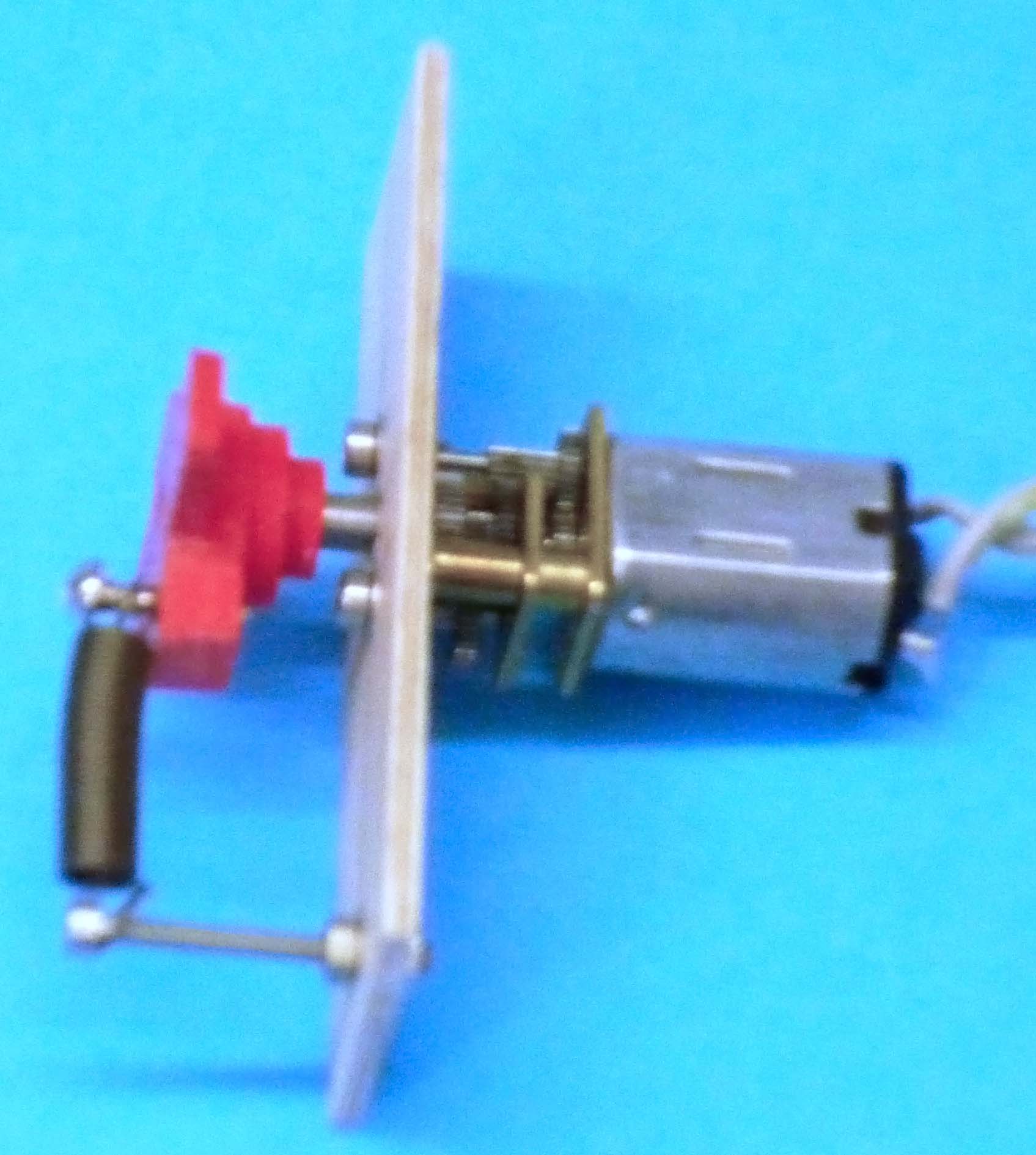

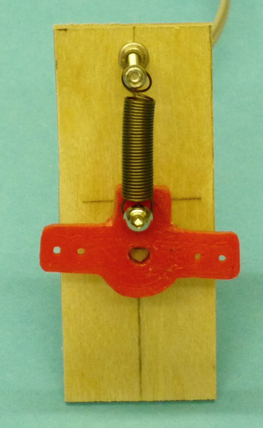

Being an inveterate fiddler and happening to have a couple of the same motor/gearboxes doing nothing, I starting wondering if there might be another way to take an output to a rotating torque rod driving the birdcage at the model's back end. There is. This is how I did it. Took all of half an hour!
To begin at the beginning, a while ago Tobe (hiya Tobe!) kindly sent me a bunch of spares so I could repair one of his excellent GG actuators that had gone sick. Being the generous man he is, he also actually included enough parts to build an Adams actuators from scratch! The point is, this appears to use the same gearbox as Martin's set-up. If the motor is the same for all the available ratio variants, it must be.
On Tobe's Adams actuator the rudder drive plate sits directly on the gearbox's output shaft, secured by a) a very snug fit and b) the D-shaped moulded hole that matches the "flat" ground onto the output shaft.
It took just minutes to carve a spare rudder plate into a "T" with a short vertical extension, with a self-tapping screw providing the anchor for a centering spring (I could have just used it "as is"). One scrap of 1.5mm ply, a few M1.6 machine screws and a medium-strength spring later the job was done.
Fired up with Martin's Arduino/H-Bridge driver, it seems to work a treat. The idea is that the torque rod would have a pitchfork-type wire extension to engage in the output adaptor's holes.
Apologies for the quality of the attached photos, but they show how this simple alternative looks.
