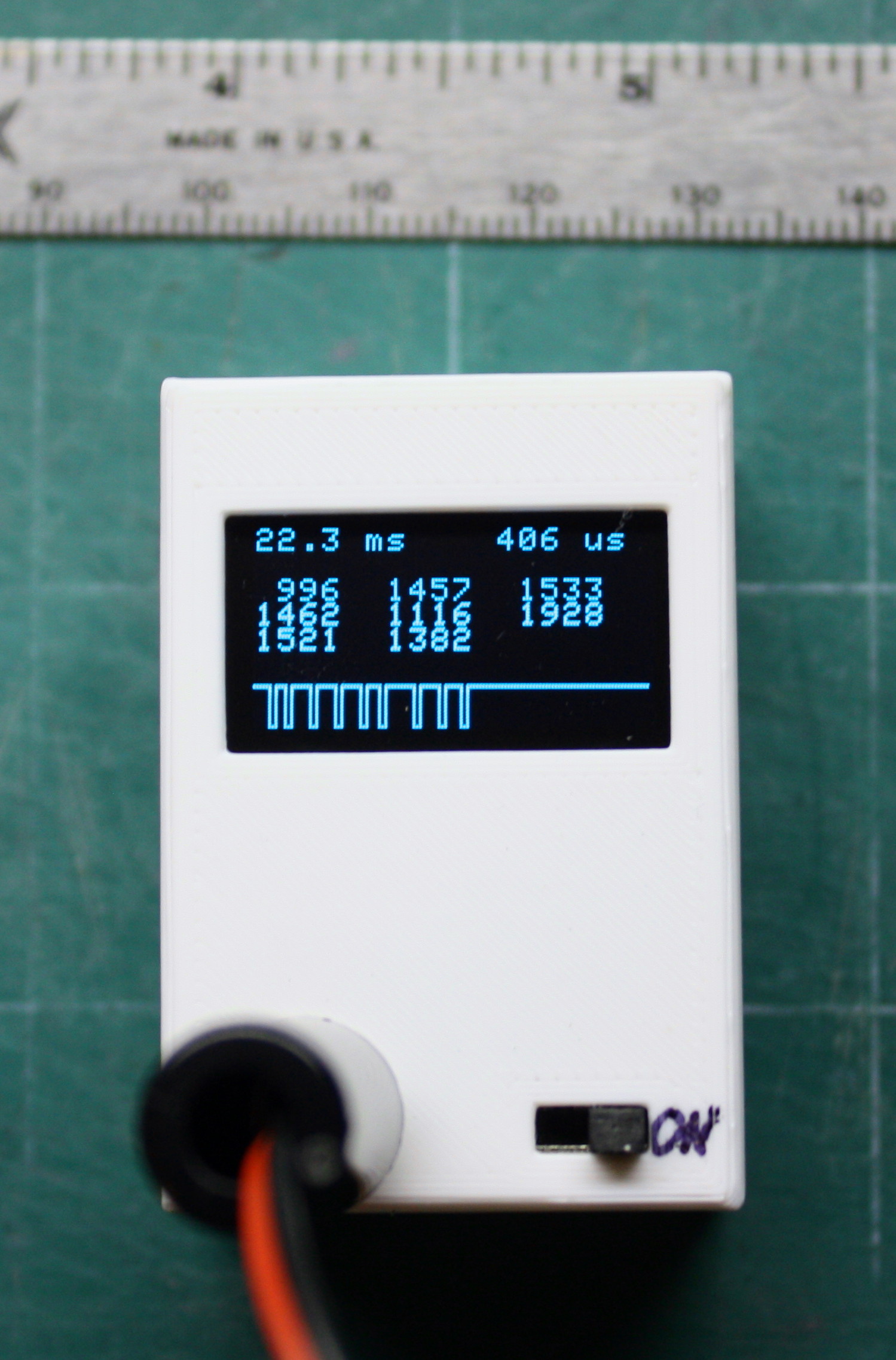

I'm quite pleased with my PPM Meter. It seems to be working exactly as expected. Without your help and information I never would have finished it, so thanks very much! My 150 mah LiPo battery was too big to fit into your case, so I drew up a modified version using DesignSpark, the only 3D CAD I know how to use. My case is narrower (to fit my display) and deeper.
Where in the circuit did you put your switch? I decided to put my switch in the + battery lead, thinking that it is good to get the power off the battery management board when not in use. However, this means to charge the battery, the switch must be on, and I'm wondering if that will cause any issues with the Digispark and display.
