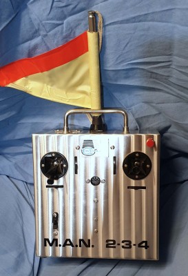

Finally got the MAN 2-3-4 Tx finished
I couldn't get the old Corona tx module working back when, so temporarily shelved the tx conversion. Then COVID hit (which meant I couldn't travel to NZ as I had been for my work on the road project which was financing construction of our airfield retirement dream) so we (my very understanding wife & I) moved into a small caravan parked inside the hangar to cut costs & save dead money on rent. We've been surrounded by storage boxes & house building supplies ever since. Thankfully, the van is now gone, as most of the mezzanine has been converted to laundry, bathroom, kitchen, office (for teleworking) & bedroom.
Whoops, got a bit off point there
Anyway, I rediscovered the MAN 2-3-4 in a box I was unpacking, along with a heap of Frsky gear & thought why not. I downed construction tools & took some time off and here is the result.
- Finished M.A.N. 2-3-4

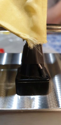

I dropped a Frsky DHT (diy) module in to replace the kaput Corona, wired the DHT and the 29Mhz AM rf board through a selector switch (the blue s/w in the picture) and secured the loose wiring. The bind board & telemetry s/w are both left inside the case. The UHF antenna is hidden in the pennant, Paul's idea that I shamelessly nicked
- Antenna base showing telescopic antenna mount and 2.4Ghz wire to antenna hidden in bottom of Tx pennant

Beautiful job! I am curious about the UHF range. Does the VHF metal antenna act as a shield and limit the UHF transmission range?
Thanks,
John H.
Re: Shiny Boxes aka Controlaire Tx's
Posted: 16 Nov 2020, 10:11
by Wayne_H
JohnH wrote: 15 Nov 2020, 15:52
....... Does the VHF metal antenna act as a shield and limit the UHF transmission range?
Thanks, John H.
John, I did a quick (ground) range test this afternoon and got a comfortable 900m. I had the Rx & servos while my wife had the Tx while we spoke on the mobile phone. At 900m I got her to turn around, wave the Tx about, point it towards me, etc and the link was solid. While I haven't flown it yet, based on the ground test, I'm more than happy to use it 'in anger'
