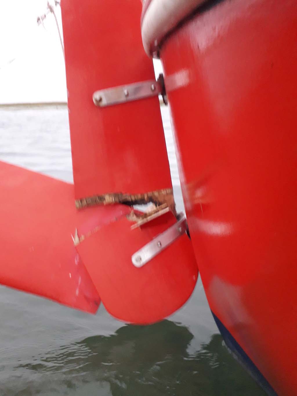

We were reaching just under 2 nm north of the Nab Tower hoping to round it before we ran out of time to get back before dark when a loud 'CRACK' was heard. Wind was E top of F4 with gusts into lower F5. One reef in main and none in mizzen.
We looked around but nothing was obvious....hmmmmm...peered over the stern to discover the rudder sitting at 45 degrees out to the side of where it normally lives! Oh poo I said (or something similar). Couldn't get her to tack so ended up gybing and sailed back,using hand flown sheets to control direction tolerably well until needed more precision as we neared Chichester Hbr entrance, when the outboard was started. Spent the next morning tying he bits together ready for the lift out next week.
Looks like rot in the rudder stock cheeks is to blame but absolutely nothing to be seen on the outside at all. Just the inner laminations that have sucked up the water.
I now know what will be on my building board in December!

Many moons ago I went out with a rather keen skipper who decided we would pretend that we had lost steering and we would practice sailing without using the rudder. It was a 42ft bermudan sloop (Bavaria) in about a F3 and a virtually calm Solent. We tried dragging buckets, sail trim, shifting ballast....... nothing made much difference! I vowed that when I had my own boat I would NEVER lose the rudder! So the current boat is a long keeler with a full length, transom hung rudder supported by FIVE pintles and tiller steering...... and I carry a spare tiller just in case!

Correct, the mizzen was the principle steering aid. Also helped by the fact that a Libby has almost no rudder loads when sailed normally, it only loads when you try to get the last knot of speed.
