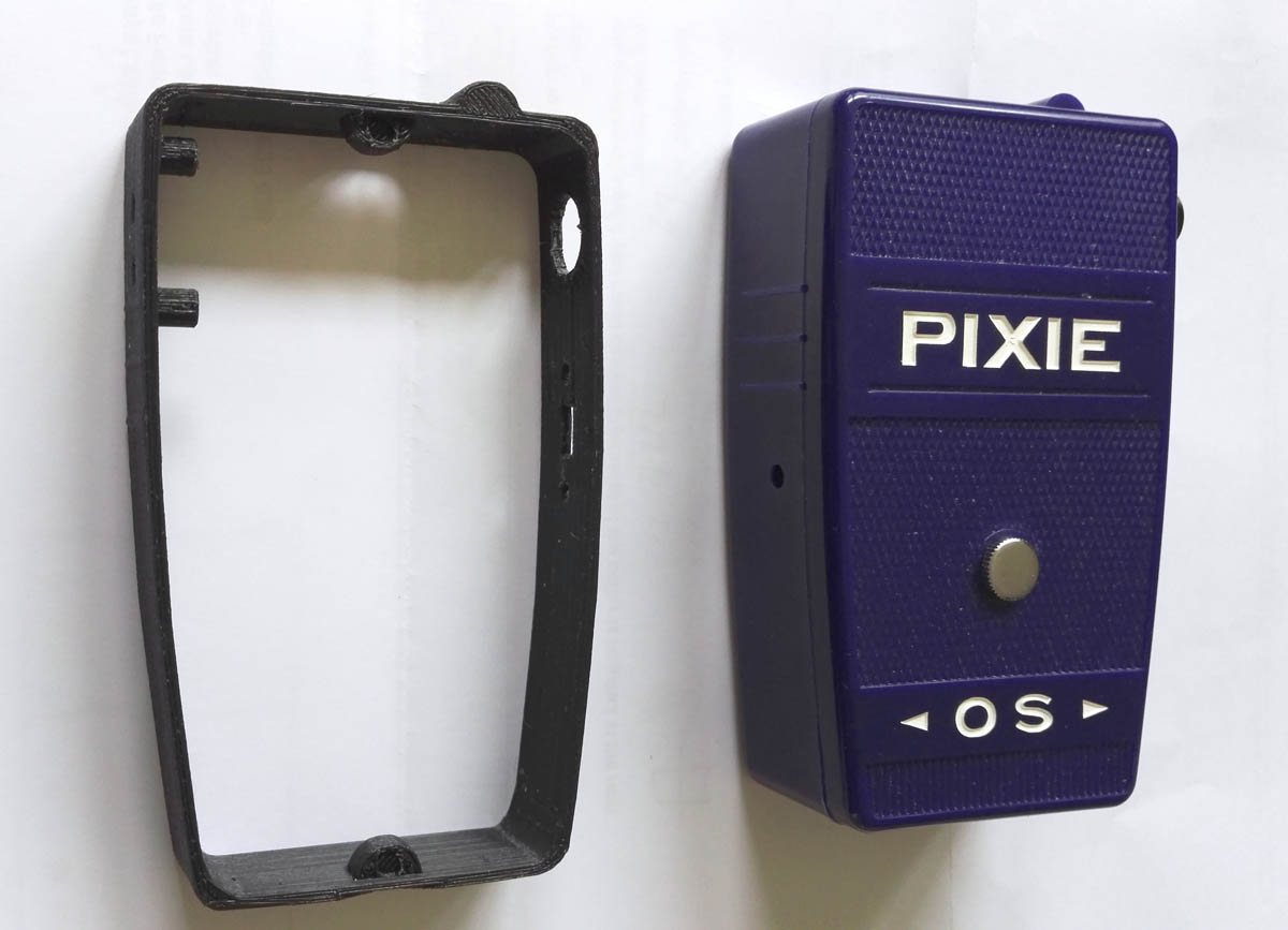

My latest single channel transmitter project, an OS Pixie MK2 has progressed a bit. I have designed it in three parts, a base, the main body and a lid to be held on by magnets. I was away all weekend but left two 3D printers running while I was away. The base finished up as a "ball of spaghetti", but the main body came out OK. I've had a dry fit and all the components fit OK, though the 2.4 antenna hole may need moving slightly and the power switch is very close to the microswitch, I'll probably have to bend the lugs a bit and heat shrink them. I'll set the printers going again this evening to have another try at the base and the lid.
