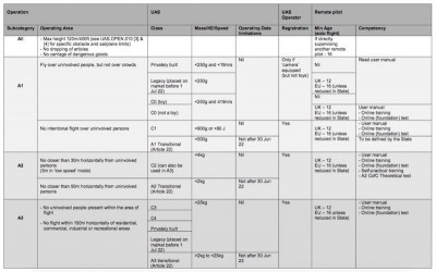

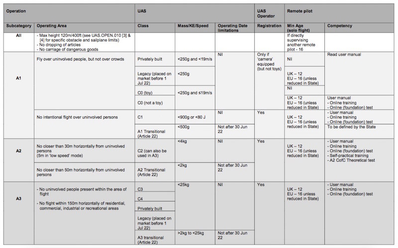

As we seem to have lost all the posts from the previous post up to 27/7 I thought I'd put this chart in here for reference. It's taken from CAP 1789 (page 32)
https://publicapps.caa.co.uk/docs/33/CA ... idance.pdf
You can sit down and work things out, using the chart and info in the document, if you feel like it. Or, as I see it, 99.9% of RC model club planes fall into C4 category and therefore need to be flown in A3 site/airspace conditions. Only sub 250gm planes that do NOT have a camera fitted, do NOT exceed 19m/s (approx. 42mph) and are range limited (RF power or geofencing) to no more than 120m (400ft) can be flown without being registered and with no competency test. Also, note max height for ALL is 120m/400ft AGL.
