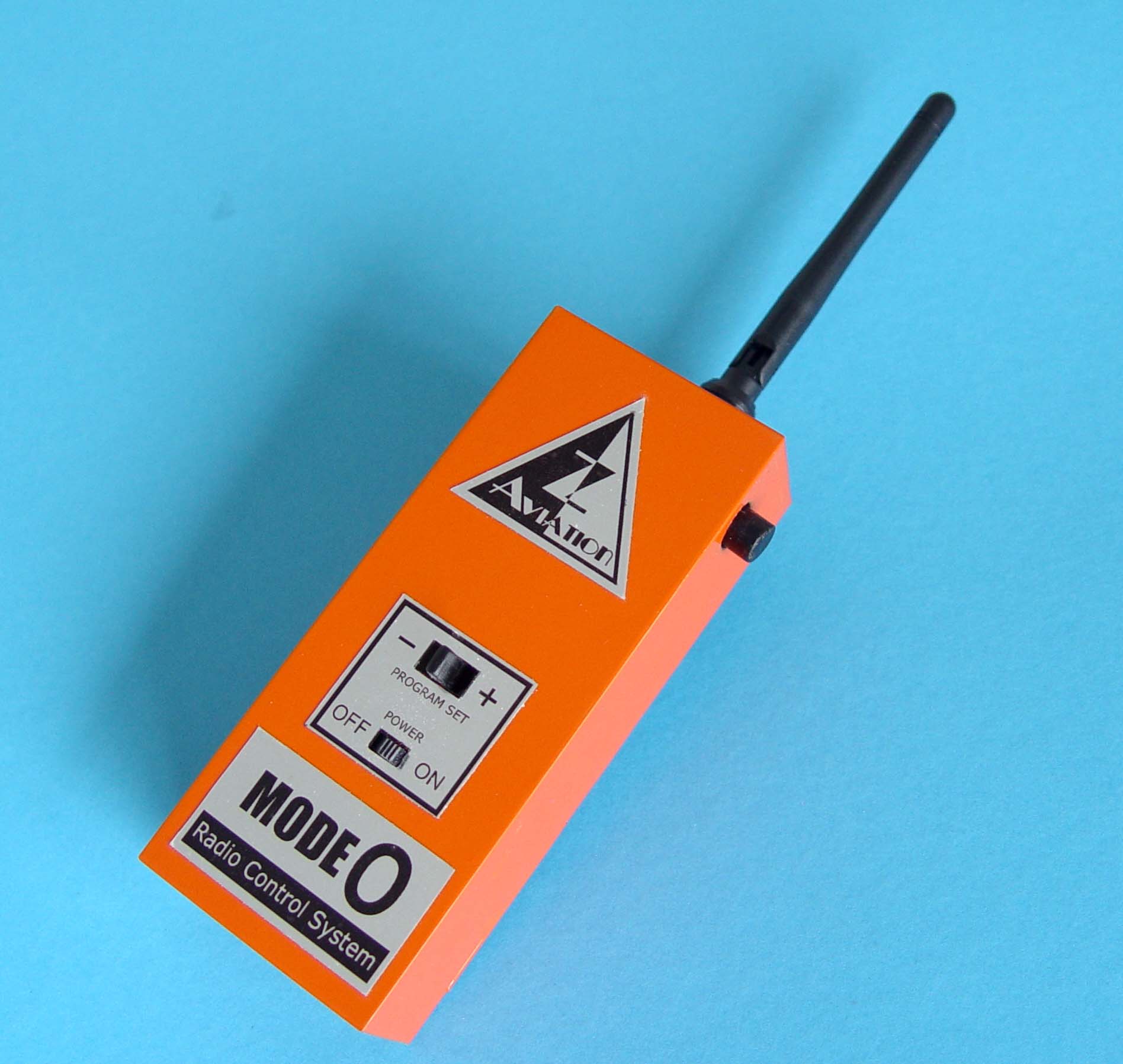

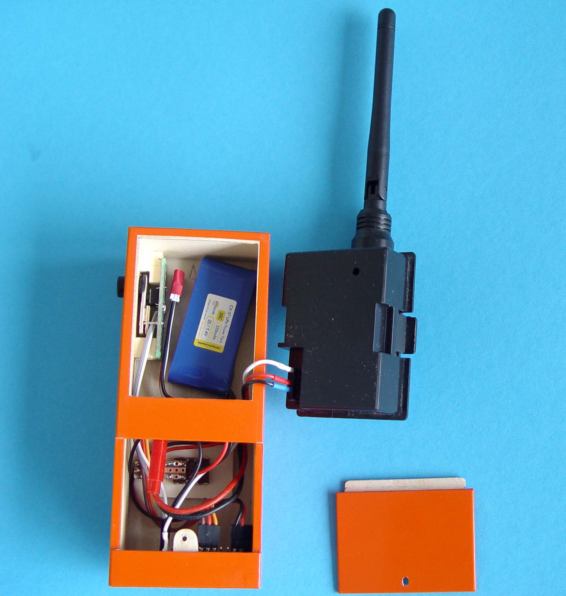

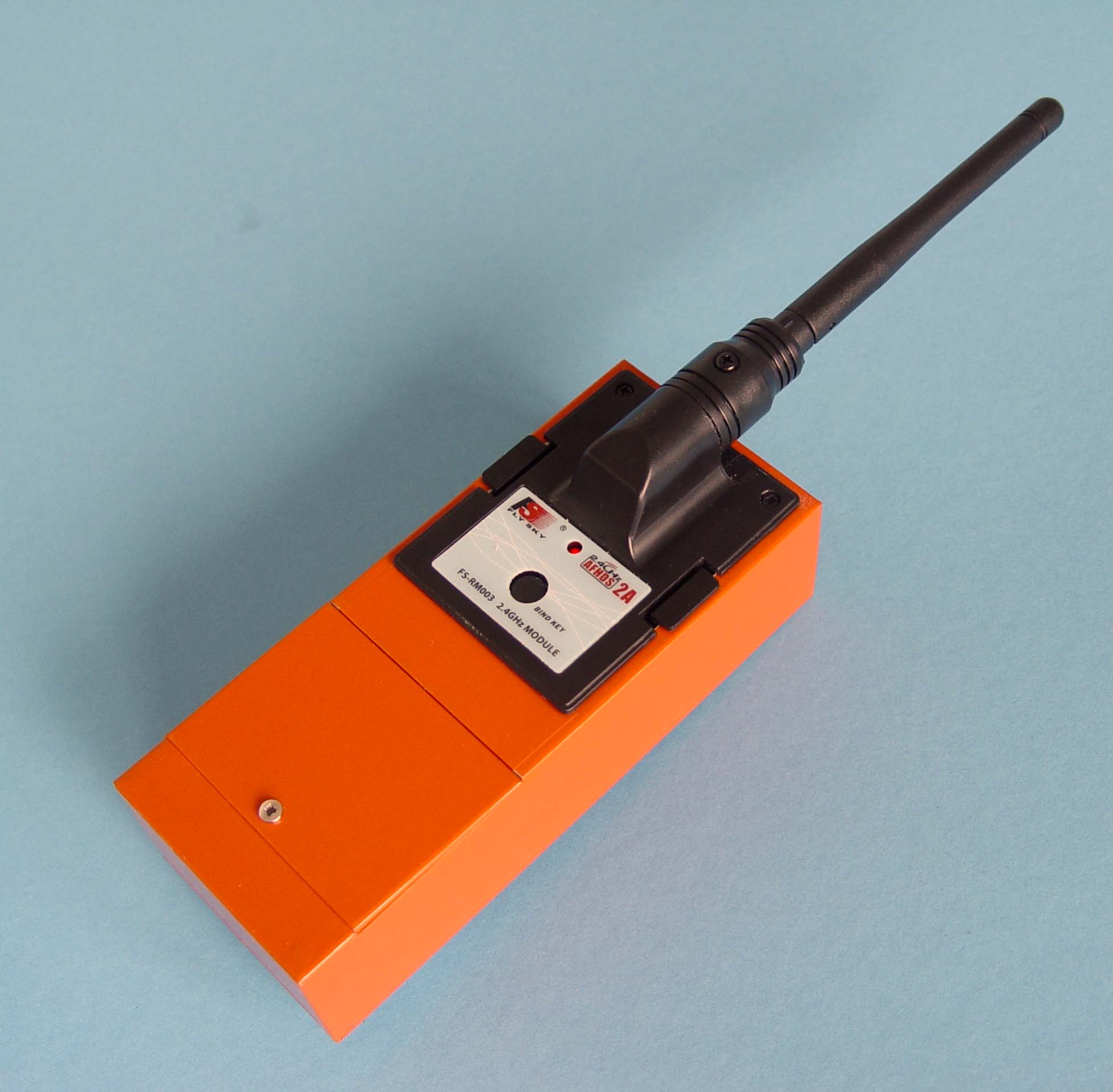

Finished, except for the parts I am still waiting for, beeper and jumpers:
Re: Yet another Single Channel Encoder
Wow,
Love it Max.
Great idea making it out of wood. Nice decals too. I’d finish it off with a personalised serial number plate on the back.
Well done.
Ps what’s it covered in?
