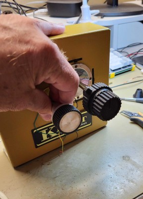

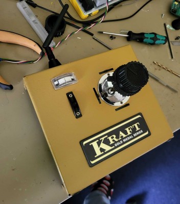

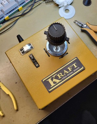

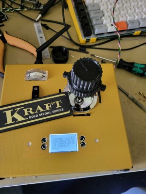

Not the Kraft but I have the 4-axis knob in the 2B-MK configuration. The Kraft SS set up is more as a test bench/show piece what could be done. The Kraft require the stick shaft to be replace with a new one to get enough space for the wires coming out from the knob. It took me a few minutes to remember that the original shaft is "metric" 4 mm just pressed in in the "ball" so it wasn't that difficult as my shaft is also 4 mm but with a large inside diameter....in one-way it was a trip down memory lane.
Still need to make my mind in what switches to add as this one has no toggle switches just trims.

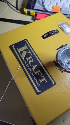

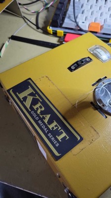

....and here comes a secret
I know that for some conversions it's called to remove the front brand plate but....
The secret is dental floss....yes dental floss and voilà.
I will let the 2 pictures tell you how the dental floss works!
The hardest part is to slowly get it at first under the tag in a corner but afterwards it's just a matter to pull the string parallel with the surface.
