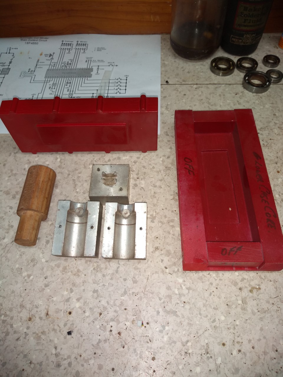

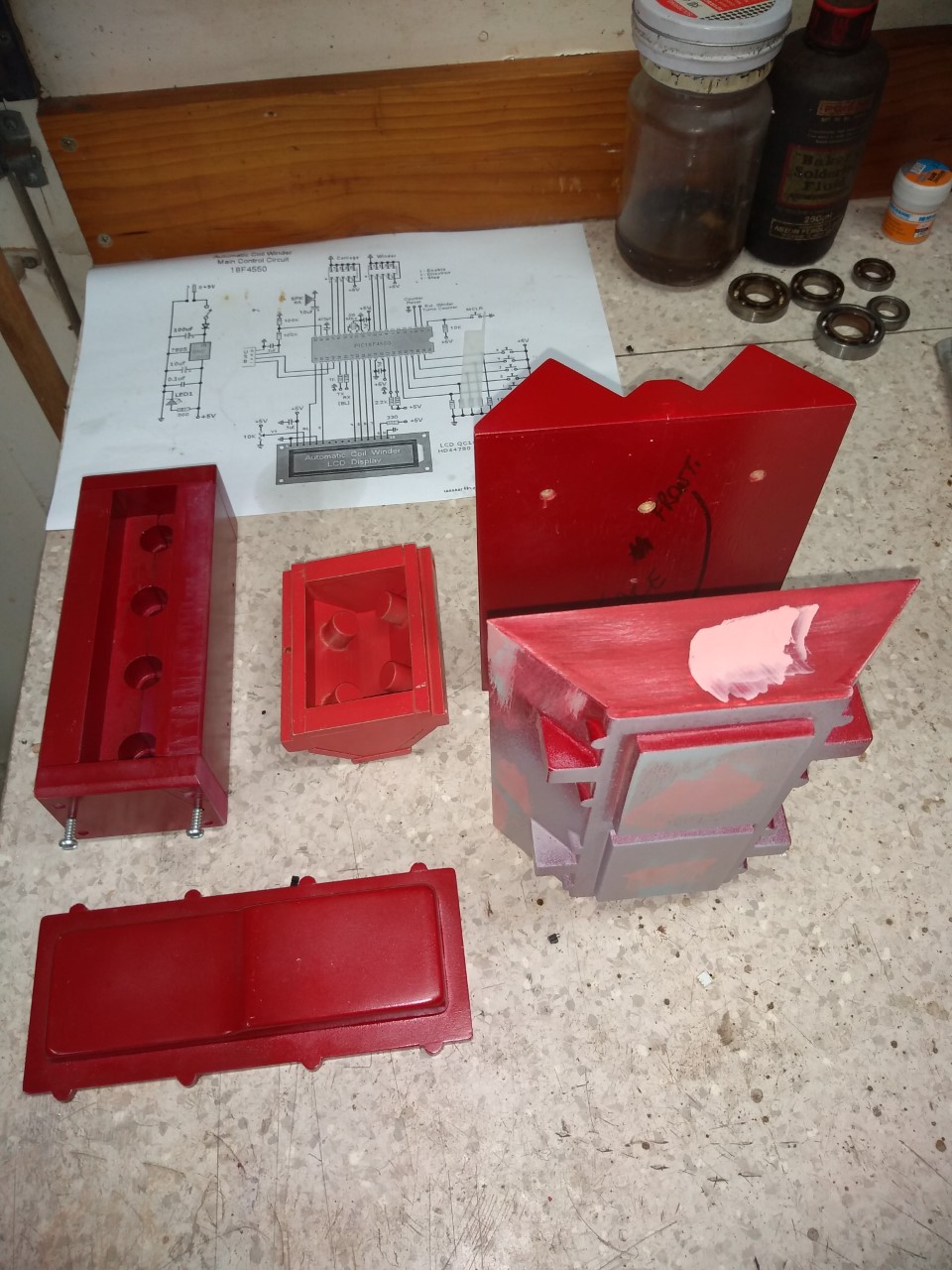

Photos below show the timber patterns both for the external sand castings and for the cores.

Patterns yet to receive a final coat of paint after a trip to see George and a couple of minor modifications.
Lower left is the sump cover which is a pattern for both the sump and the core of the same.
Top left and centre are the core boxes for the internal waterways and the crankcase inner core. 2 of each of these are used within the casting.
Finally the patterns for the crankcase itself.
Eventually will get around to the rocker covers.
George loaned me a set of aluminium patterns for the piston cores which makes for far less machining as it is then used as it comes from the casting process. Outer pattern for the piston is timber as shown in the last photo.
The four cylinder I built used 20 x 20mm pistons turned from solid whereas with George's piston molds, I can select anywhere between the same and around 22mm diameter, hence the previous "around 50cc".
Also in the last photo is the outer pattern and core for the lower crankcase.

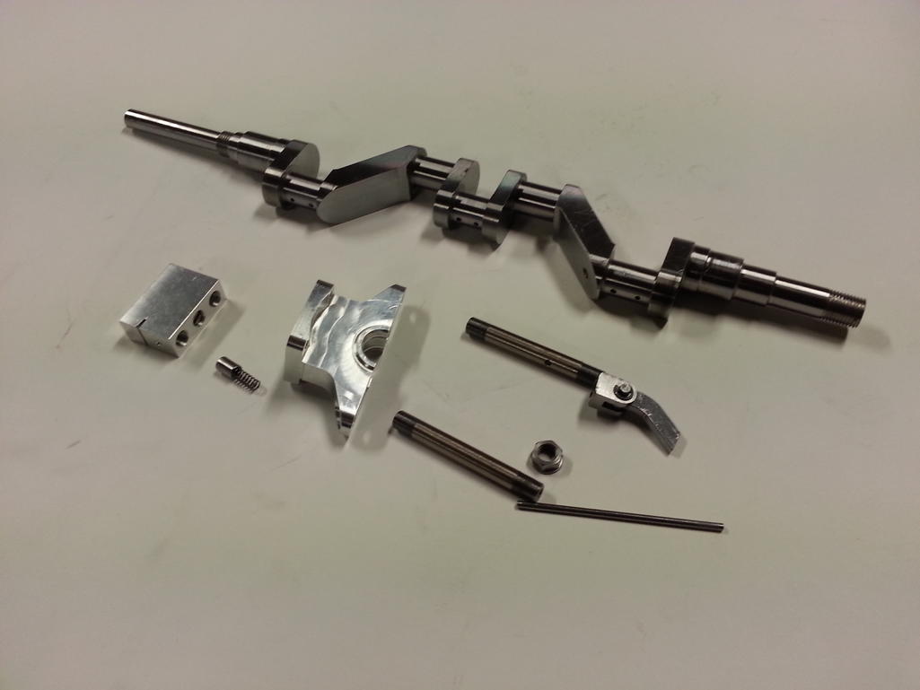

Plan is to use a flat crank, same as I used in the four cylinder (as below pic of a Challenger crank) but....as there are 2 conrods per big end, one has to keep in mind the timing of the cylinders.

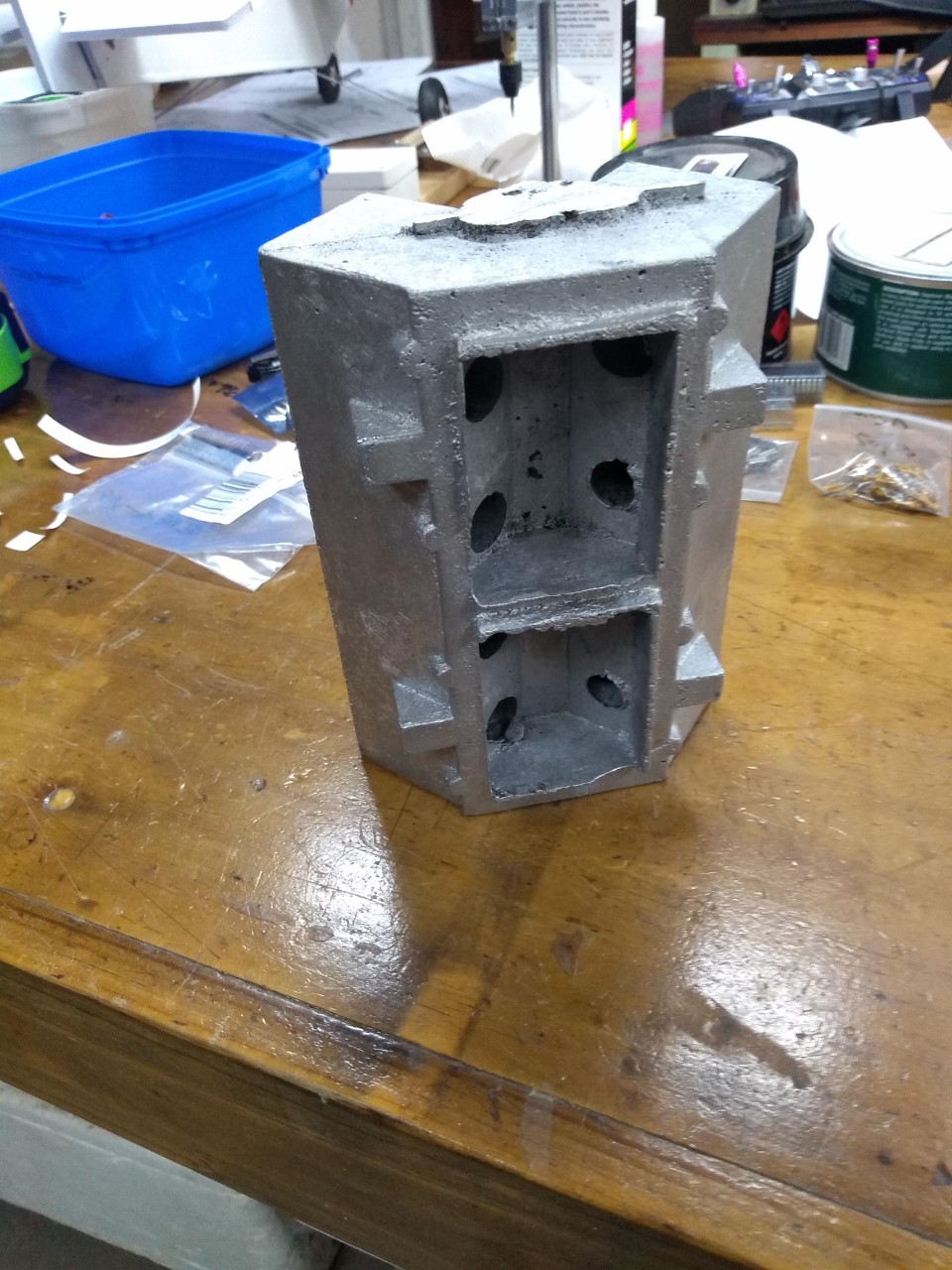

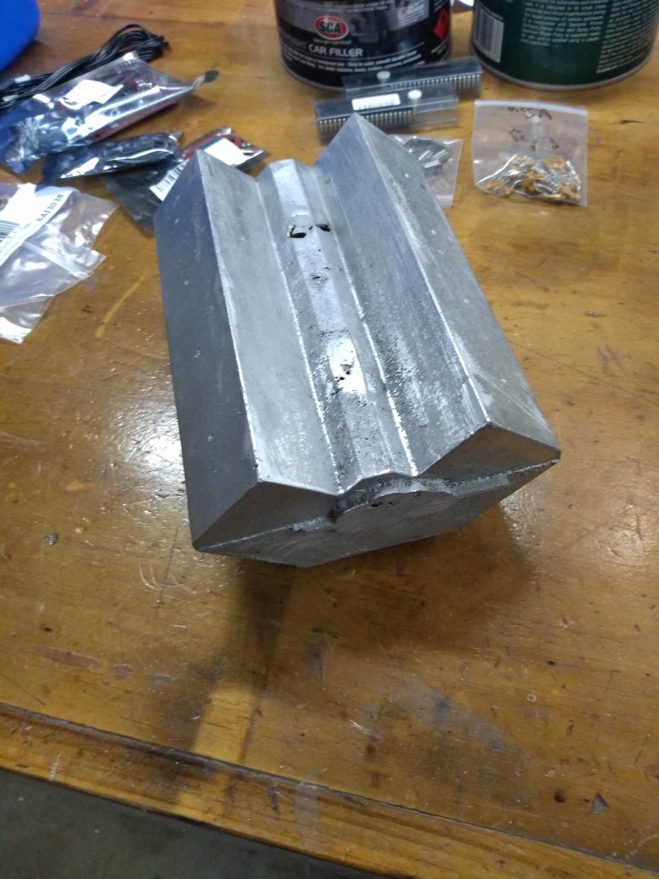

Had a call from George to drop my patterns up to his place to make sure it "all fits his sand boxes".
Thought that a bit strange as he has quite a range.
Anyhow, busy with day job and getting his temperature and tacho gauges finalised so dropped them off on my way to work.
Get home that afternoon, email waiting, check your mail box.
Never had a parcel like that before, still warm too.
Photo below of casting up and done.
Guess the favours work both ways.
Small defect in the centre valley but neither here nor there as a quick repair with some metal epoxy should seal it up.
Didn't break through anywhere so all good.
2Kg of alloy there....machining will remove a large portion but as it is for a boat, no real drama.
Now, where did I leave his Oleds for the guages....????......
