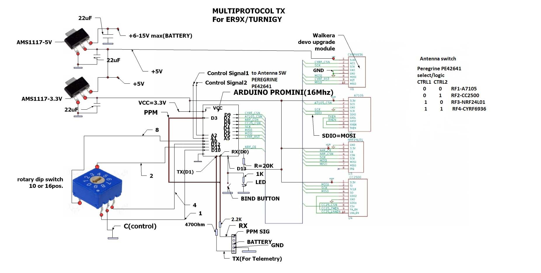

On Pascal's schematic the CC2500 connections are:
1 - 3.3v Vcc
2 - MOSI - to Arduino D5
3 - SCK - D4
4 - MISO - D6
5 - D03 - connected to Pin 10 LNA-EN
6 - GND
7 - D00 - connected to Pin 9 EN-A
8 - CSN - Arduino D7
9 - EN-A - connected to Pin7
10 - LNA-EN - connected to Pin 5
The smaller CC2500 pinout looks different, as per your video:
1 - GND
2 - 3.3v Vcc
3 - MOSI - D5
4 - SCK - D4
5 - MISO - D6
6 -
7 -
8- CSN - D7
No interconnections of pins, which makes me query Pascal's schematic.
Protocol select pins 10,11,12 and A0, you have 10, 11 and 12 connected to Vcc (High) which I assume is the same as no connection to Gnd from the rotary switch. A0 is connected in video to Gnd which would select Bank 1, mode 8 and as all modes on the config are FrSky, it is selected. Is connecting 10, 11, 12 to Vcc better than leaving open and floating?
I understand that 5v on any pin on the CC2500 can kill it (probably what I have done) but again Pascal's schematic show direct connections from the Arduino or ST32 to the CC2500 module. So once again this makes me query Pascal's schematic.
My next attempt will be with, like you using only 3.3v to the arduino.
I guess that suppling the small CC2500 from the Arduino 3.3v is Ok but I suspect the CC2500 version with LNA and PA will need a separate 3.3v supply as per Pascal's schematic.
Thanks for your assistance with this and I think your proposed version with Phils encoder making a DIY FrSky transmitter module is a great idea.
I have attached Pascal's schematic.

I think the two pins I didn't connect (named GD00 and GD02) may be some spare I/O pins on the CC2500. I think (maybe) Pascal is using them as outputs to enable the low noise amplifier, etc - but my little module doesn't have those extra features so I just left them disconnected. I'll investigate further when my bigger modules arrive.AndyS wrote: 25 Oct 2020, 10:52 That is the module that I have used so far and is probably destroyed.
It does not come with connector or antenna.
I have some questions however regarding this module:
1 - 3.3v Vcc
3 - SCK - D4
4 - MISO - D6
6 - GND
1 - GND
2 - 3.3v Vcc
3 - MOSI - D5
4 - SCK - D4
5 - MISO - D6
6 -
7 -
8- CSN - D7
You can leave the pull-up links off - they're not needed.Protocol select pins 10,11,12 and A0, you have 10, 11 and 12 connected to Vcc (High) which I assume is the same as no connection to Gnd from the rotary switch. A0 is connected in video to Gnd which would select Bank 1, mode 8 and as all modes on the config are FrSky, it is selected. Is connecting 10, 11, 12 to Vcc better than leaving open and floating?
STM chips all work at 3.3V anyway, and there are some notes in the documentation of Multiprotocol, that although you must select '5V 16MHz' in the Arduino IDE for Atmel ATMega328 chips, any boards must actually run at 3.3V. The problem is that the Arduino IDE bundles the voltage with the frequency - even though they are really independent, and the IDE has no way of knowing the the actual working voltage. So the rule is, 'choose the 5V 16MHz option in the IDE, but make sure you actually use a working voltage of 3.3V'. Beware serial interfaces and USBasp interfaces that can be switched to 3.3V - some of them switch just the VCC line, but still leave Rx, Tx, or MISO, MOSI, etc working at 5V - which can then 'leak through' to the CC2500 and kill it. Check the interface voltages out with a multimeter and/or scope before you trust that they are really 3.3V. The alternative is to use one of those level shifter boards to keep the CC2500 safe from 5V.I understand that 5v on any pin on the CC2500 can kill [it (probably what I have done) but again Pascal's schematic show direct connections from the Arduino or ST32 to the CC2500 module. So once again this makes me query Pascal's schematic.

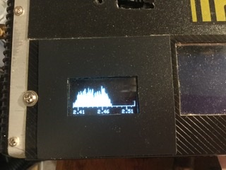

I have a result!
Without changing my connections or the Arduino multi module config_h, but powering both the ppm generating arduino and the multi module arduino with 3.3v I got an output on my 2.4Ghz scanner.
So I have been very lucky in that the CC2500 seems to have survived 5v (measured on scope) control signals to the module. But the module only works when they are 3.3v.
I have not yet tried the module with a FrSky V8 reciever. Just very happy to get an output at this stage.
