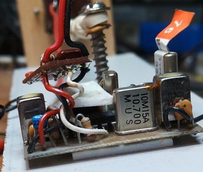

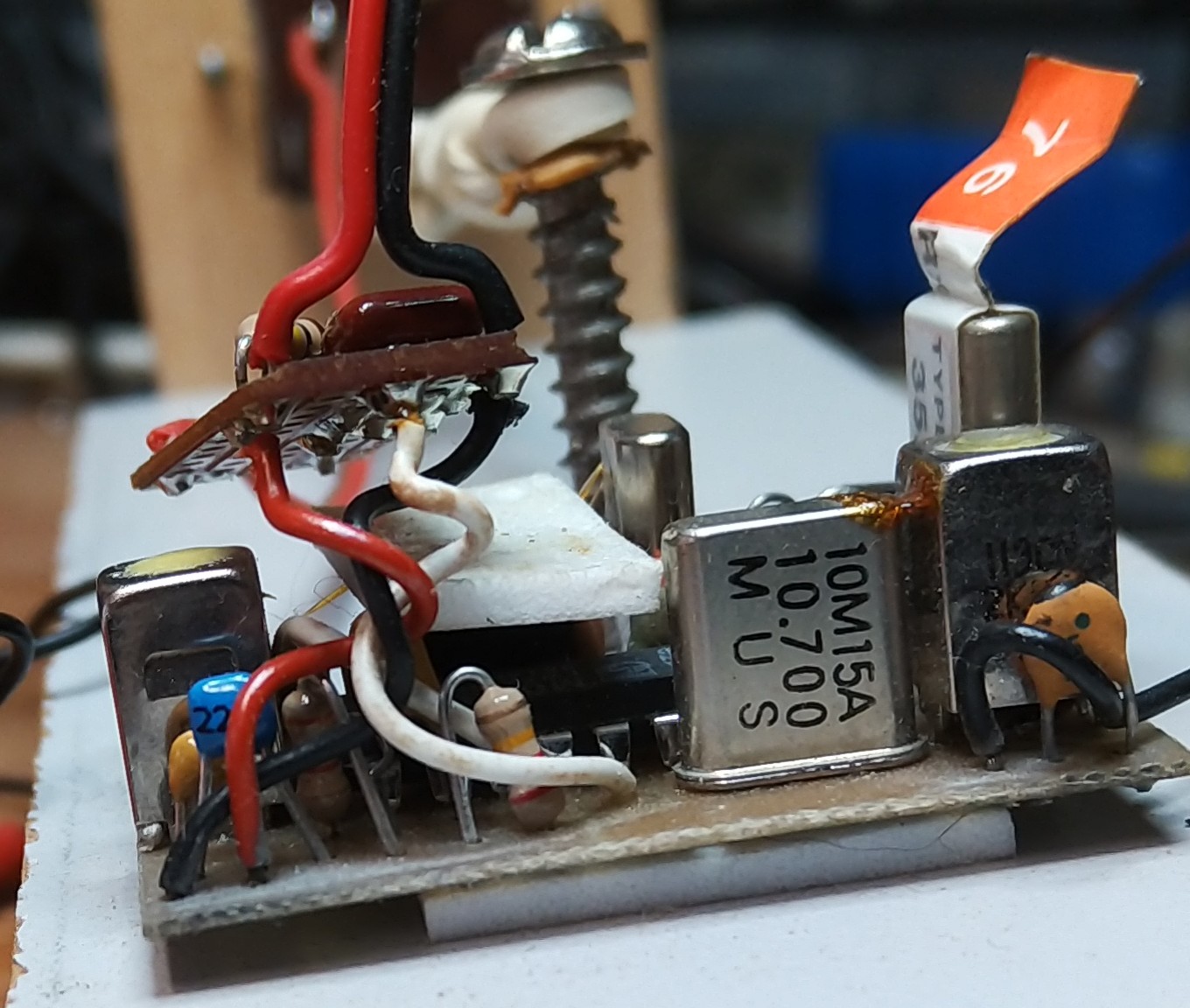

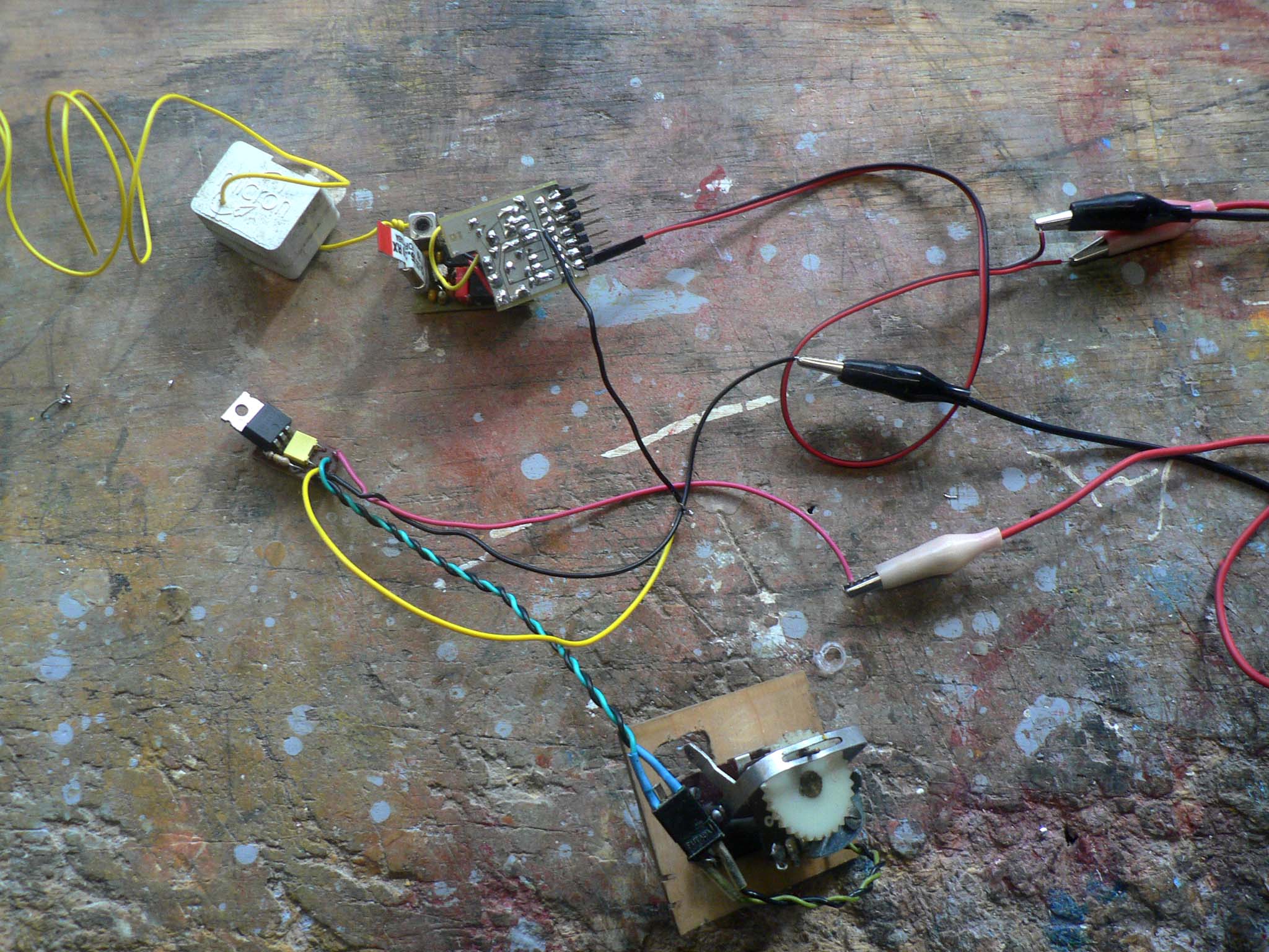

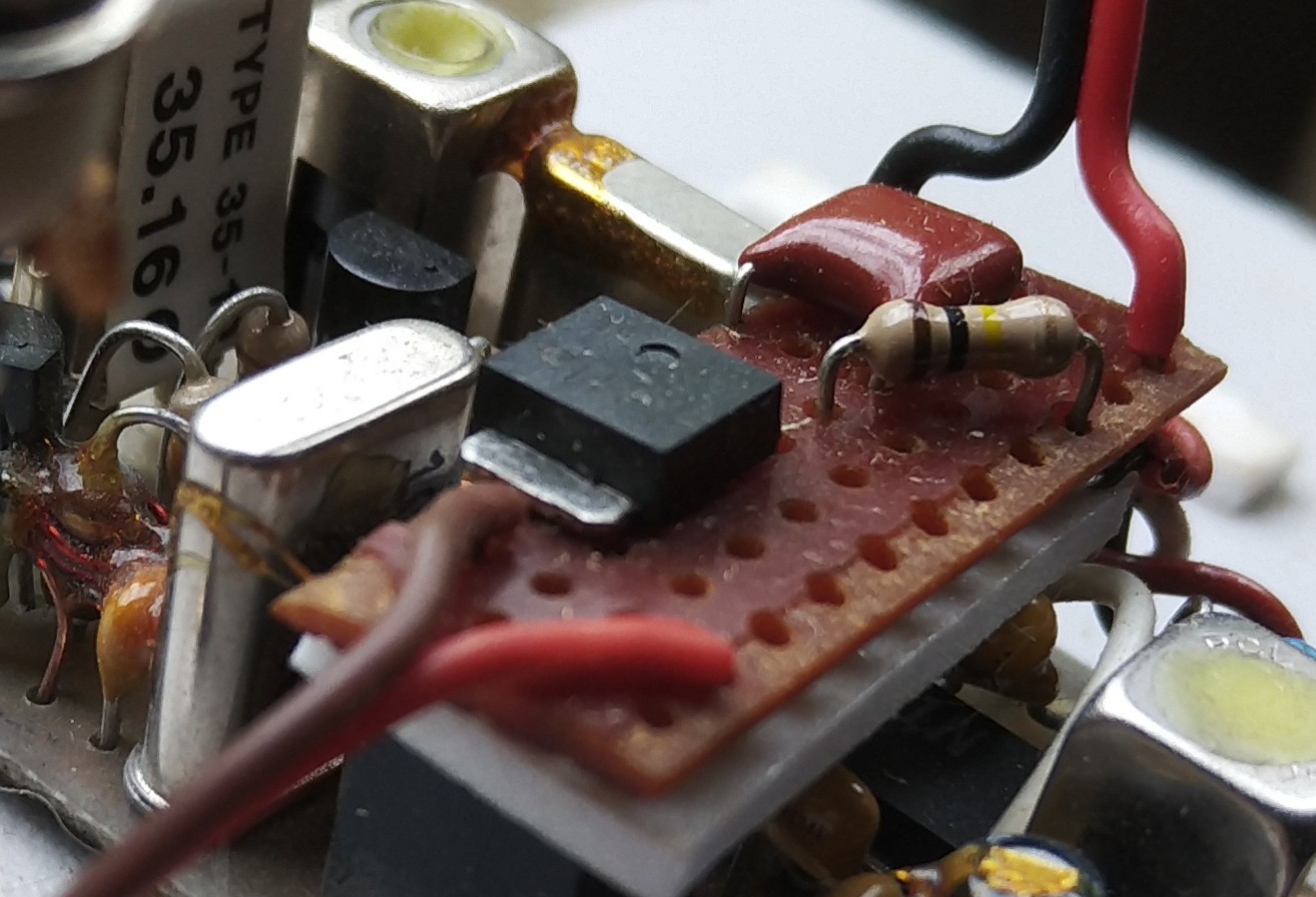

I used half a Micron in my 35Mhz S/C receiver:

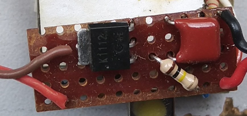

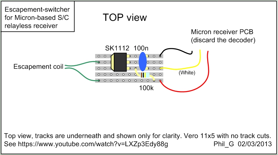

The add-on switcher board is very simple, just a small MOSFET, a 0.1uF cap and a 100kΩ resistor:
The MOSFET is an 2SK1112 but isnt critical, its what I had at the time. I see they've become expensive so an IRF110 should do and is much cheaper:
https://uk.rs-online.com/web/p/mosfets/1451621/ ...any N channel mosfet with Rds under half an ohm and a gate threshold of 2v ish.
Other than removing the decoder, the Micron receiver is unmodified, the white wire carries the PPM signal and when it rests during the sync pause, the FET is switched on. Its very simple but works perfectly and the Micron is an excellent receiver. I've shown white as yellow in the diagram, I dont know if the PPM wire is white on all Microns, but its the only other wire apart from pos & neg. The combined rx and switcher is powered from a 4 cell NiMh or in my case a single lipo cell - note that the battery wires also connect to the red/black from the receiver - ie they're soldered to the same veroboard rails as the red/black from the receiver, as can be seen in the photos:

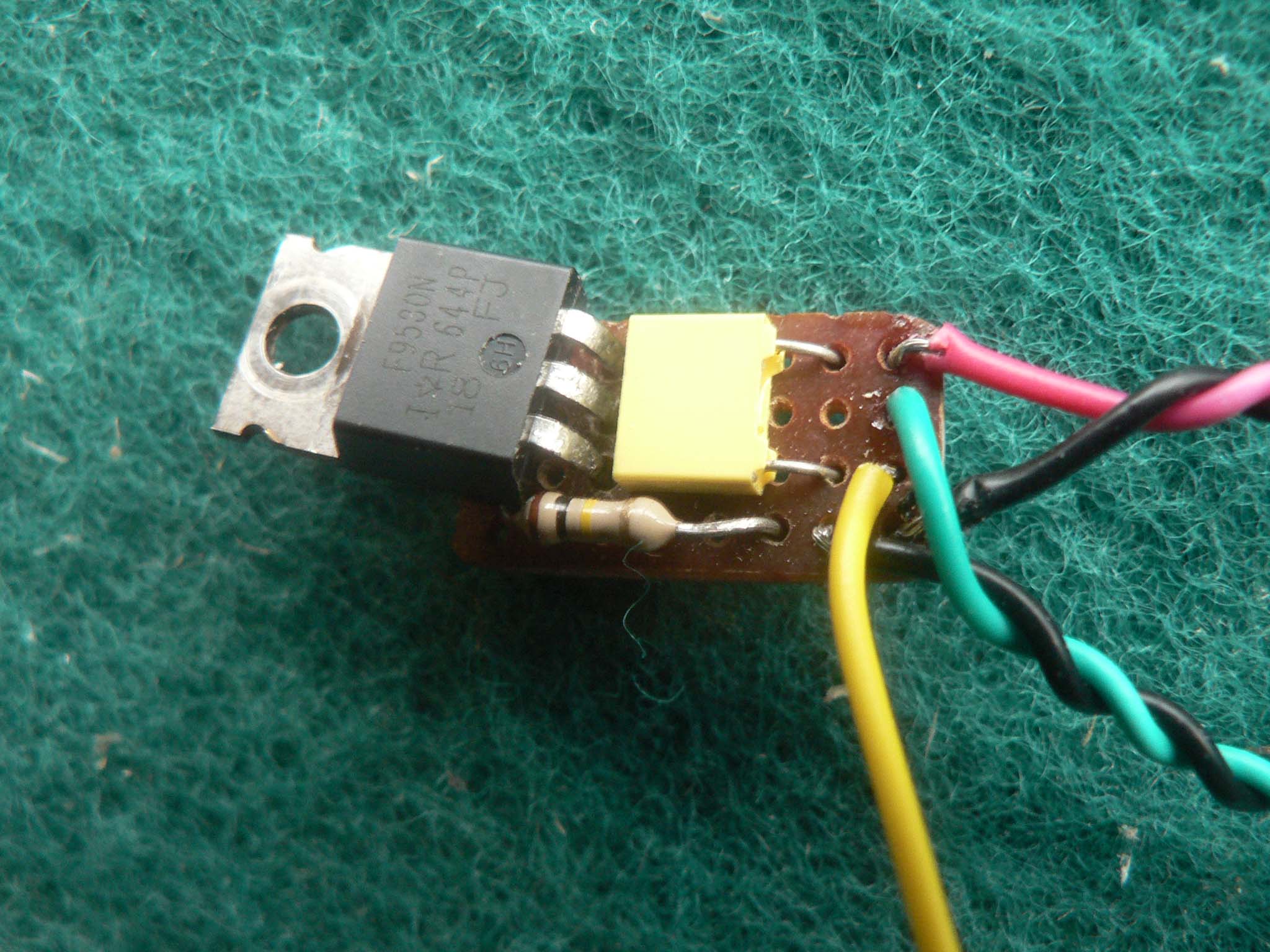

I wondered if using a P Fet channel would allow the escapement to pull in on tone. As I had one in the scrap bin I figured it was worth a try. After reversing the circuit it all worked. My Tx is running about a 600Hz tone so the escapement was rather noisy. By increasing the cap to 0.18mfd it settled down. My intention is to attach the switch to the Rx case so it can be used a S/C and regular Rx. Attached is diagram of the Rx complete with S/C switch and a couple of pix of the setup and also my RCS Tx running one of Phil's emulators on the back of a 40Mhz Futaba Tx module.

A small correction. Connect the source of the FET to the battery positive supply. Not the emitter of the supply transistor. A high output current will fry it.

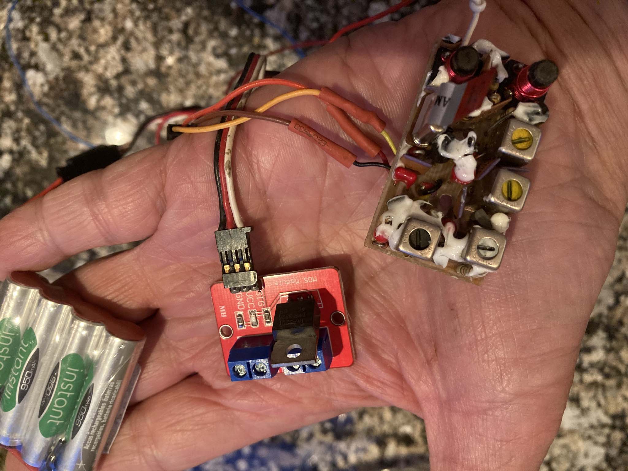

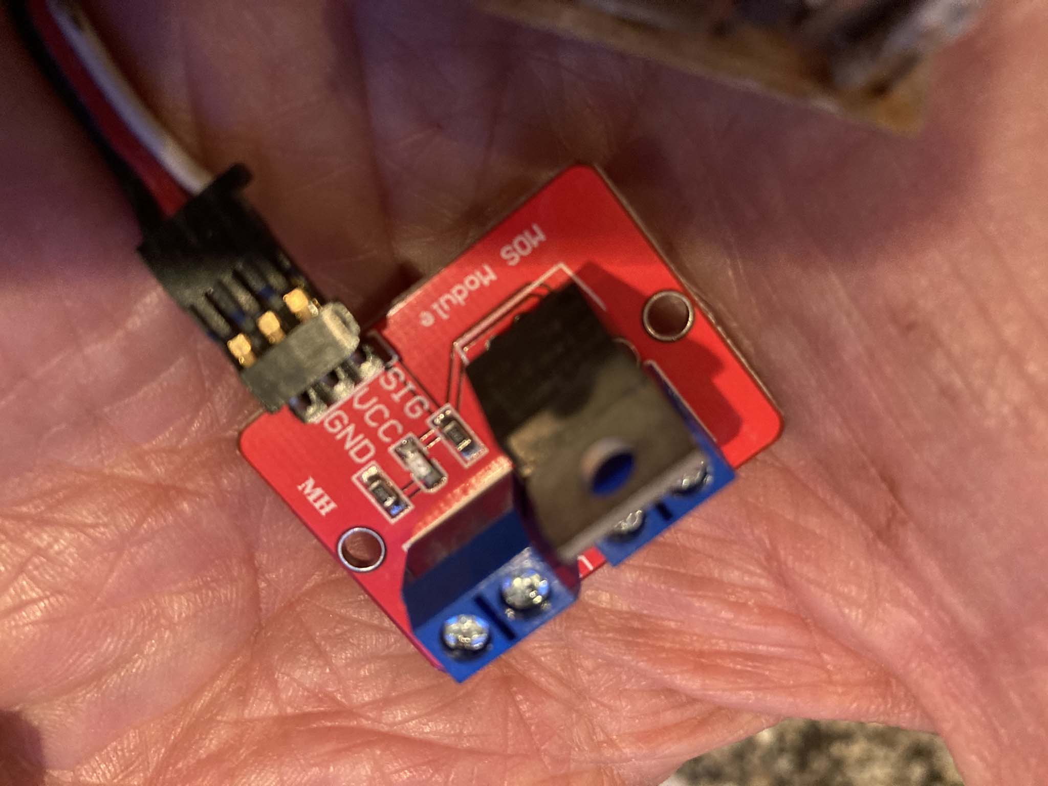

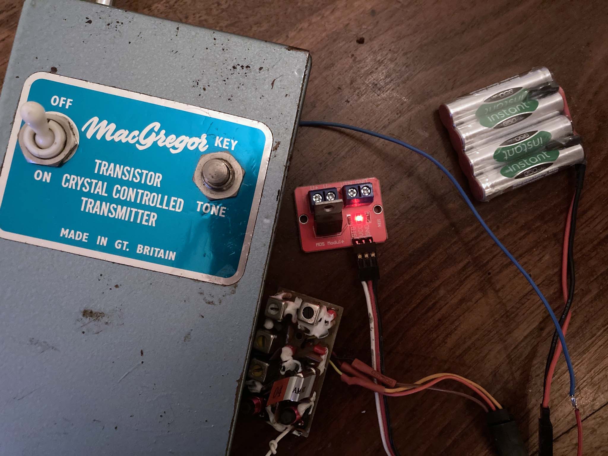

Well I’m so glad I came across this posting ! I cannot bear throwing away anything radio control that might be or could be restored to working condition. I have a Skyleader double deck superhet with a fried decoder board. Ok so the decoder I did throw ! I had been fiddling for weeks of evenings with a Darlington pair soldered to a relay . Marginal results . So seeing this prompted a scan of the RS page for the mosfet . ( link posted earlier ) But you need to buy so many of the little blighters . So I looked on Amazon and sure enough much smaller quantities available . Then I came across this:
https://www.amazon.co.uk/gp/aw/d/B06XB9B16Z?psc=1&ref=
It’s a MOSFET switcher designed for an Arduino. £3:99 plug and play . Do I did ! And it works! Yet to put a load on it the LED lights in the absence of signal and the led goes out when carrier keyed .

Great to see another set put to use. That Fet module looks interesting. Love that Mc Gregor Tx. My first set was a Mc Gregor valve Tx and a Terrytone receiver. Built from kits.
