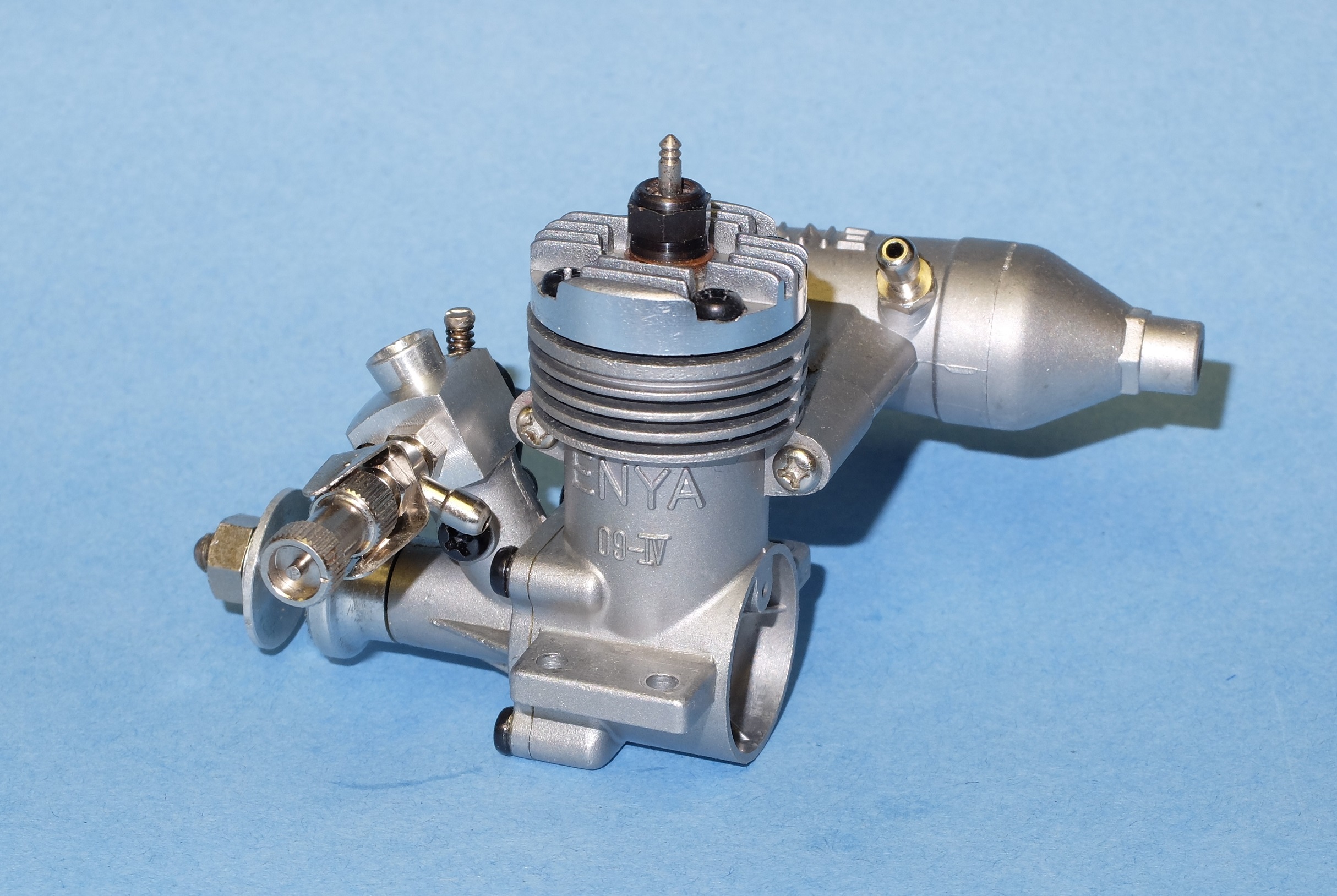

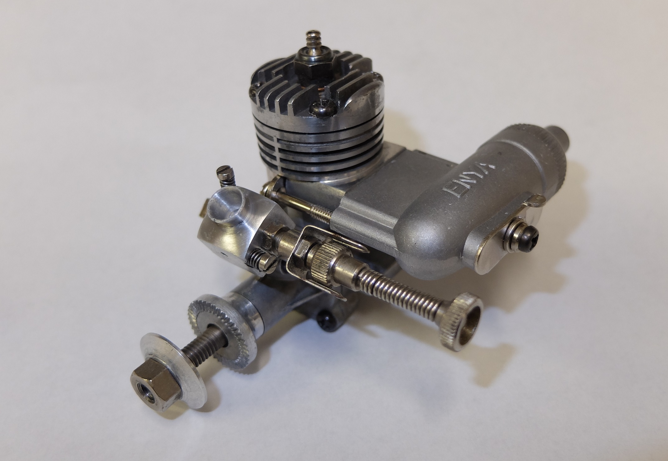

The Enya .09 up to and including the .09 III had a left hand exhaust with an optionally available strap on muffler.
Starting with the .09 IV they switched to a right hand exhaust with a very nice bolt on muffler.
Both engine run very well and are at least as strong & have more torque than my OS 10 FSR.
My Enya .09 IV is slated for my 80% Executor, hopefully it warms up enough soon so I can finish off the paint job.
- ozrs
- Posts: 117
- Joined: 16 Feb 2018, 15:21
- Location: West Australia
Re: Enya 09
Actually the first Enya 09 (model 3001) had a right hand exhaust.

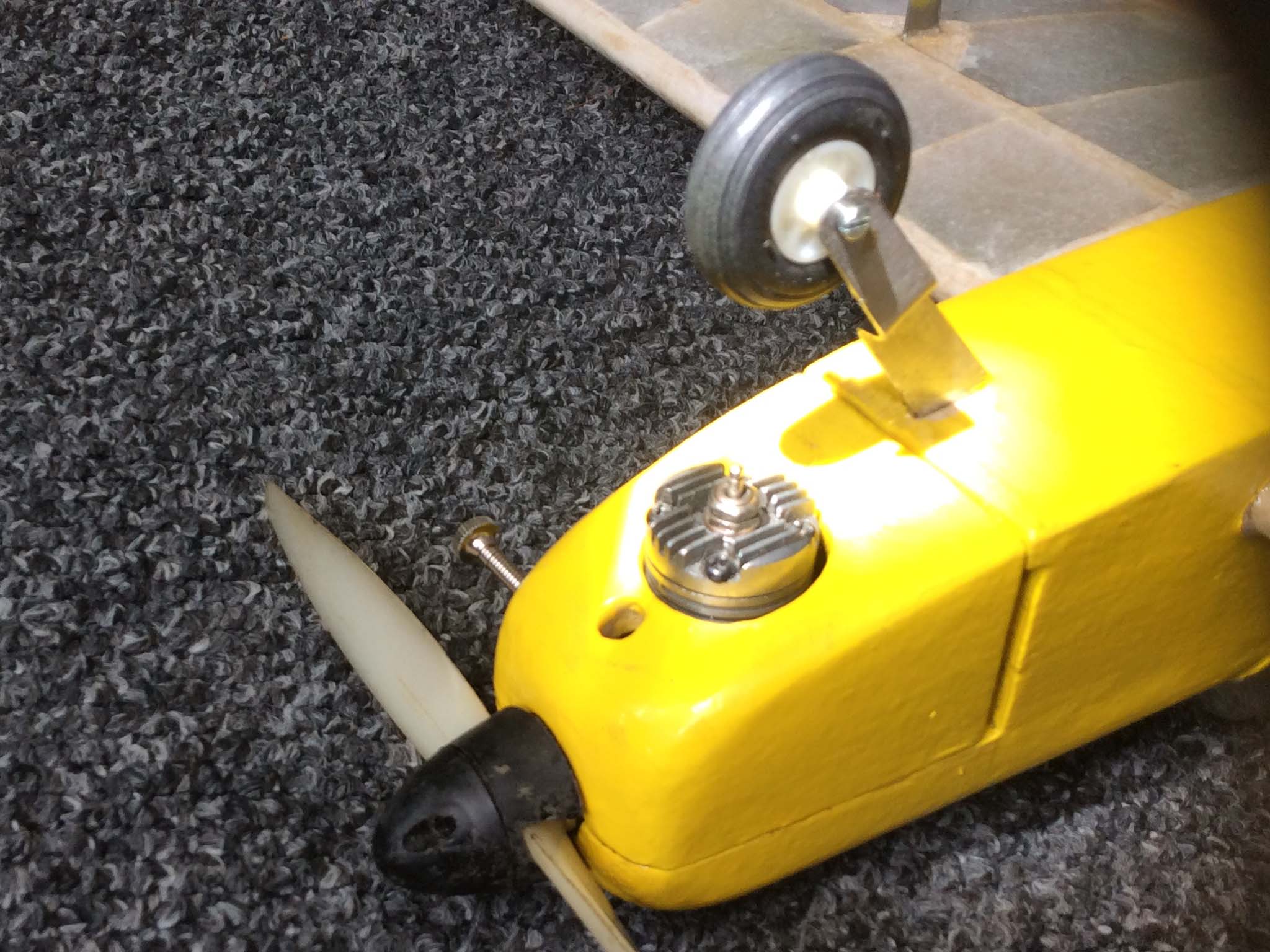

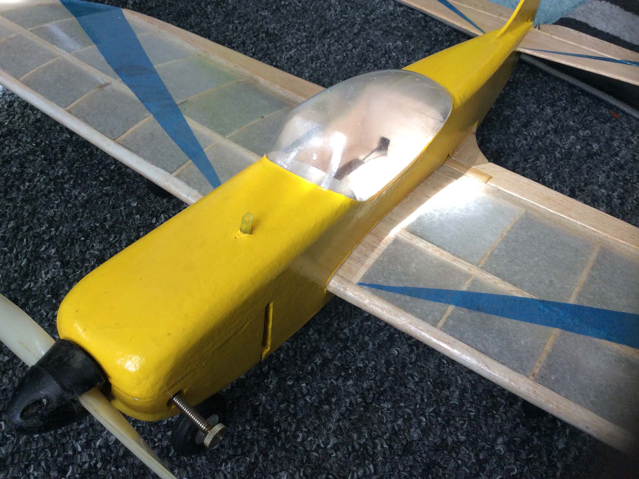

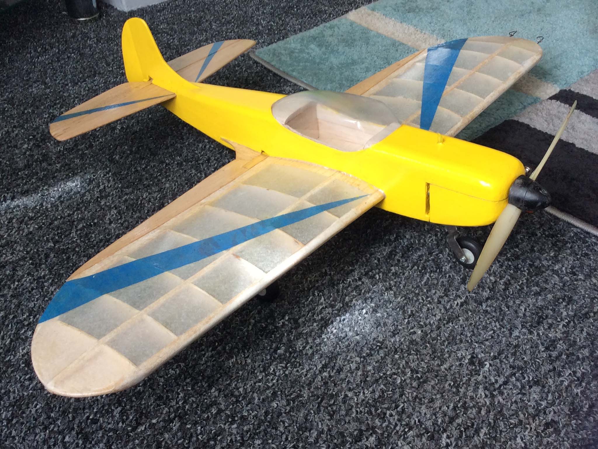

Thanks for the great reply’s recently bought one on flea bay , fitted it in a KK marquis . The silencer looks in the right shop with the engine inverted !
Tony
Tony
