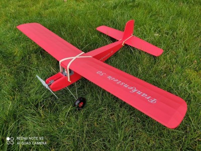

The Frankenstein originally had a Mills 1.3 Mk1 diesel fitted, but was a little underpowered (due mainly to the amount of lead in the nose to get the CG anywhere near right !). It has now been fitted with a PAW 09, and flies very well. The radio link (using Phil's Single Channel Encoder) has performed faultlessly.

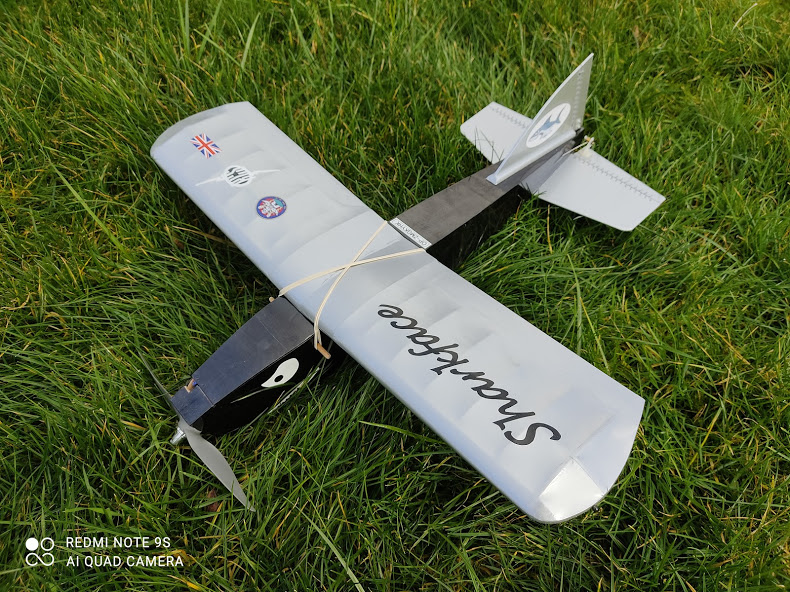

The Sharkface is electric powered, but has proven to be a real handful ! I have temporarily reverted to proportional control while I try to get it trimmed a little better before I dare go back to single channel !

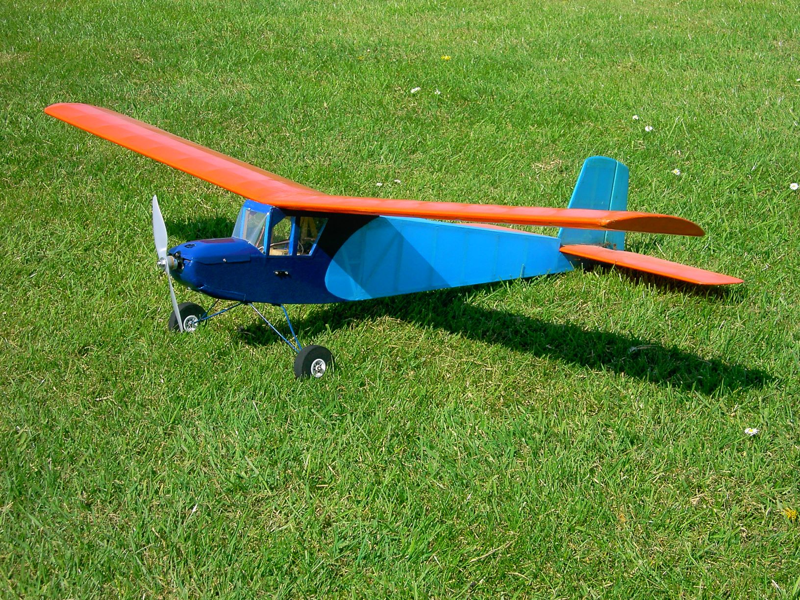

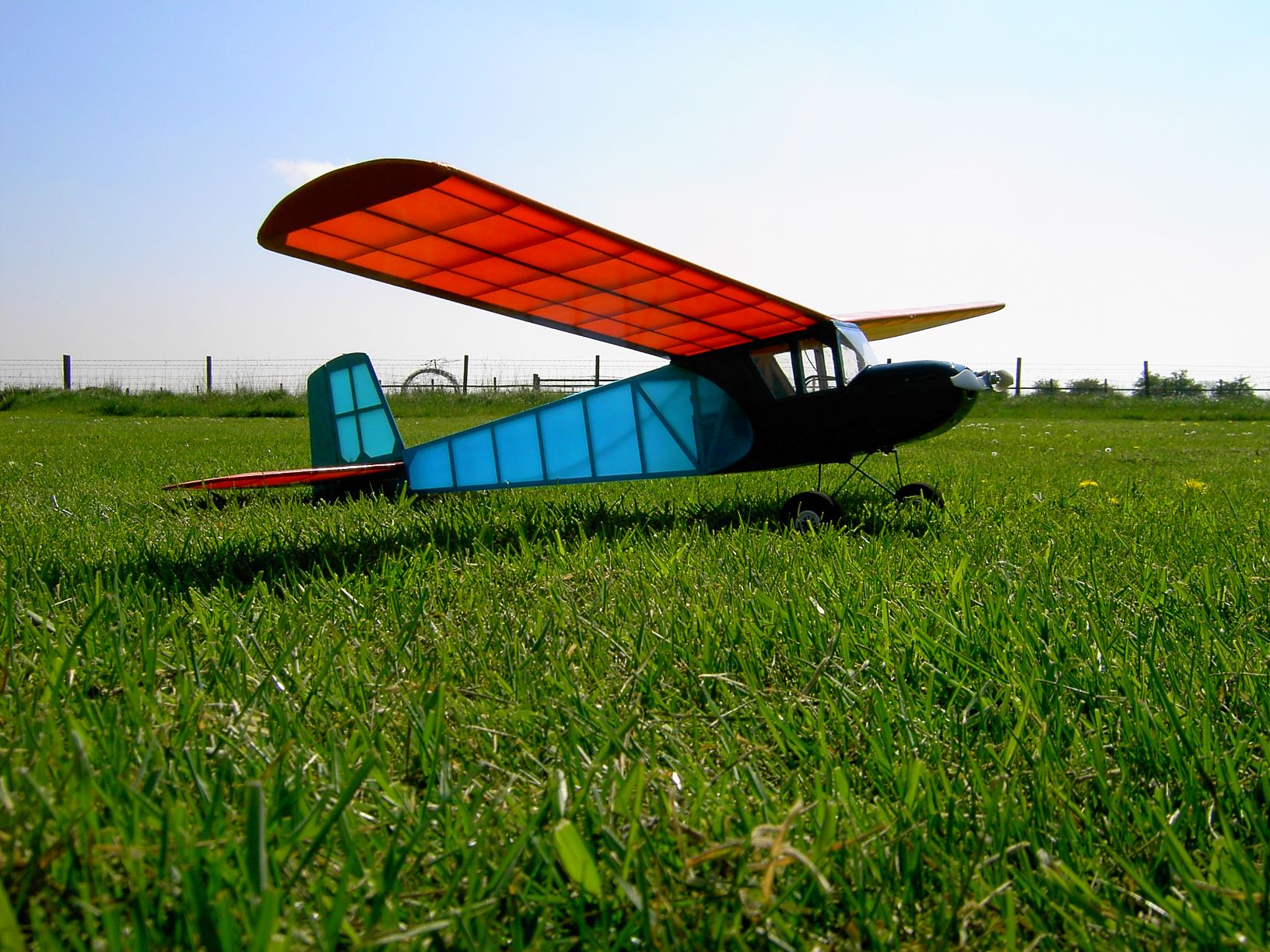

Hi Roger, I'm surprised you found the Frankenstein underpowered by the Mills. I built a scaled up version (57" wingspan) from a kit produced by a LMS back around 1994, fitted it with an Indian Mills 1.3. It didn't need any extra nose weight & the Mills power was fine. The engine was mounted on a paxolin plate so that it would be easy to try various other engines, the most marginal & heaviest I tried was a worn out ED "Penny Slot" but it still managed to drag Frankie around with some coaxing.
Later converted it to electric, first with a 600 brushed & 7 x sub C nicads. Weight was eye watering but it actually flew very well & was a little overpowered. Later tried a 480 brushed with a gearbox (IIRC 1.65 : 1) with 7 x 2/3 AF Kan Nimhs, this is the version in the video & photos. This was much lighter & with adequate power - enough for loops & rolls. Video was made using an early Flycam so isn't great.
