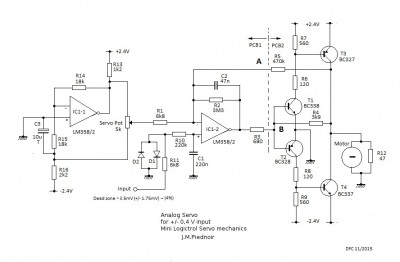

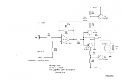

This gave me a chance to test my improved analogue servo design with a actual radio, which led to simplification of the schematic compared to the one published on page 22 of the the Norcim site.
Original prototype
Original prototype
Final working servo schematic
