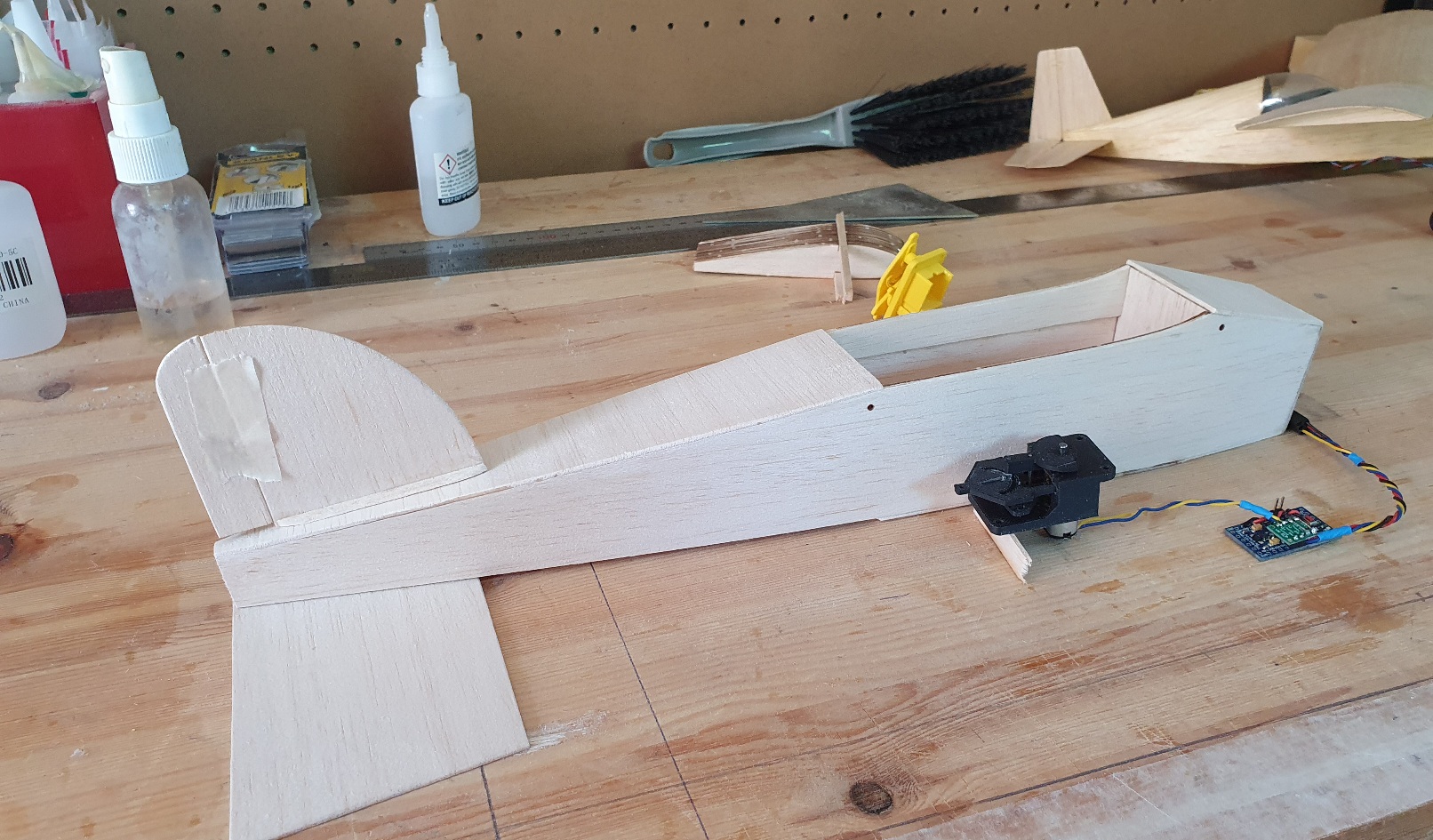

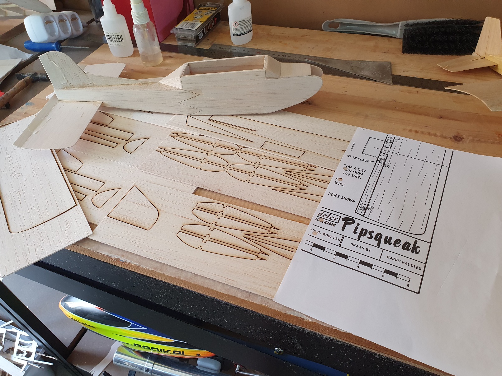

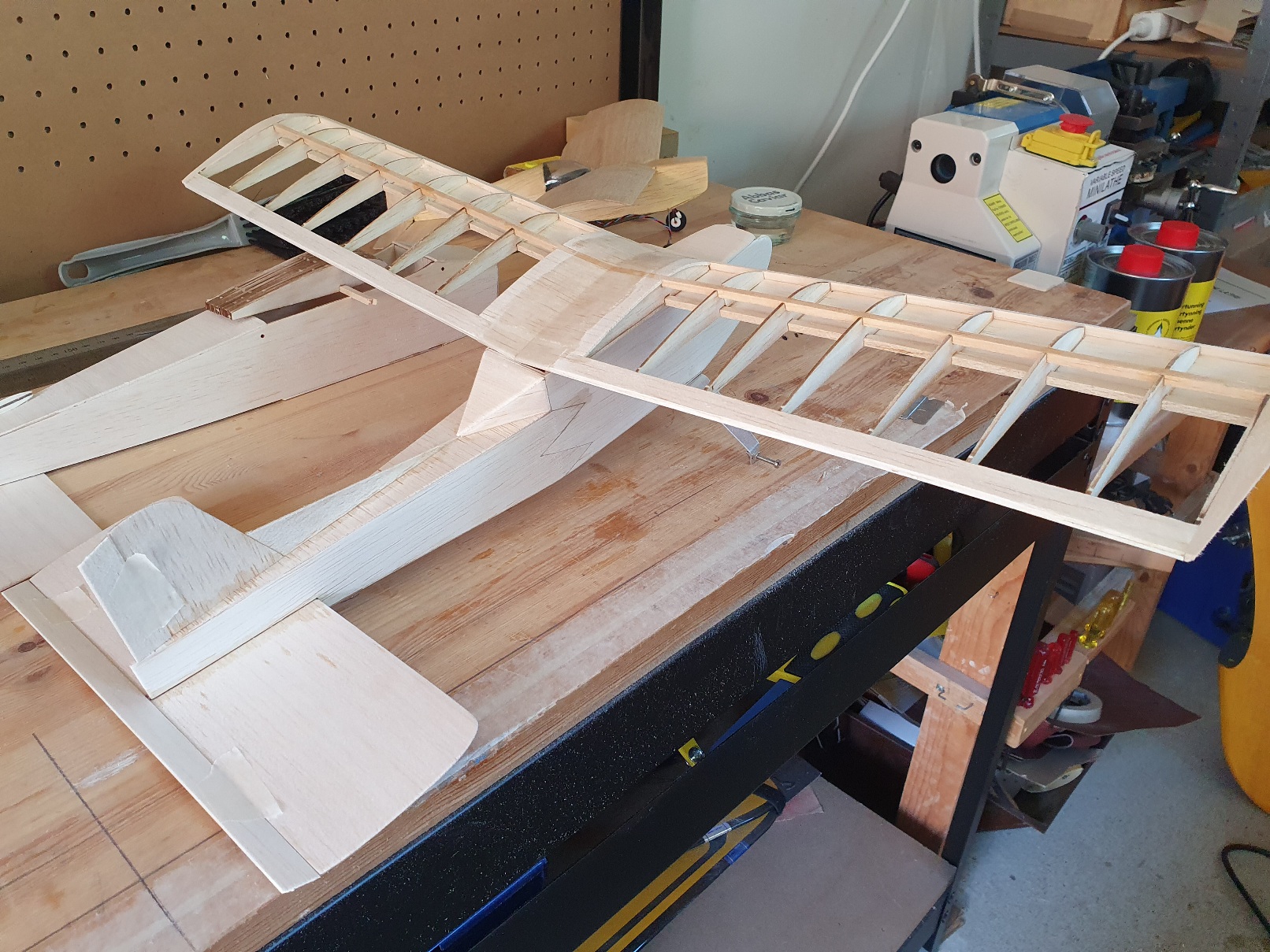

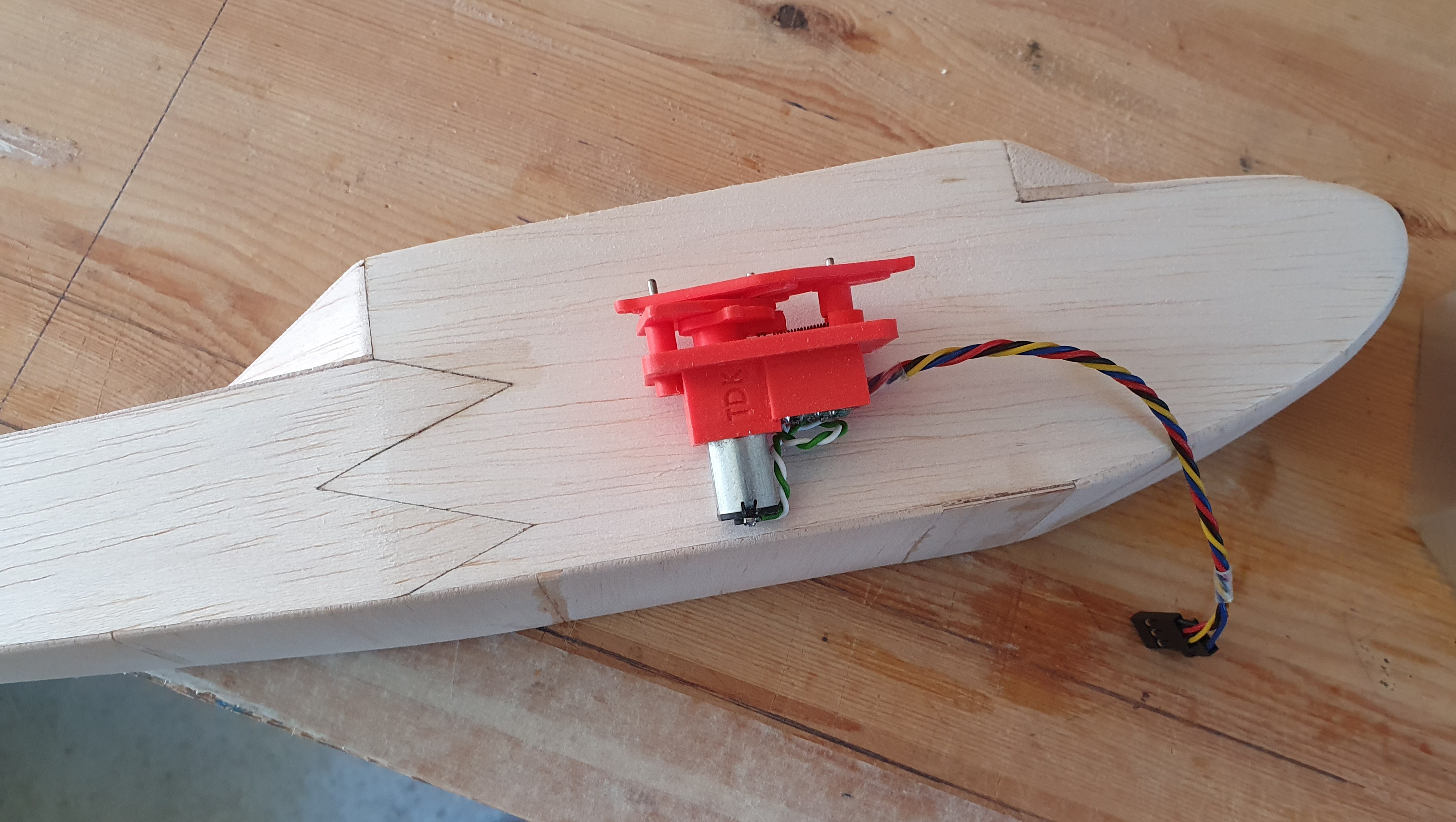

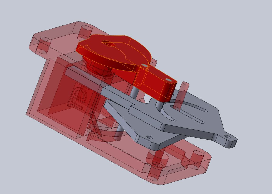

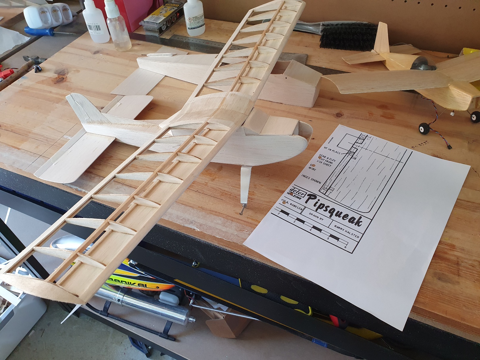

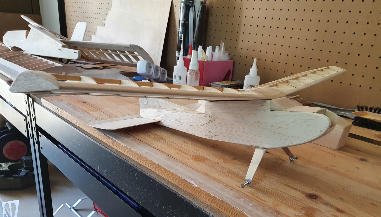

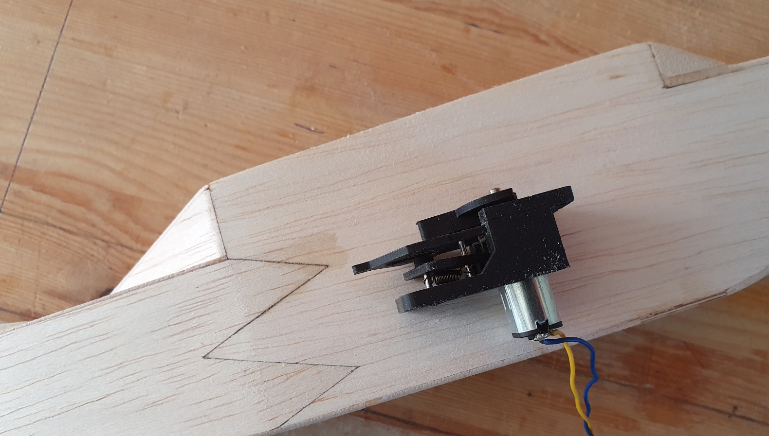

as I just acquired a Canon Micro R/C system with a Cox Pee Wee.020 and it was a real nice flier but time passed and it was forgotten till a short time ago so I decided to go for a new one and I took the time to make proper files so I was able to laser cut the parts. Of course it was this time intended for GG but I realized quickly that none of my actuators would fit nicely so I was locked to make a cage in the back as by the original. However my brain during a morning walk went in an uncontrolled mode i.e it decides by itself what to come up with...from this first thoughts and some try and error I came up with a "mid acting GG actuator" that would fit in some of my smaller models like the Pipsqueak, a Lil 'Stick and not the least in a replica of my first R/C model given to me by my late dad with an ACE Pulse Commander...and yes that model still exist!
So the project was just a project for a while but after some tinkering it went into production and is just awaiting installation and a covering job.
AS you might see I had to mid place the 2 plates so now the actuators height is just the height of the motor/gearbox. The actuator is built so it works with elevator horn placed on top which is the opposite of a regular GG-actuator.

Tobe wrote: 23 Jun 2021, 14:21 .......... However my brain during a morning walk went in an uncontrolled mode i.e it decides by itself what to come up with...
Ah, so it's the morning walk - the secret is out, at last :o
Tobe wrote: 23 Jun 2021, 14:21 ..... I came up with a "mid acting GG actuator" that would fit in some of my smaller models like the Pipsqueak .........
...so maybe my Mojo is back and it's time to be back at full speed hopefully
Another innovative and great looking GG Gizmo Tobe, well done yet again ;)
