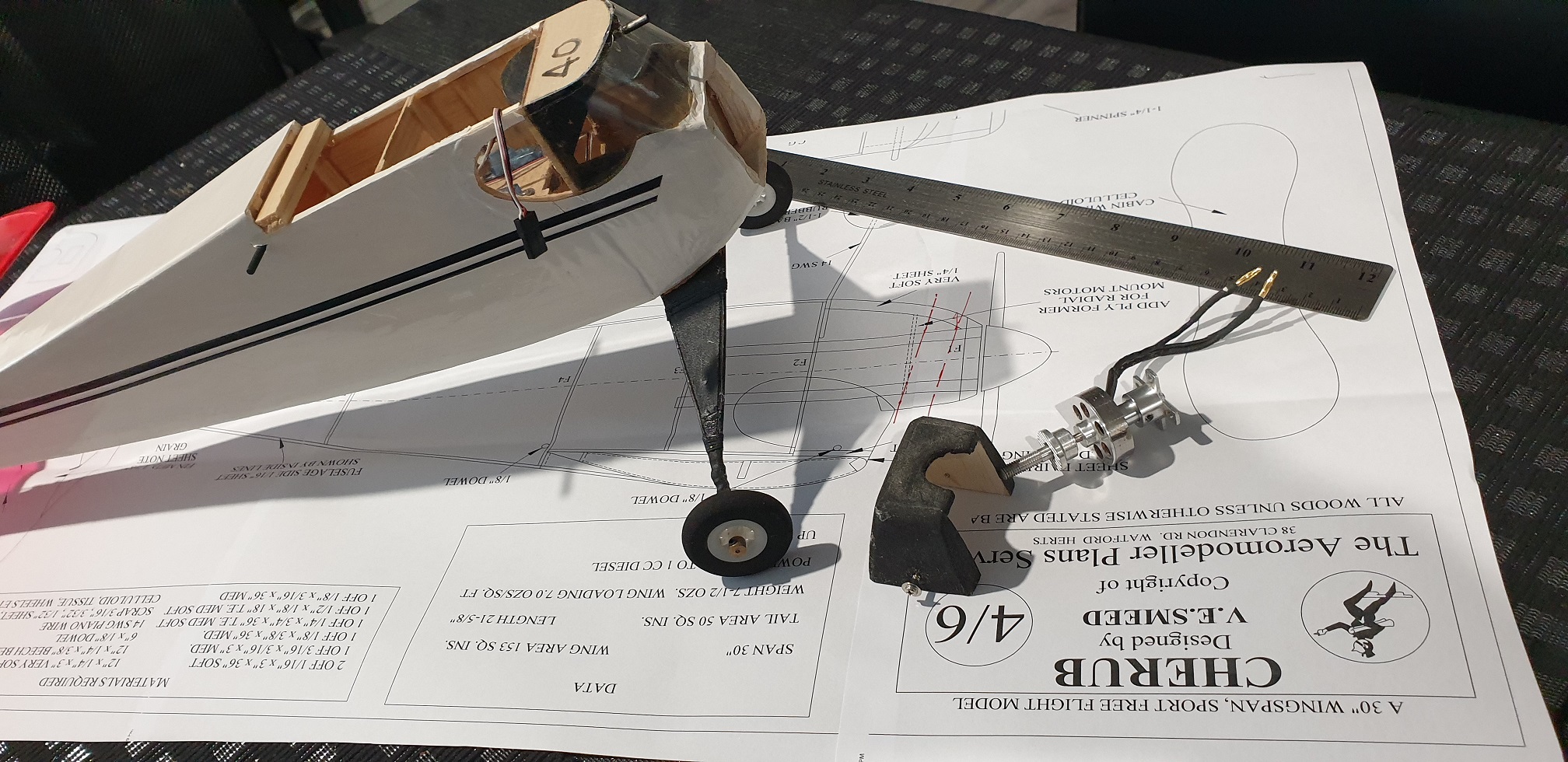

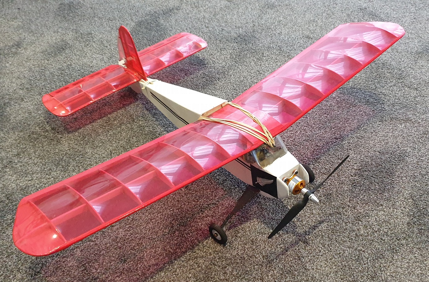

One of our Club members was having a clean out recently, so I was fortunate to aquire a model that upon examination, appeared a worthy candidate for S/C conversion. Bernie wasn't sure of the design's origin, it having been a design that at the time had simply appealed to him for 3 channel use.
Anyway, I started searching Vic Smeed designs since the model just had 'that look' about it. It didn't take long on OZ to identify the mystery model as VS's Cherub. First 'mystery' solved!! 8-)

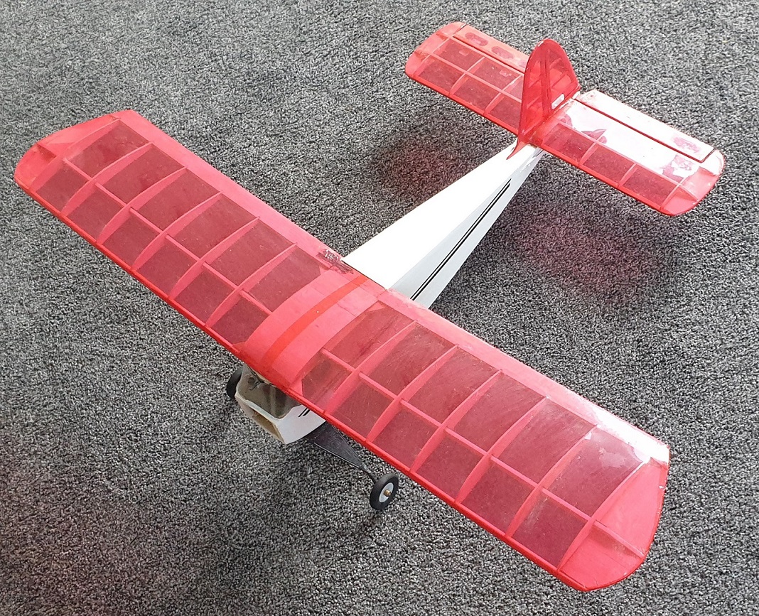

"Cherub" as obtained, but with as-built nose squared off
original motor & cowl, but with as-built nose squared off. Note the packer at the wing TE.

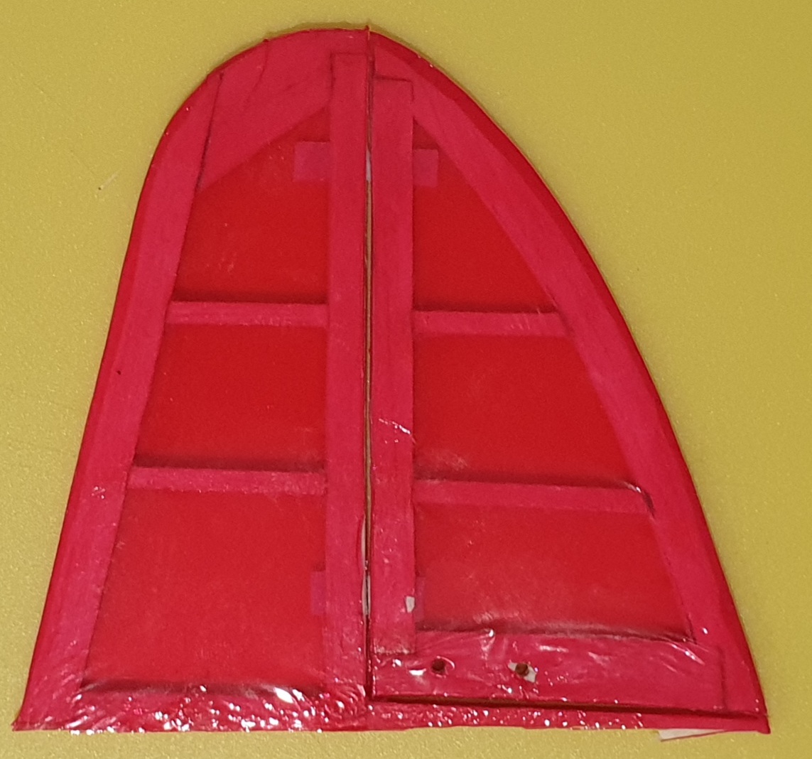

Second 'mystery' was to identify the extent of Bernie's departures from the original F/F design.

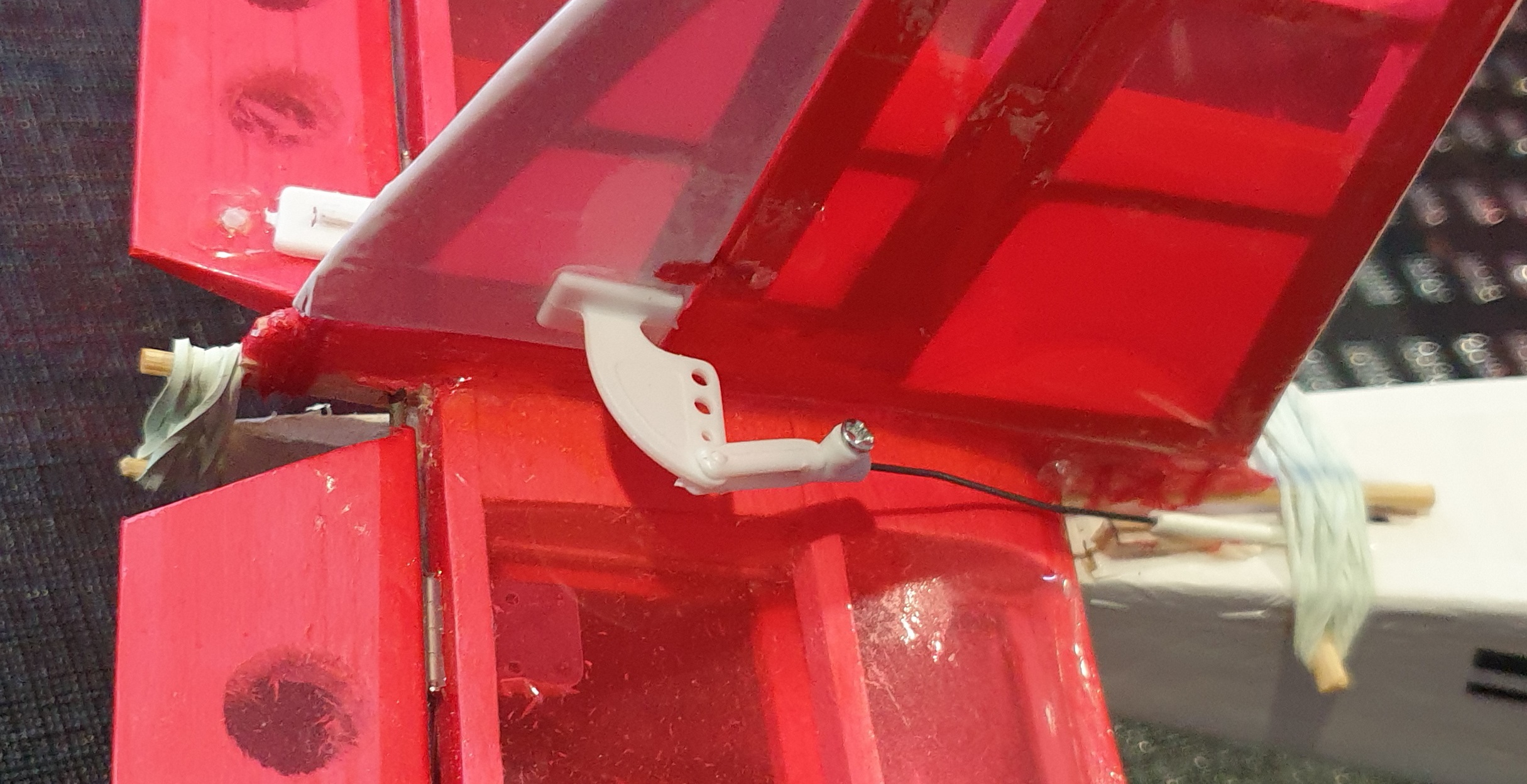

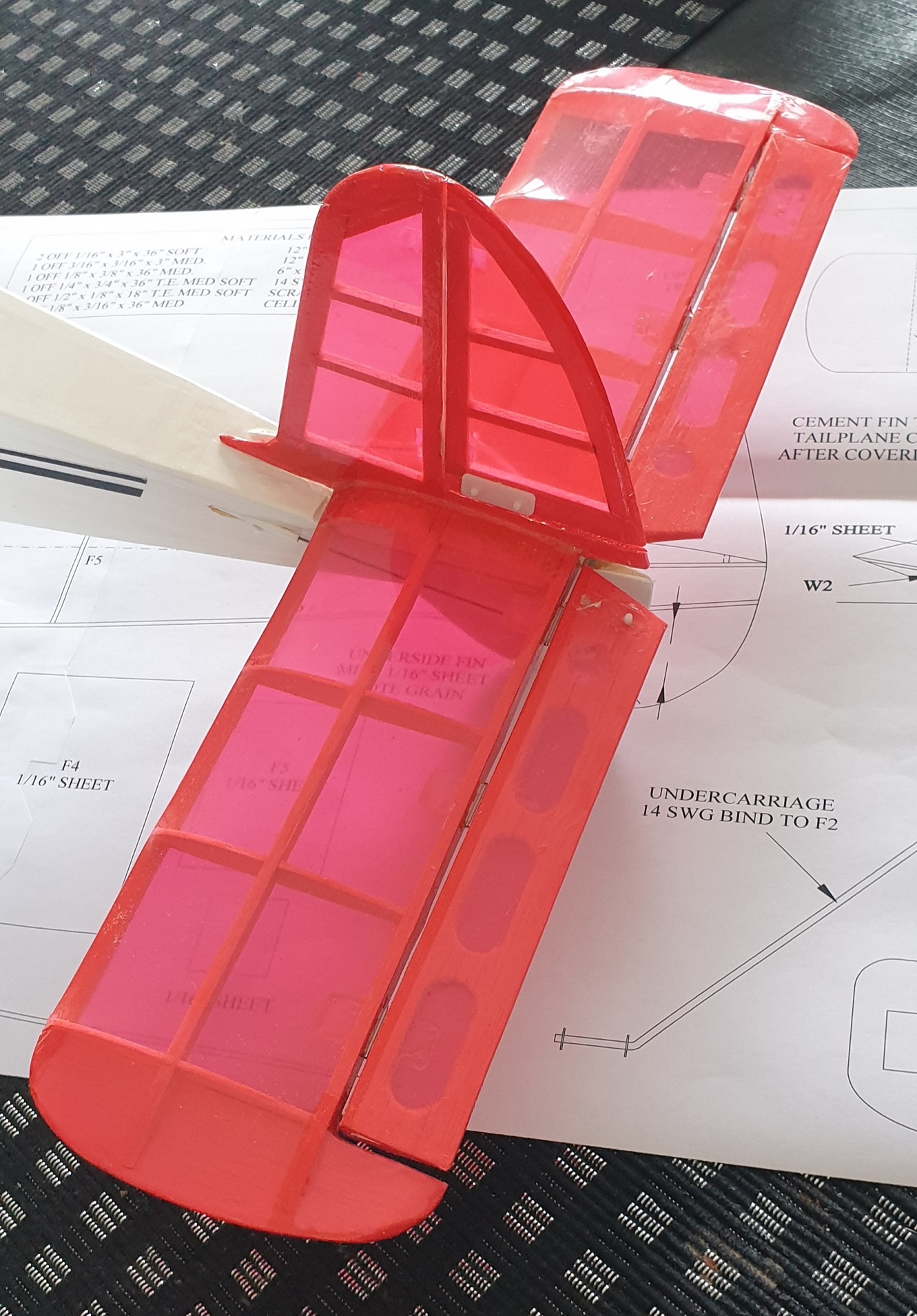

  • Rudder & elevator control surfaces were obvious. But as built, the rudder in particular, was huge, being >50% of the fin area. Probably not so bad for full propo & adjustable travel but far too big for bang-bang S/C :x . Not surprising that Bernie said it had been a "bit of a handful". Fortunately, my Mule II.4 tx with Martin's terrific encoder has adjustable throws.

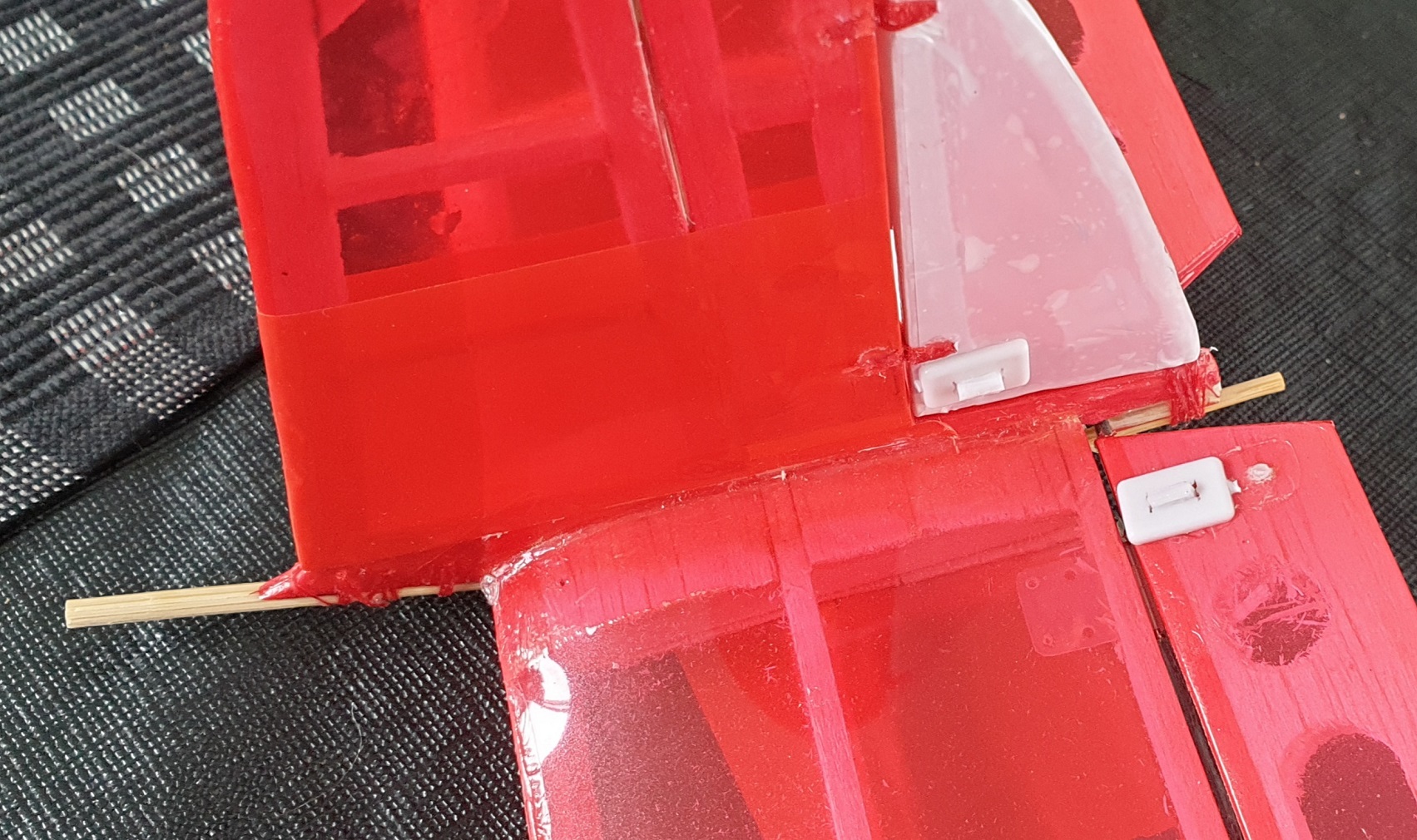

  • Another control problem was the default control surface throw of +/- 45 degs. Moving the connections at the servo to the innermost holes and to the outermost holes on the control surface horns significantly reduced the rudder & elevator deflections, but the throws are still excessive for S/C. Adjustable throws will have to handle any further reduction, as I don't have any longer control horns :( and home-made horns would need to be of a length that they would be prone to breakage :cry:

  • As received, the nose had been changed to try and get the motor, and hence the CG forward. Bernie had even turned up a heavy brass prop nut, about 2-3 times larger than the normal ali spinner-nut.

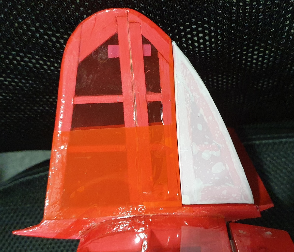

  • Fin + rudder surgery to increase the fixed fin area by reducing the rudder size

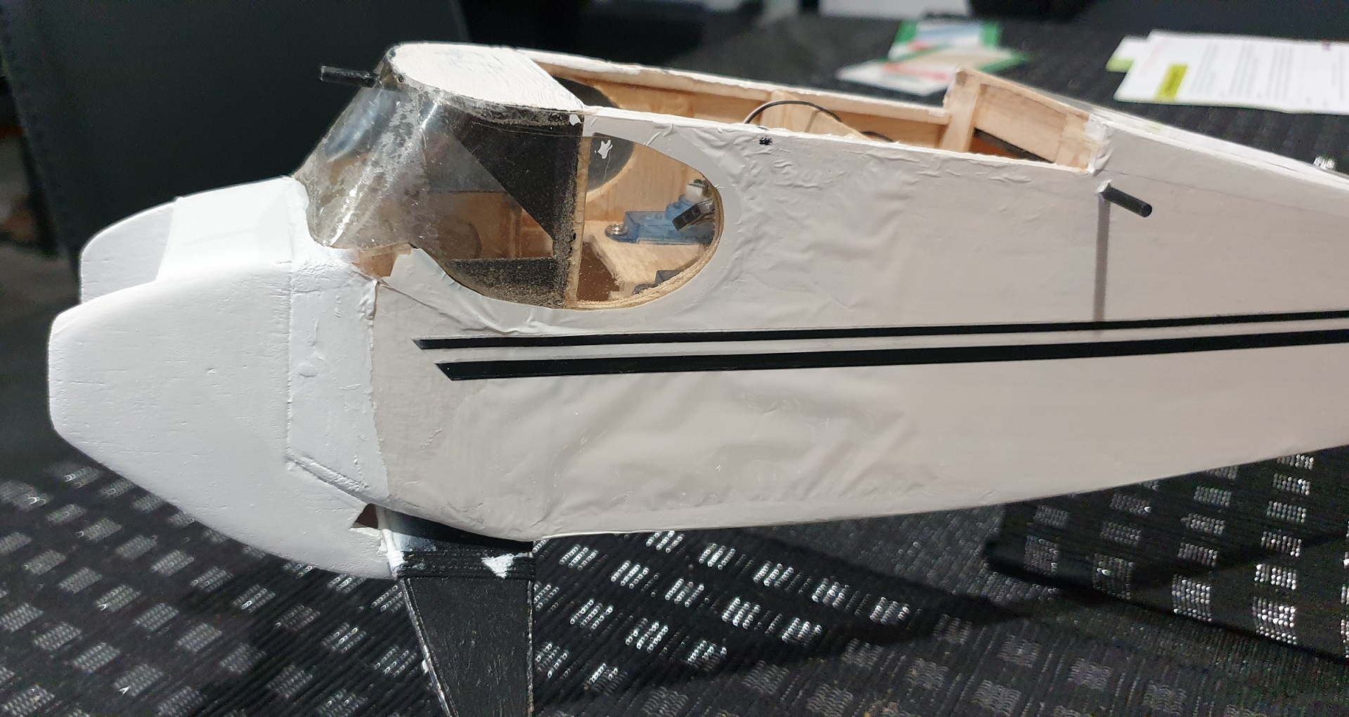

Nose Job

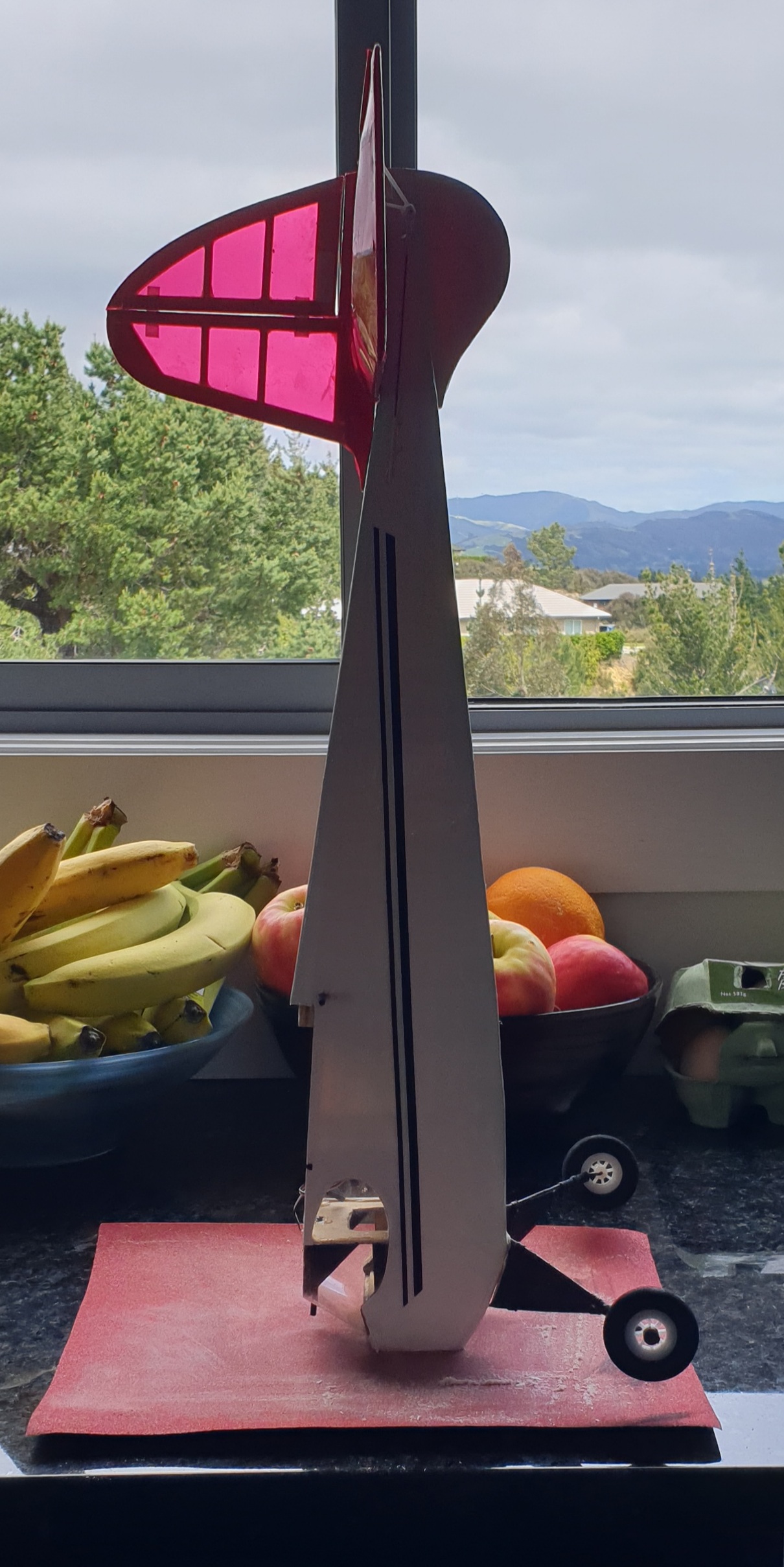

I utilised some "bush engineering" to graft on a new nose. First, I removed the packer block & original motor mount and cut off the angled fuse sides just in front of the canopy where there was extra thickness from the original doublers. I then squared off the fuselage sides by placing the fuselage nose-down on a sheet of sandpaper on the kitchen bench, alternately sanding and periodically checking squareness by eyeing the fuselage off against the window frame. When satisfied with the squareness, I then traced around the fuse onto a printout of the plan, then drew up two new nose sides incorporating a 15mm longer nose (measured to the back of the motor firewall) as well as a little side and down thrust.
before adding the new nose
Using the tracing, I then cut out new sides and doublers and the new firewall. The new sides were glued to the squared-off fuse, then the firewall added. After checking the alignment, top & bottom sheeting was added. When dry, everything was sanded, sealed & painted white to match the existing plastic covering.

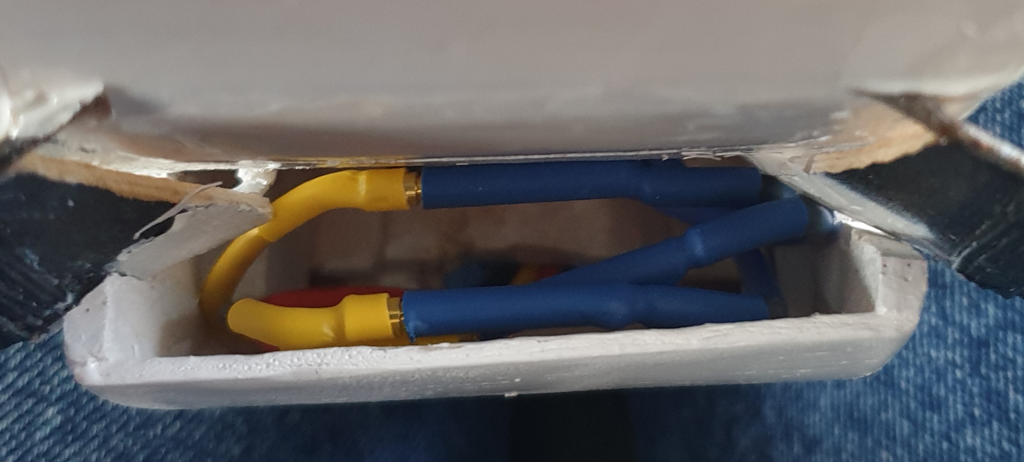

cooling outlet & access to motor connectors

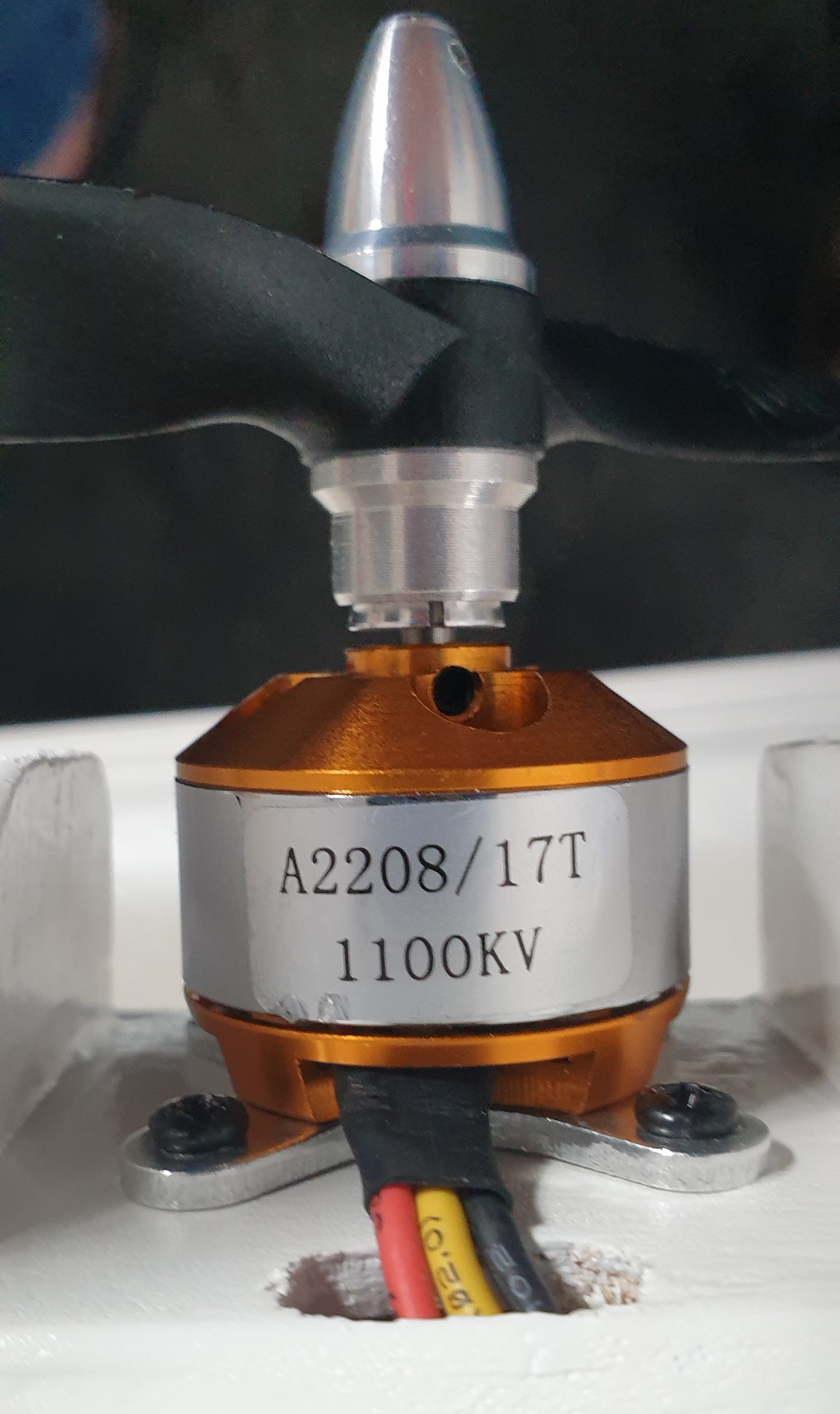

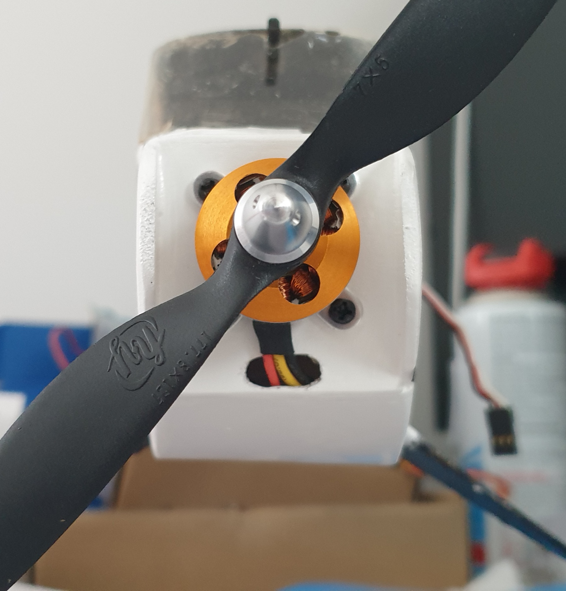

Motor
I swapped the original motor to a 2208 1100kv out-runner, slightly heavier than the original motor but with better torque on 2 cells.
if I still need to move the CG further forward, I'll probably replace the 2208 with a 2212

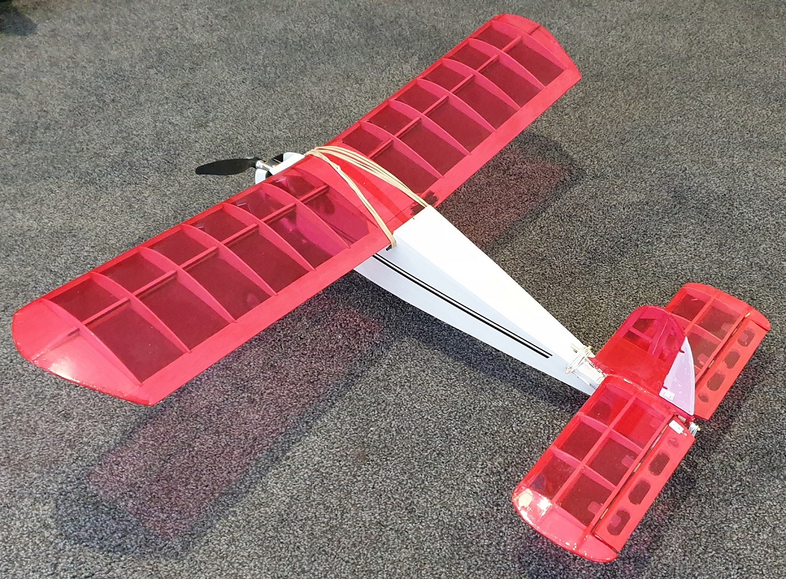

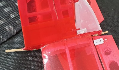

Tailplane
Since I don't have any covering film (other than doculam) or a covering iron with me, my options for fixing(?) the tailplane were limited.
- A new flat t/plane, out of either foam or balsa, would need covering (coloured tape or doculam)
- a foam t/plane would be heavier than the existing t/plane. Even an extra 5 gms presented challenges.

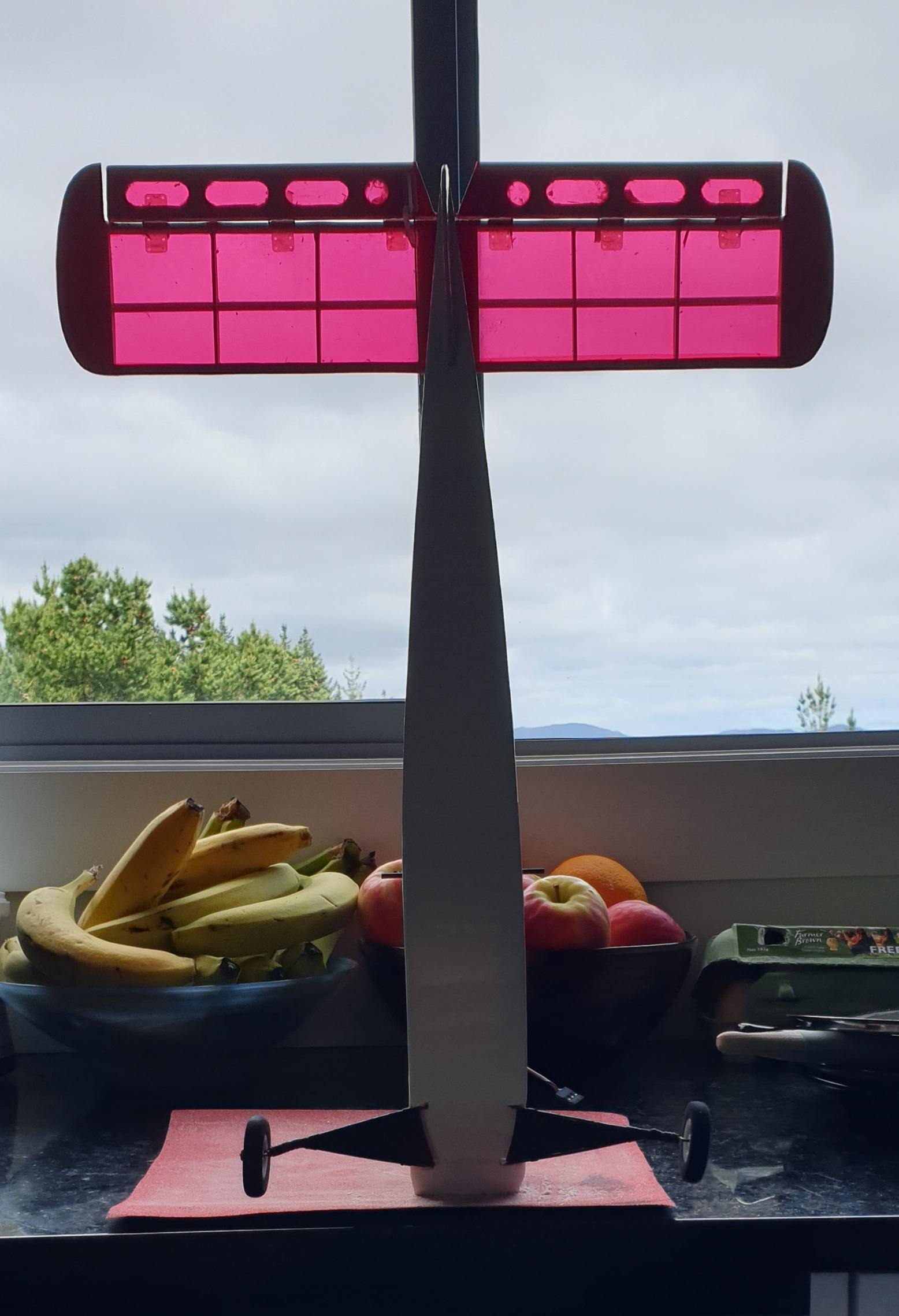

In the end, I opted to add a 3mm thick subspar under the existing spar and a 1.2mm subspar at the LE. Balsa sheet was added between the 3mm under-spar & TE, then sanded to provide full seating for the tailplane at the altered incidence. Once the rest of the underside was sanded & covered, it made a crude semi-symmetrical section. The clear doculam still gives the appearance of coloured semi-transparent solarfilm with the original covering on the underside still visible. Dowels were added front & back to allow attachment by rubber bands, and ultimately, shipping back to Aus when my NZ gig is finished.
Dowels were added to the fuse to rubber band down the tailplane.

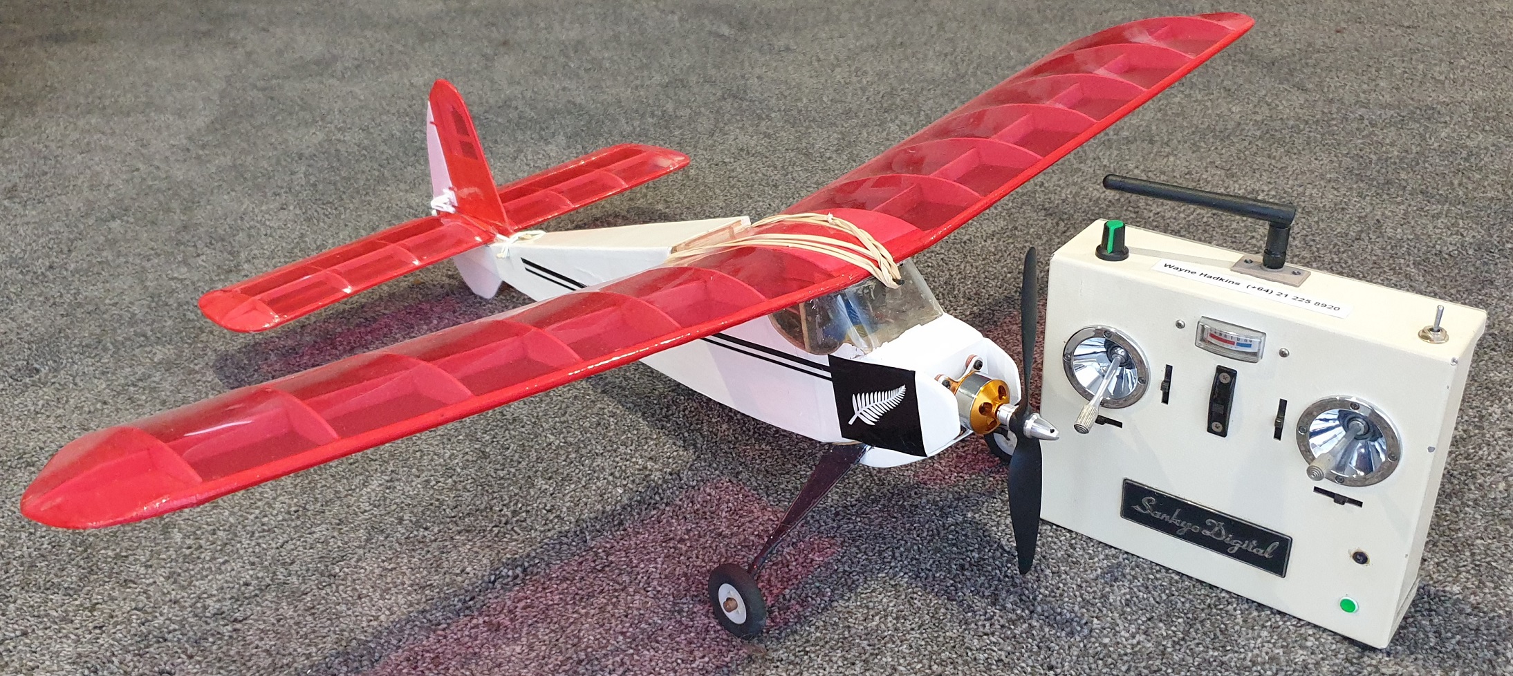

The CG came out about 5mm ahead of the original position (but still about 5mm behind where I was aiming for :( ). Initially, the Tx I've set the Cherub up with is the Sankyo Tx I converted a few months back (viewtopic.php?p=11749#p11749).
Now that it is finished, all I need are the weather and time planets to align :P

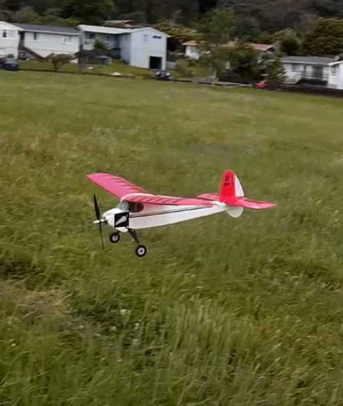

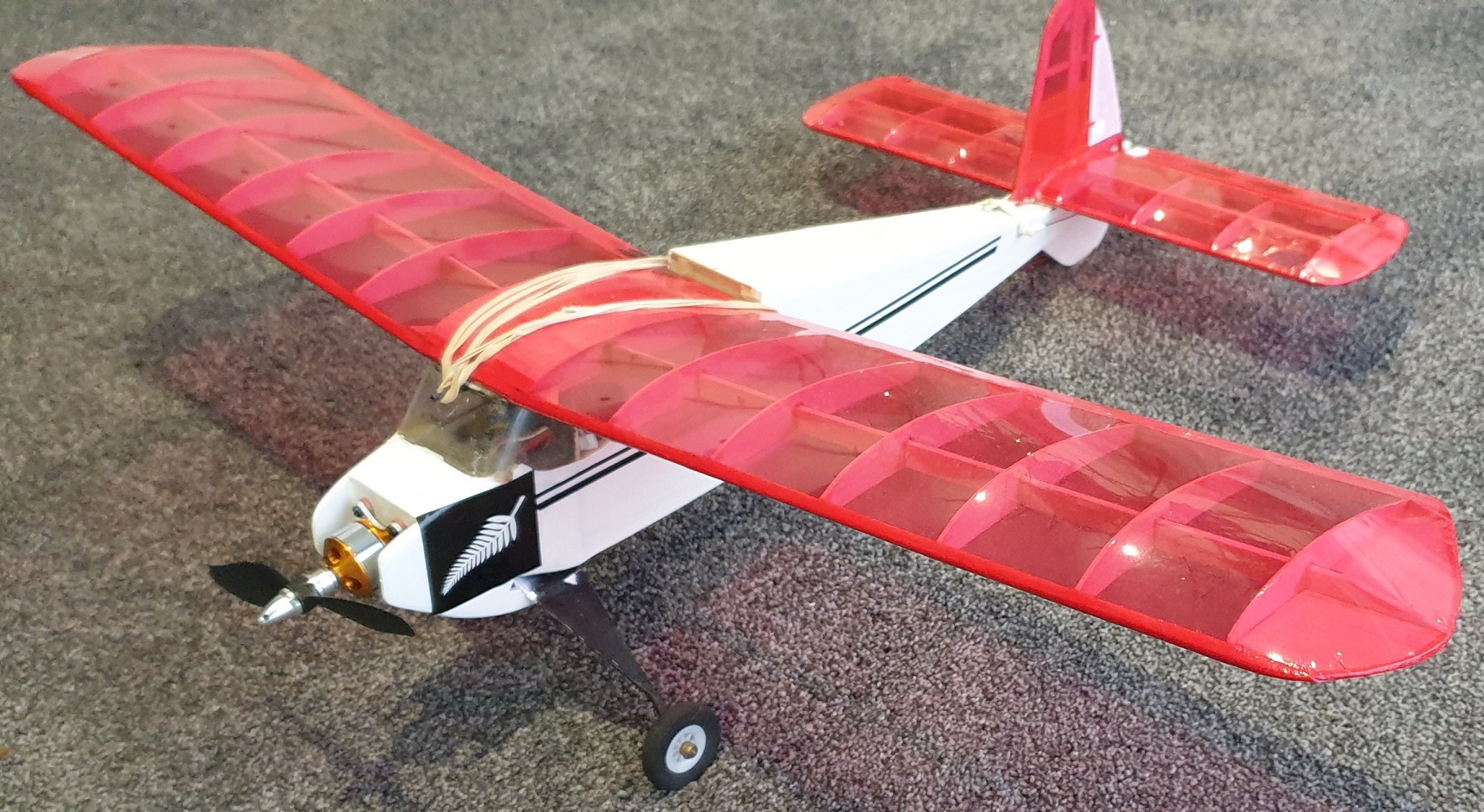

Finally got to test fly the Cherub today.
The weather was overcast & breezy with passing rain. Plenty of power from the 2208/1100kv - the Cherub doddles around very nicely at less than 1/2 throttle :)
It needs the CG moved further forward and some more rudder throw, but it's almost there.
Video is up on da tube -
I had to mute the sound, as I was holding the mobius camera in my mouth :cry: and my breathing sounded like I was about to expire......... :lol:
