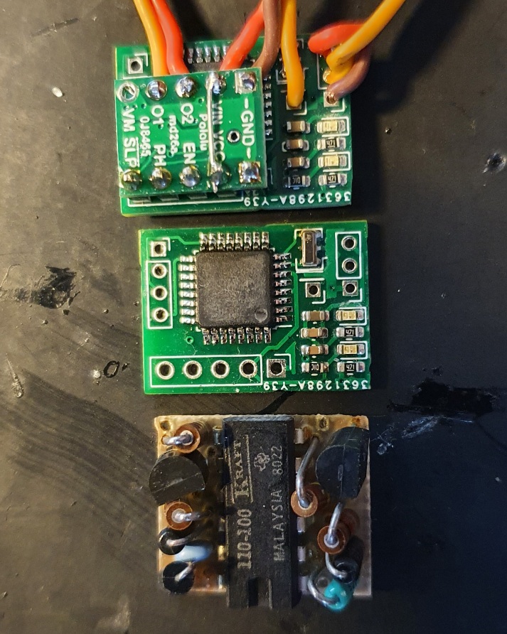

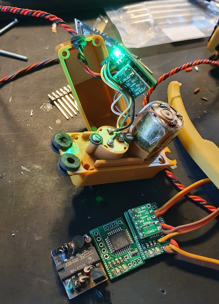

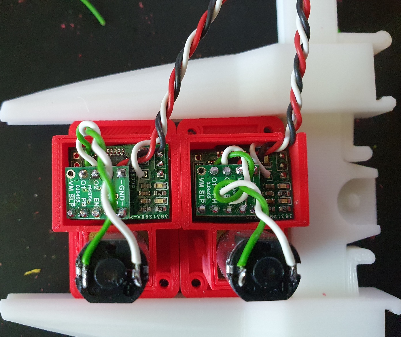

I have been playing with the idea to retrofit old servos with a modern amplifier so they will just look old but the soul would be up to the standards of today.
So I have updated on old faithful Kraft kPS-14 servo
What you see in the picture is an old Kraft KP14 amp compared to the new test unit which eventually will use a DRV8837 directly soldered to the board ad I that configuration I hope to be able to shrink slightly more.
As processor I use an ATMega168P
Replacement servo amplifier

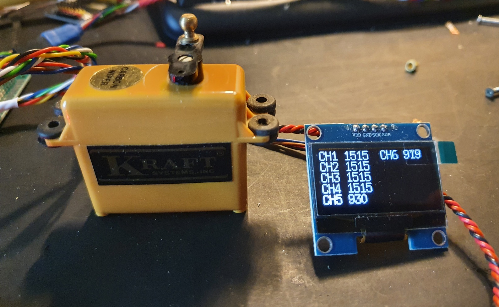

This shows what have come up with this little exercise:
Maxi/MiniPelle own flight pack with fully proportional servos. ...and a peek inside

Nice project, Tobe, but I have a question: Many older servos used a centre-tapped (4-wire) supply. The motors in these servos were a different impedance to the ones used in later (3-wire) "bridge" amplified servos.
How do you get around the issue of running motors designed for 2.4 volt operation on 4.8 volt (nominal)?
I can think of at least one way of doing it, but it would mean different firmware (or switchable?) for the different motor types. Have you found a way to detect and select automatically?
- Posts: 766
Re: Replacement servo amplifier
Hi Pete
I did the software for Tobe and included pwm on the outputs, so if you have a 4-wire servo, then just set the pwm to 50% duty cycle and you can run it as a 3-wire servo. In fact many of the motors used were rated above 2.4V and the drive voltage to the motors would have been less than 2V allowing for the 0.7V drop of the final drive transistors, so you could actually improve the servo performance from original by running at a slightly higher voltage. As long as the servo has a motor and feedback pot, it should work.
I based the "amp" on an ATMega328P and DRV8838 as they were what I had to hand, but it would easily fit on an ATmega48P or many of the newer ATtiny processors or an alternative motor driver chips like an DRV8835, TB6612FNG, etc.
Cheers Mike
Cheers Mike
- Posts: 477
Thanks for the prompt reply, Mike!
Yes, when I said I could think of one way, I was thinking of the mark-space ratio on the drive output!
One last question: Do you know what the input impedance of the amplifier is? I'm asking because I might renovate an old 27 MHz system that used an SCS decoder. These were notoriously fussy about the load placed on them by the amps. I'm guessing that you are going straight into one of the inputs of the processor, in which case that would be very high impedance and suitable for SCS decoders. But its always wise to check...!
- Posts: 766
Hi Pete,
Yes, the ppm signal goes straight into the Atmega input. I'd have to look at a datasheet to confirm, but with the pull-up resistor, I think the input impedance is between 20K to 50K, I'm sure an SCS decoder would cope OK with that. What is the Rx, an RCS, Sprengbrook or similar era?
