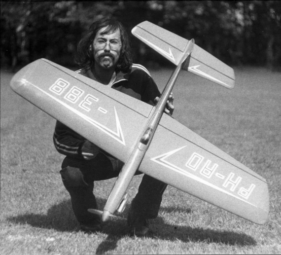

After learning the beginnings of Stunt with the same Webra, I 'progressed' to a similar (yet larger) model, with a Fox 35 that -in turn- ended up in my first Nobler, all about 50 years ago...
I'd just shaved off my beard and cut my hair to shoulder lenght...
By that time I sort of established my own F2B 'house style':
