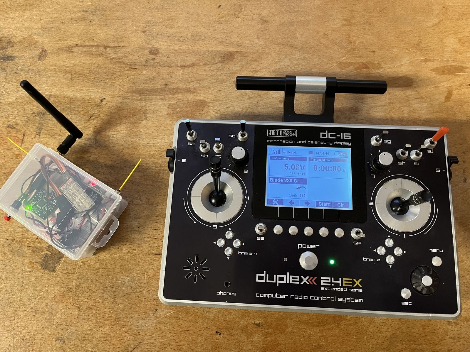

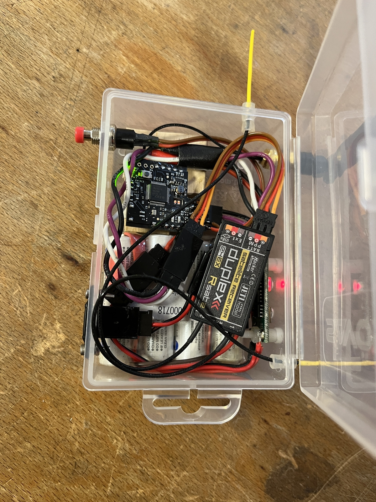

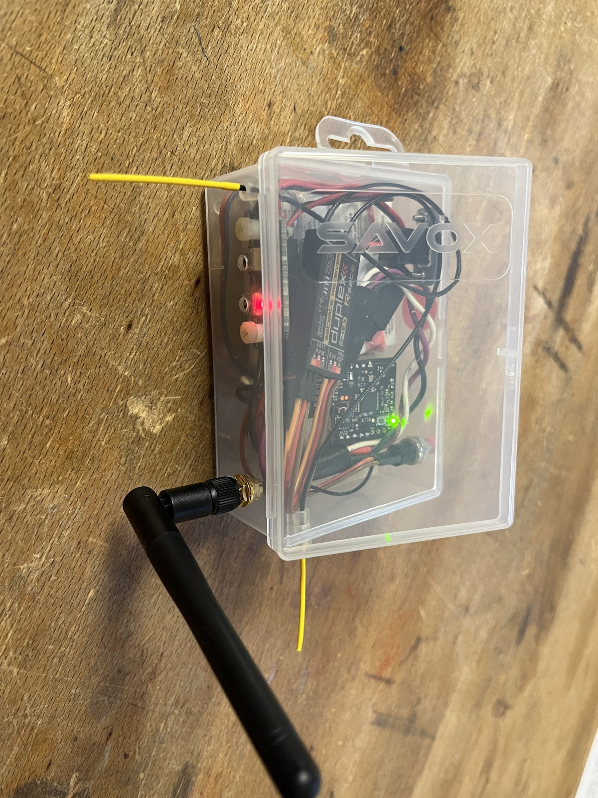

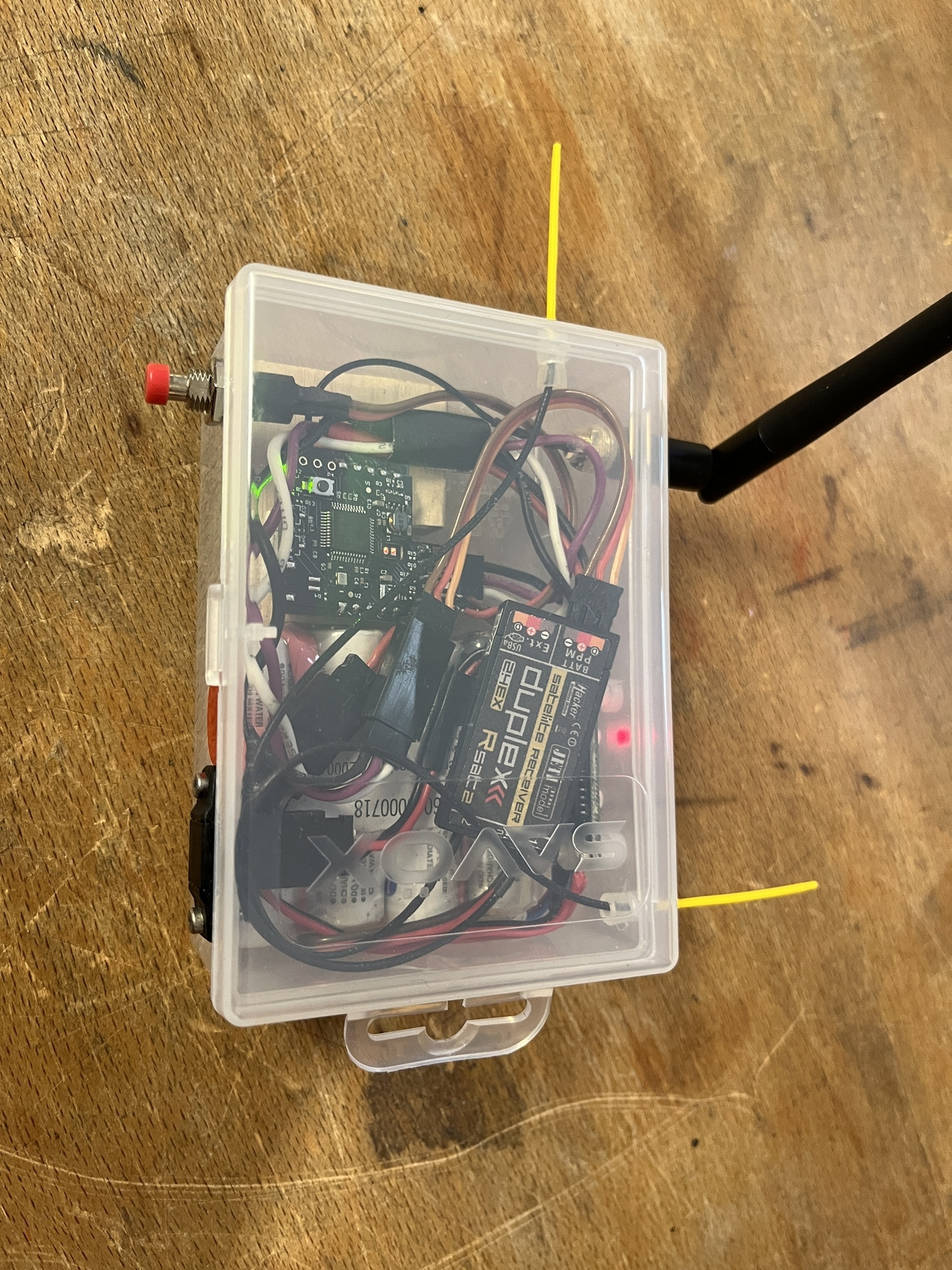

Spekibox to use Jeti Tx with Horizon Indoor models
Jeti RSat2 connected to to LemonRx DIY module.
4 cell Nimh or 2 cell Li ion to power both, install in an old servo box and go fly!
