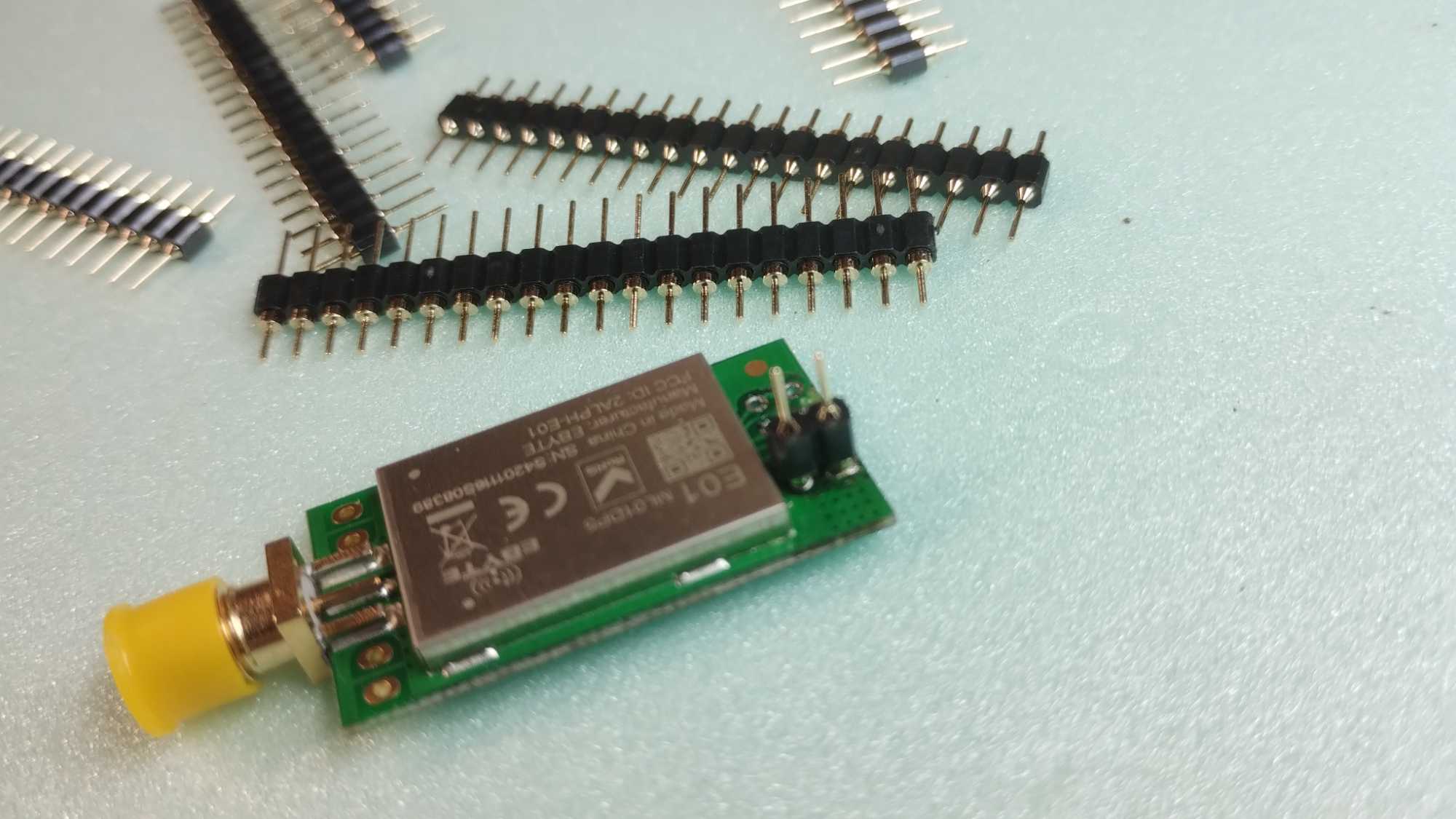

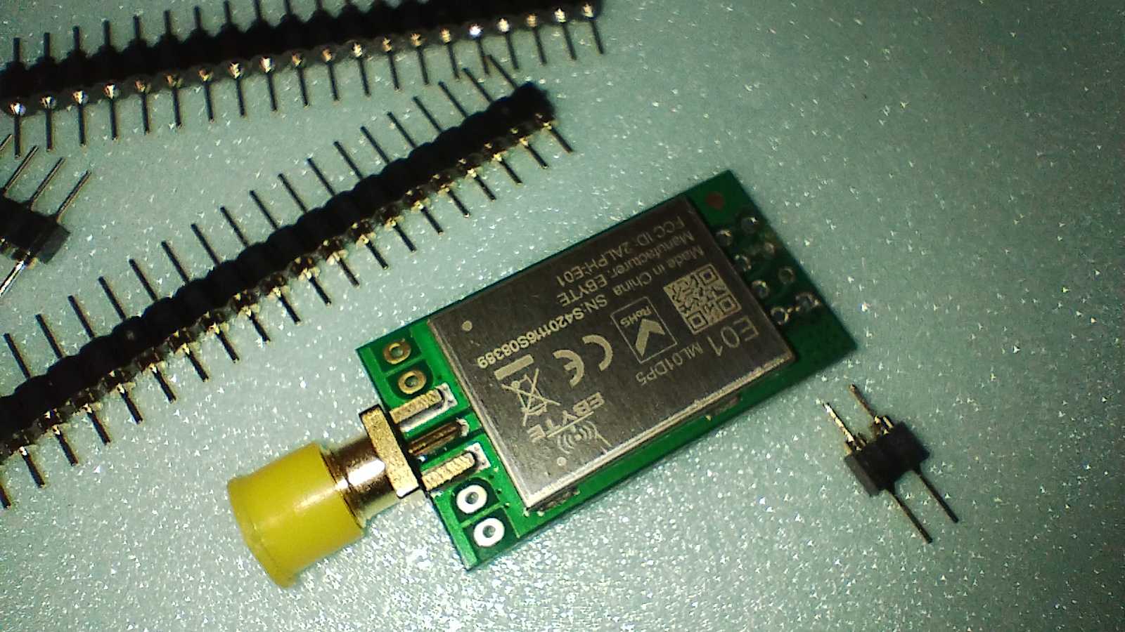

In the FHSS Reeduino thread I suggested an easier way of mounting the 3v3 regulator onto the NRF module, by simply not removing the two power header pins and mounting the regulator on the other side to the can. Shaun did his FHSS Reeduino this way and did find it much easier.
However for some weird aesthetic reason I prefer the regulator on the can side which means removing all the header pins including the power pair.
Of the eight header pins they're the most difficult to remove since the ground-plane sucks the heat away, but it can be done without too much trouble.
Clearing the two power holes of solder so they will accept two pins on the can side is for the same reason more awkward.
However...
For my retro computing projects I use these thinner round header pins, designed to fit turned-pin sockets. Being thinner and round they need much less clearance and so make the task of mounting the regulator can-side much easier:
This how the Kraft 2 is done and I must say it was much easier and quicker. How I wish they would just stop fitting header plugs, also the DIYMore boards are only available pre-soldered with headers now and they're not even soldered straight. Its a real pain & I just wish they wouldnt!

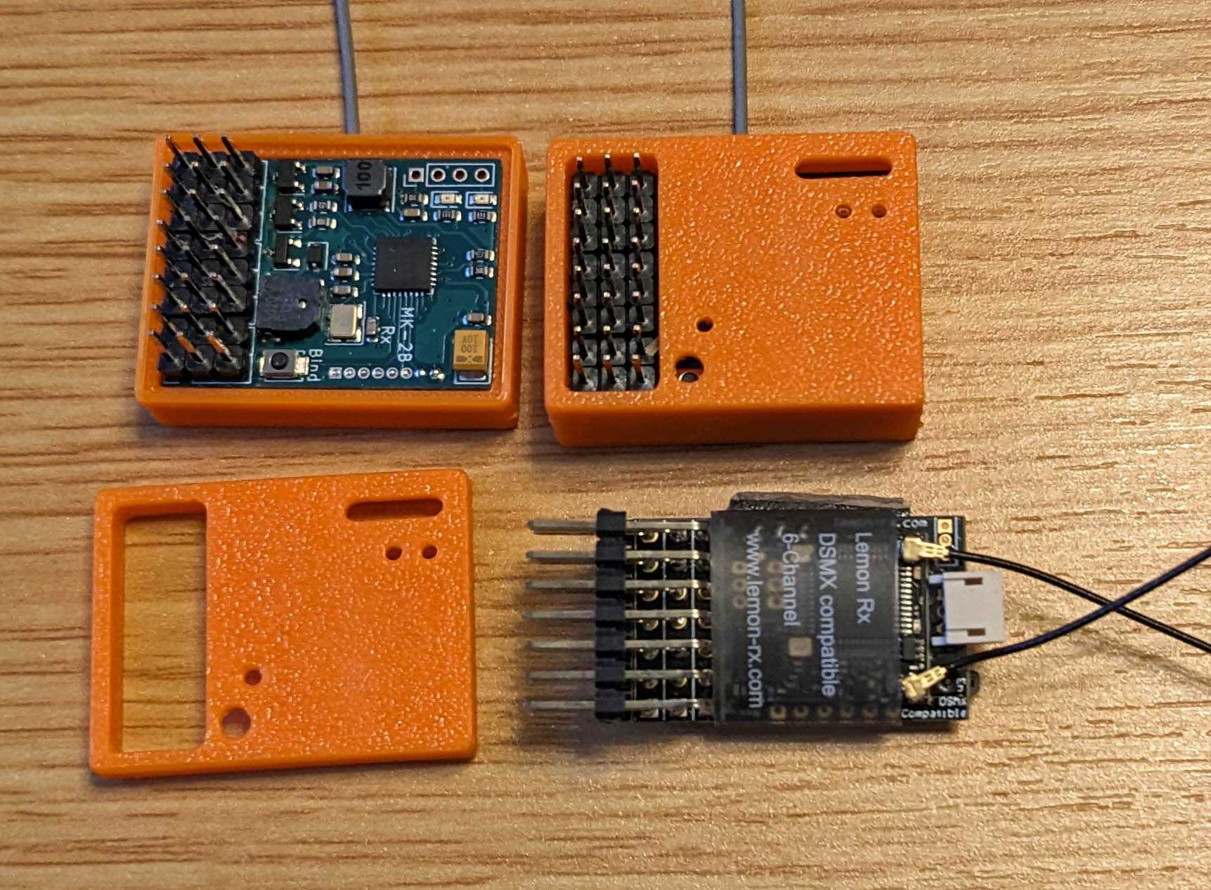

Oh and I nearly forgot Tobe's latest nRF24L01+ based full-range Rx, it has an onboard sounder that alarms on loss of signal (failsafe) or low voltage. The sounder is a diminutive smd 5mmx5mm (the square component just to the right of the servo connectors at the bottom and just above the onboard bind switch). I first used it on one of my forthcoming encoders and Tobe had the brilliant idea of using the same sounder for the Rx. It is an externally driven sounder, you have to switch it at 4KHz, we use TCNT2 in a PWM mode switching a transistor with a reverse/flyback protection diode. It's rated at 80dB @ 1m, the same as the typical round 12mm sounders often used on our projects.
A lost model finder/sounder incorporated into an Rx is probably a first?
I'm certain Tobe will publish more details soon.
