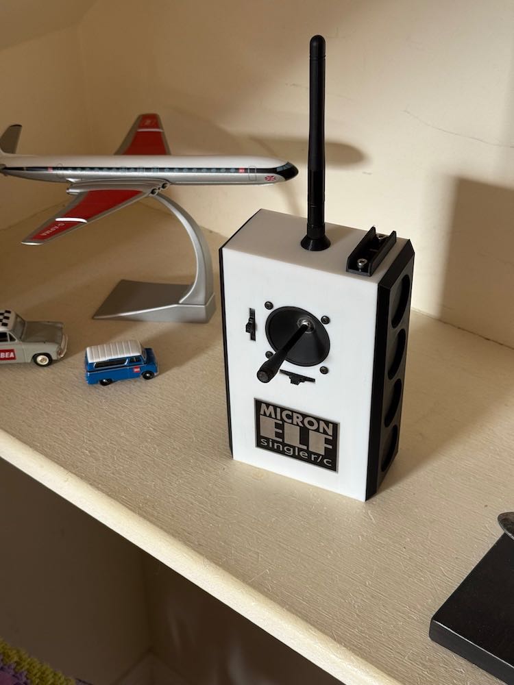

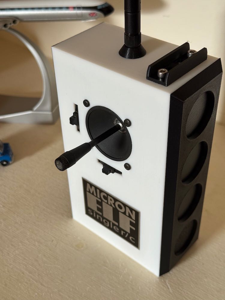

Here's my rendition of what a 2 channel elf may have looked like.
3d printed case of same proportions as the single channel set apart from its slightly wider at 80mm. This is to accommodate the bigger 2 channel stick unit. Laser engraved aluminium label/badge. Ive also incorporated a 3 pin JST charging socket in the left side cheek. Electronics access is through the removable side panels.
NRF & Arduino nano for the electronics. Stick unit is from an old 27mhz Sanwa 4 channel set (Thanks Shaun).
This makes a lovely very usable 2 function set with trims, perfect for a retro glider.

Another great set, where do you find the time Ron?
I do like to that generation of Sanwa sticks though. Great action and perfect spring tension....well for me.
