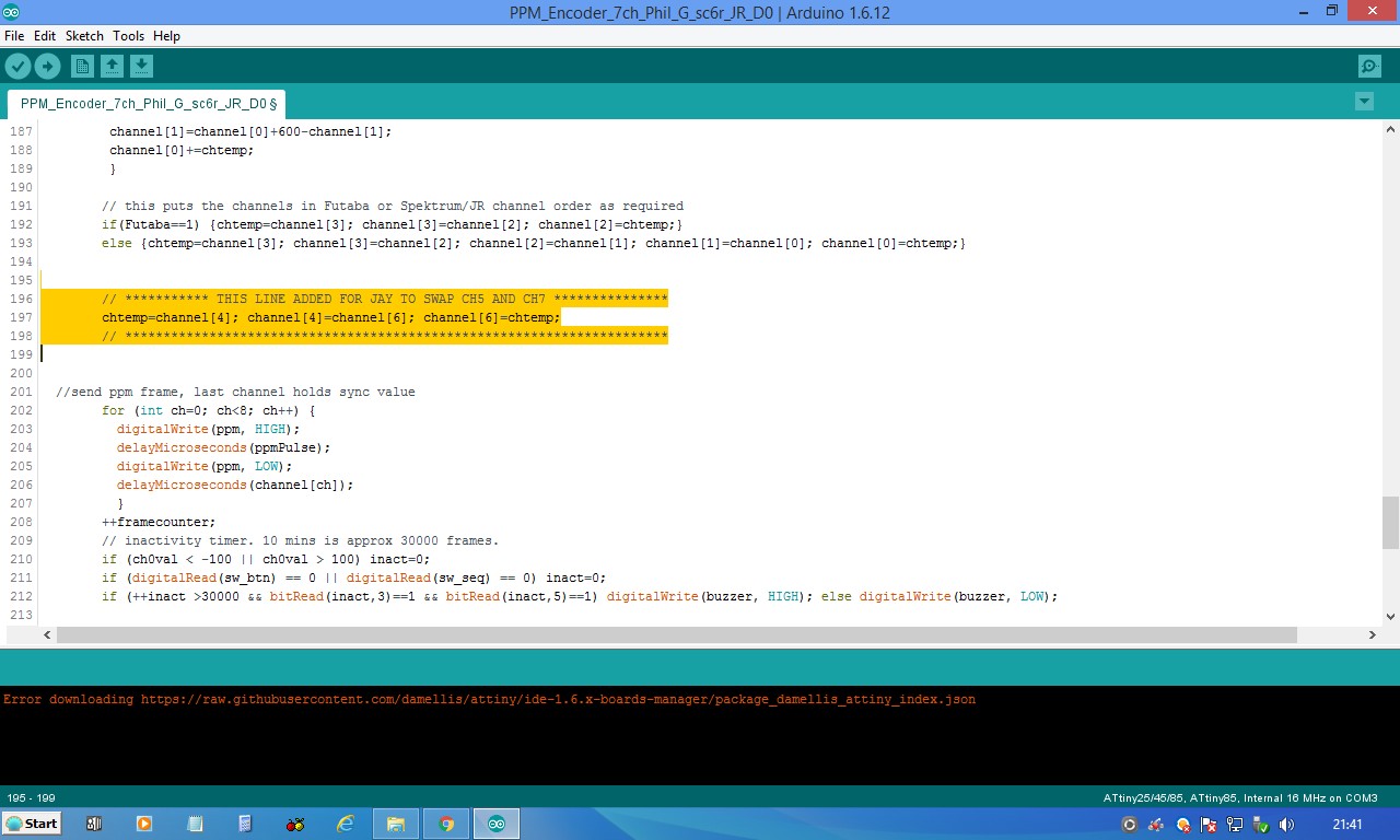

Not tried it but this should do it Jay.
Remember the channel array starts at zero so channel[0] in the array is throttle (rx ch1),
channel[1] in the array is aileron (rx ch2), channel[2] in the array is elevator (rx ch3) etc etc
so channel[4] in the array is rx channel 5 (gear, ie the 'slow' toggle) and then channel[5] and
channel[6] in the array are the two 'aux' channels on rx ch6 & ch7.
I think it might be a good idea to make this a permanent change for JR/Spektrum channel order,
so it would be Throttle, Aileron, Elevator, Rudder, the 'slow' toggle switch, aux1 then aux2.
Futaba channel order stays as is. Does that sound sensible (I'm not a Spekky user) ???

I assume I must cut and paste the yellow highlighted text in the sketch you posted above into your existing sketch, correct?
