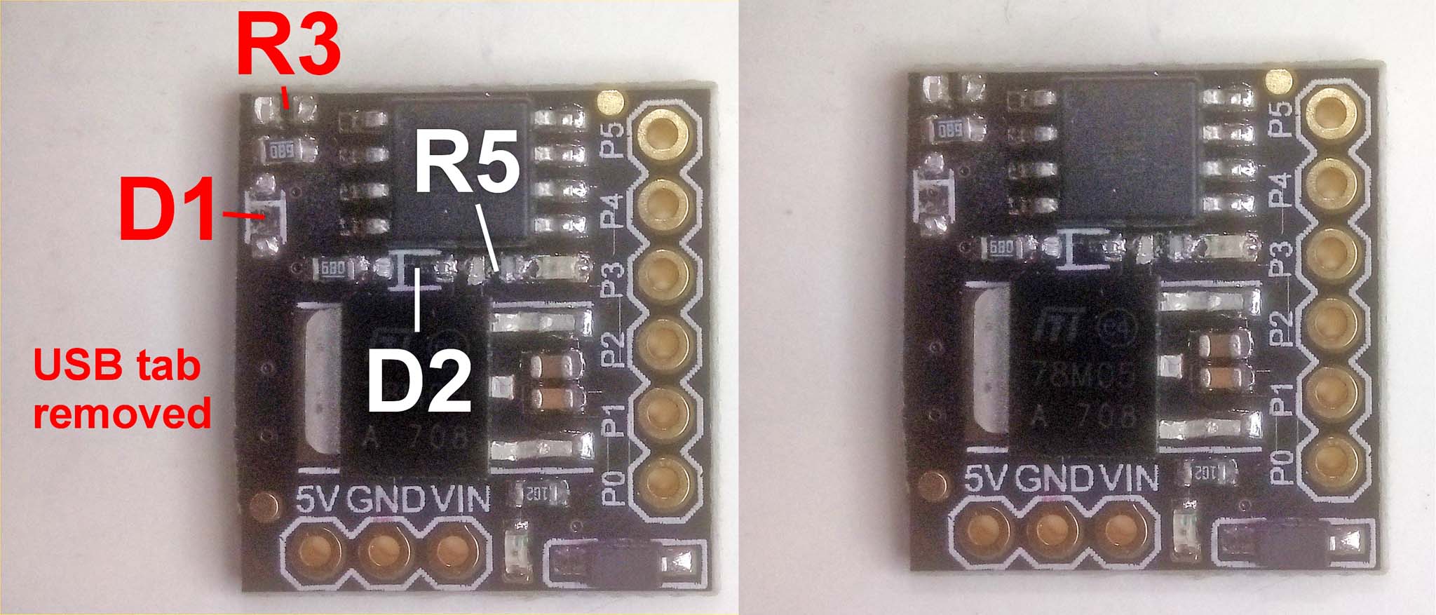

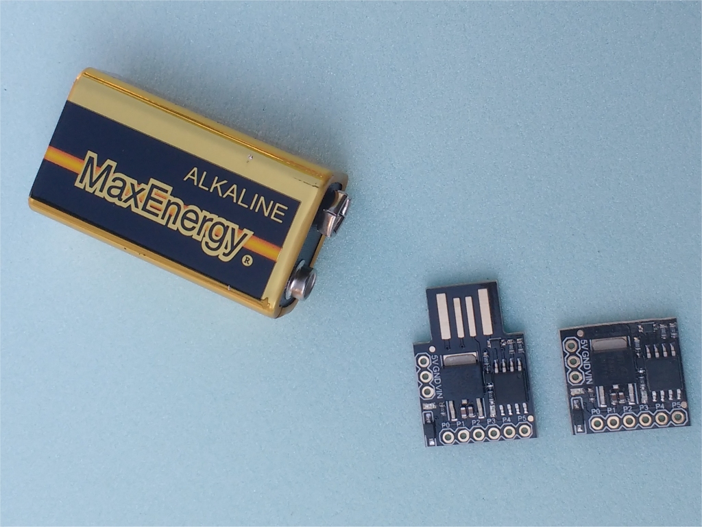

I've done a full 4-channel propo encoder for the DigiSpark. This is a tiny (3/4" square) cheap & cheerful board that works really well, but only has 5 I/O pins as supplied. Some of the 5 DigiSpark pins have USB circuitry which we need to remove as it affects the linearity when those pins are used for joystick inputs - its just four components - two zener diodes, a pull-up resistor, and an LED ballast resistor (or the led, removing either will do). Since the board is all SMT this is easily done by 'flicking' off the unwanted components with a jewellers screwdriver.
This is all covered in some detail in the DigiSpark thread. It sounds much more fiddly than it actually is - in fact it takes a couple of seconds to remove the four components:
We need four joystick inputs, a calibrate link or button input, and a PPM output, so having freed up all 5 pins, we need one more. The reset pin P5 has a dual purpose, controlled by an internal 'fuse'. Its function can be 'reset' as required for programming, or it can be another I/O pin which is what we need. The DigiSpark fuse programmer makes this change easy peasy.
Now we have 6 pins, allocated as follows:

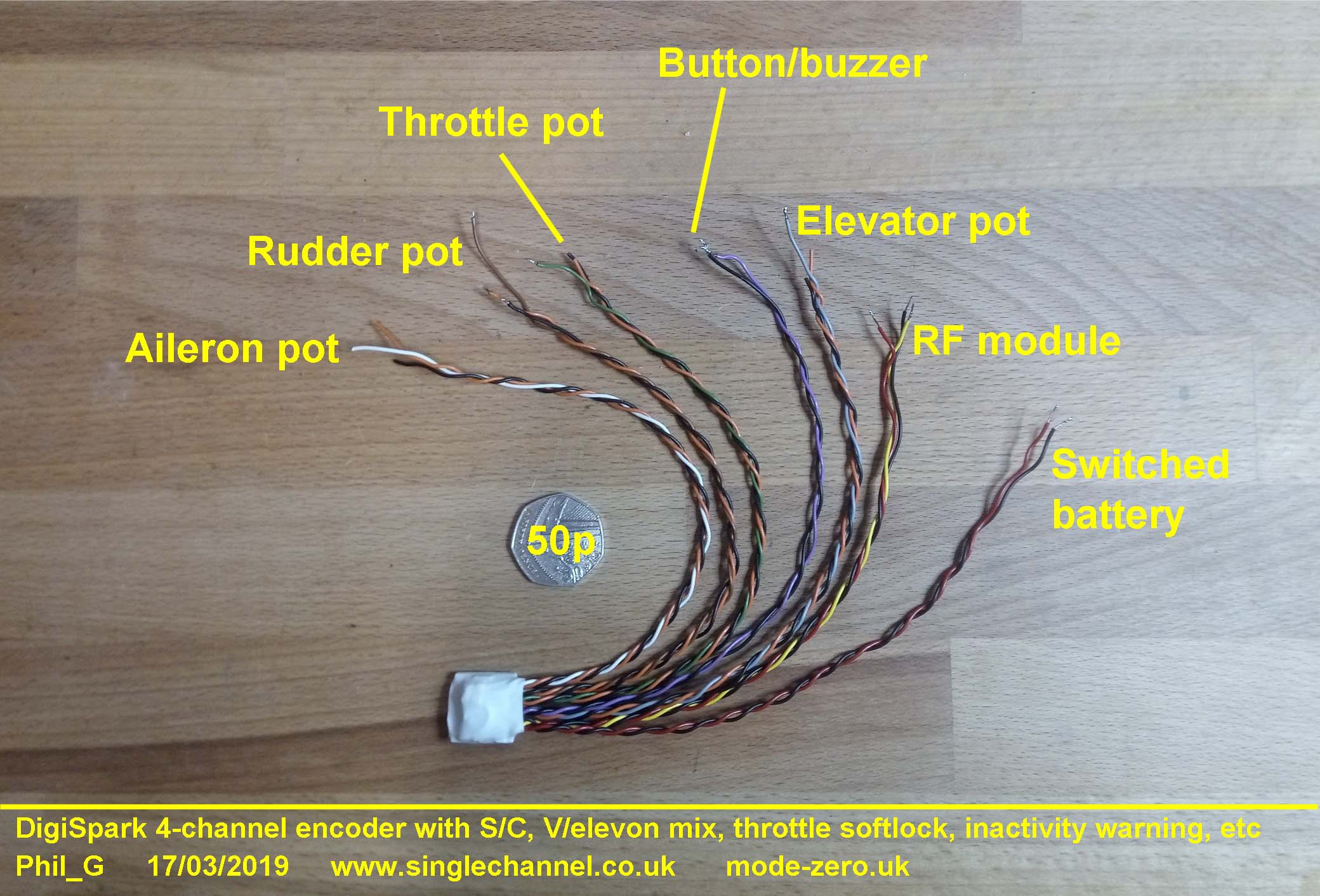

Quite a few people are using this encoder in their retro 4-channel sets now, if anyone wants a ready-to-fit encoder I can supply them programmed, prewired & heatshrunk. Just one pointer, if the throttle lock holds at the 'open' position (ie at the 2ms end of travel) then the throttle pot outer wires need swapping over, thats the +5 and neg. Its a safety thing for electric flyers.

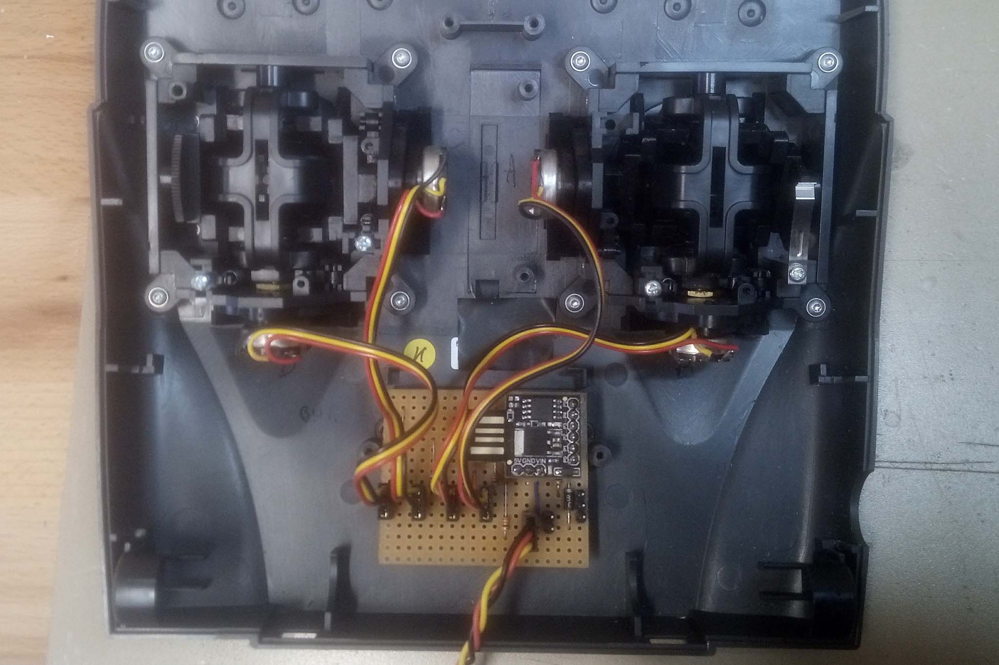

I've done a few of the DigiSpark 4ch encoders myself, this is one of the testers which for convenience is mounted on a vero backplane, fitted into a Multiplex Pico. I've left the usb tab on this one, normally I saw it off. (It always amuses me to see the tiny 3/4" square board lost inside a transmitter!)

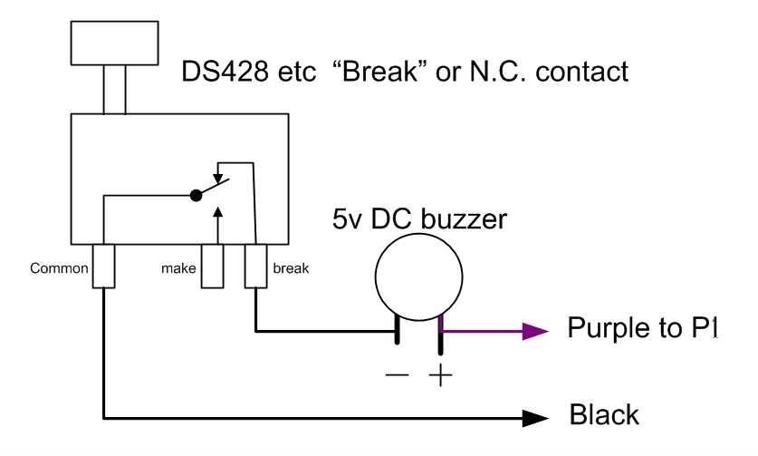

Its obvious that for sponge-brains like me an inactivity alarm is essential. We dont have any spare pins for a buzzer, so I've multiplexed the button input, which is now used for calibration, S/C emulation, and the inactivity alarm.
We use the usual 5v DC buzzer with its negative tag (the short leg) to wired to battery negative via the S/C button, and its long leg (pos) wired to P1. Please note that he S/C button now has to be a 'break' contact:
To convert from the previous arrangement, remove the purple wire from the button 'make' contact, connect purple to the buzzer pos, and connect the buzzer neg back to the button 'break' tag. The button 'common' is the black wire. The buzzer could be soldered directly onto the microswitch tag to save wires.
The diagram makes it clear (I hope!)

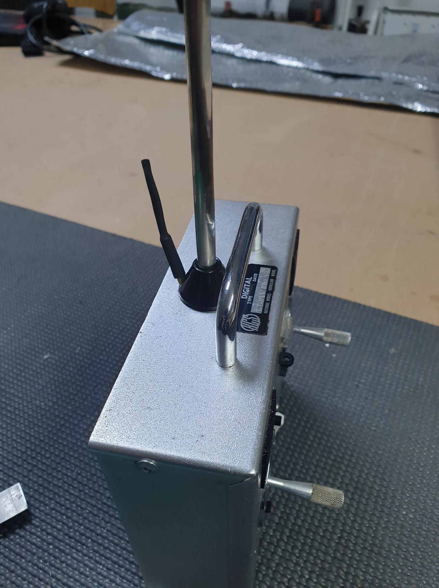

Built a Digispark driven/ LemonRx DIY module powered RCS Digifour for my old friend John Greenfield, who is loving flying his Junior 81 3/4 around at the Phoenix Club near St Albans next to the M25...John says thanks, Phil!
