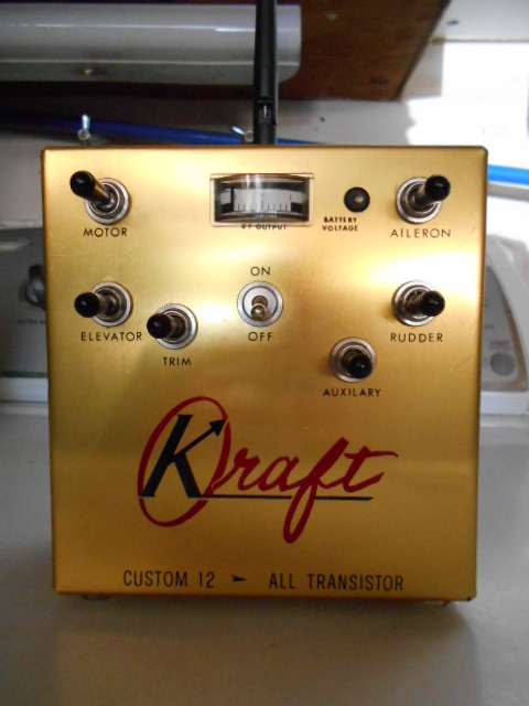

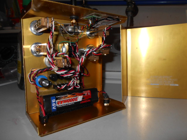

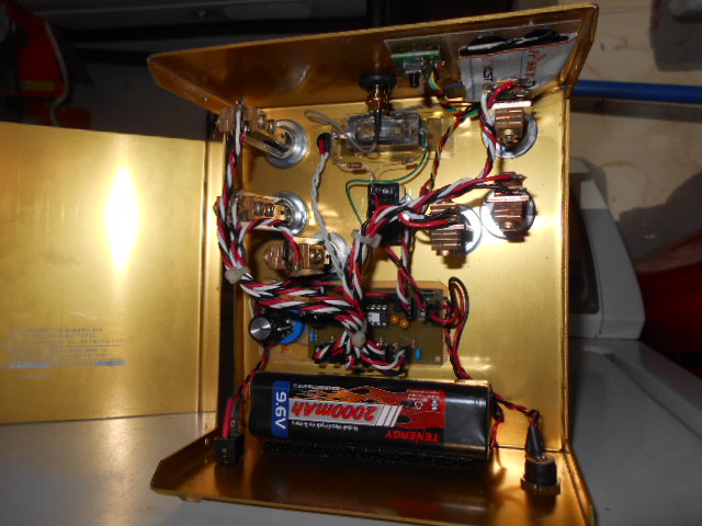

Here is conversion using a Phil G reed emulator and a FrSky (both are Phils favorites) The radio works flawlessly, took me about 6 hours to do the conversion. Battery test button was replaced with a power on LED, RF output meter was converted to a battery meter, charge jack was added to the bottom of the case. The servo speed control works really well. You get servo reversing and trim on all channels, very nice. I understand Phil has a micro controller now he calls a reeduino to replace the reed emulator.
