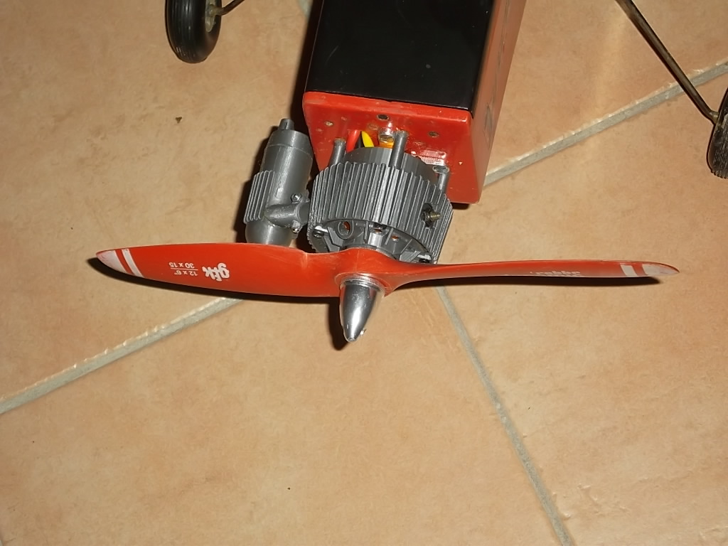

In my dummy engine, I used the muffler files and the outer cooling ring files from this source.
All the inner parts like the inner cooling ring and the front plate I had to draw myself using OpenSCAD to provide room for the electric motor.

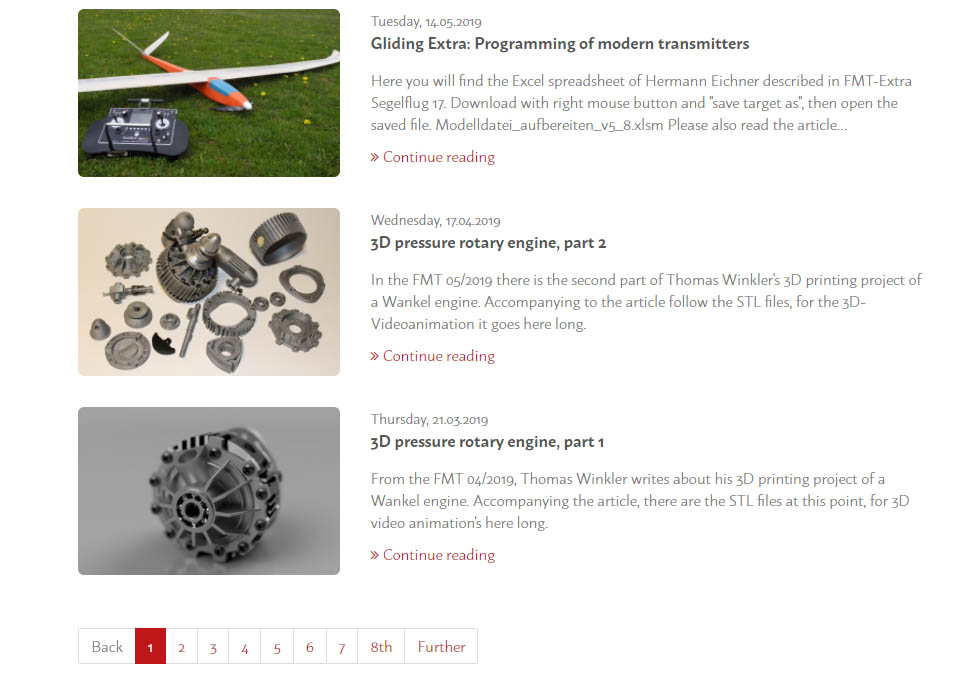

The FMT files you can find here:
https://www.vth.de/fmt/cad-bibliothek

To make it easier for non-german speaking friends:
You need to download the data from the german magazin FMT as published in the thread. They are called
3-D-Druck-Wankelmotor, Teil 1, ....,Teil 2, and ....,Teil 3.
This three big downloads enable you to print a complete 1:1 scale Wankel engine. For the dummy engine only four parts out of the big number of parts are used.

I used a C4250 typ brushless motor, about 600kv, turning a 12x6 prop on 4s Lipo. It provides more power than a 40 or 45 size IC engine. A 4000mAH Lipo is good for over 15 minutes flying time.

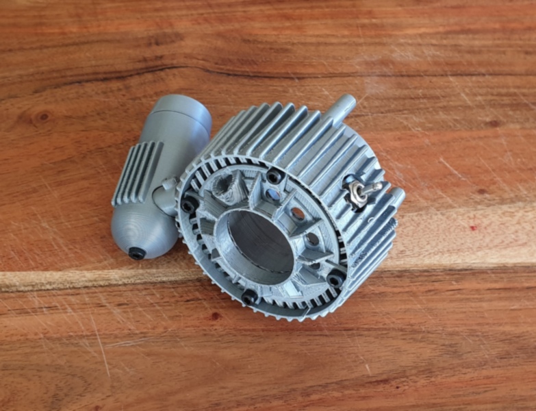

Hi Frank,
Engine printed, just need a model to use it with.
Thanks for the help.

Hi Alex,
looks great. Try a Graupner Middle Stick or a WIK Jonny or any other Stick typ airplane. You find a lot on outerzone.
