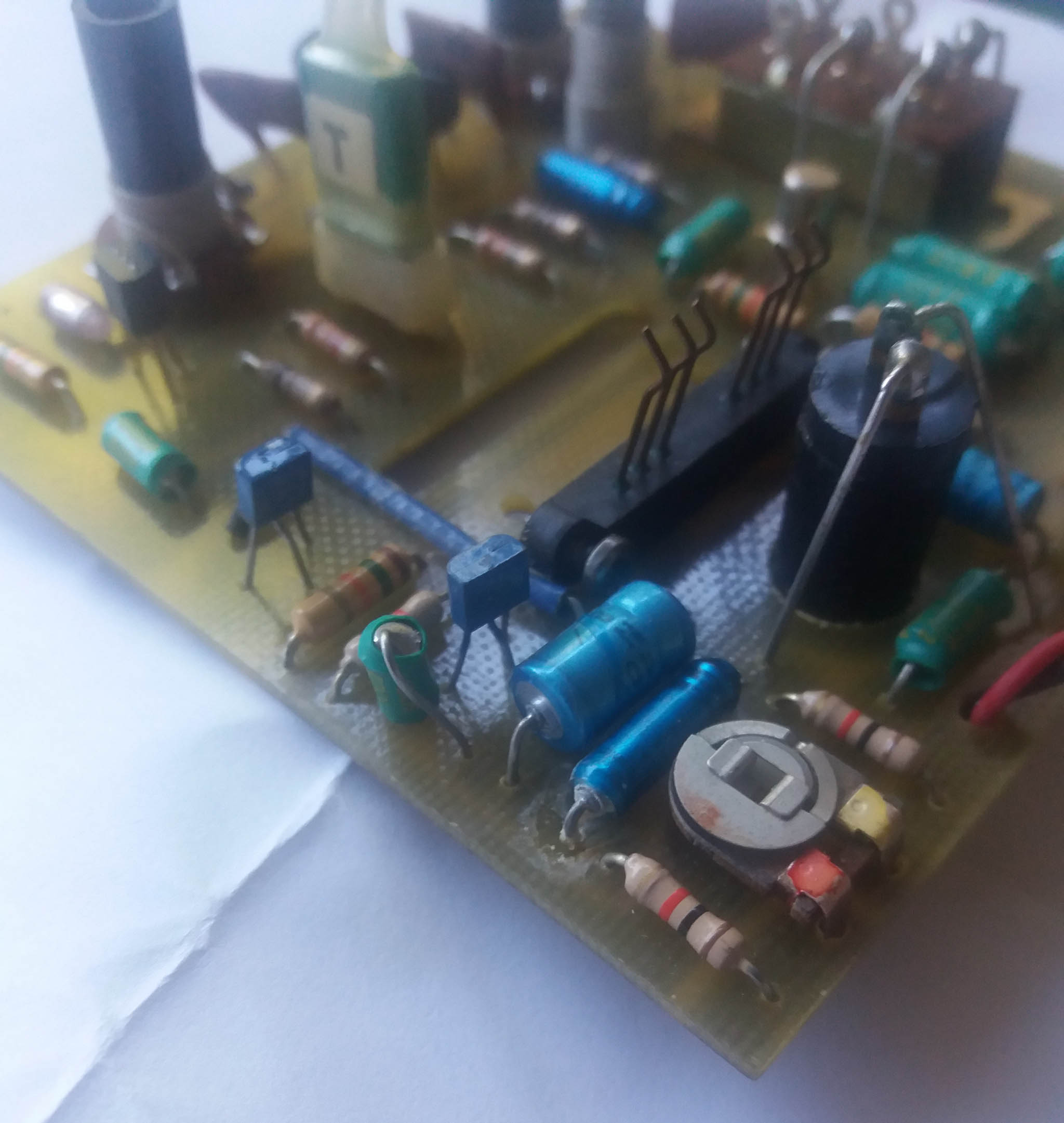

I'm putting a Macgregor Codamac back into working order, and I'm having trouble identifying a capacitor. Here's a pic - you can see why it's a candidate for replacing. It's the blue one next to the pot at the top right.
Having got it out, one of the end wires fell off, so it was obviously open circuit and couldn't be tested. Looking at the markings, I see the following:
4/
10V
The 4/ does indeed look like a slash, and not a poor 7. There are no other markings. Has anyone any idea what it might be?

Yes, that is an electrolytic capacitor, 4.7 or 47 µF/ 10 Volts
Looking at the sheer size of the thing I'd say 4,7 ....

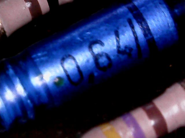

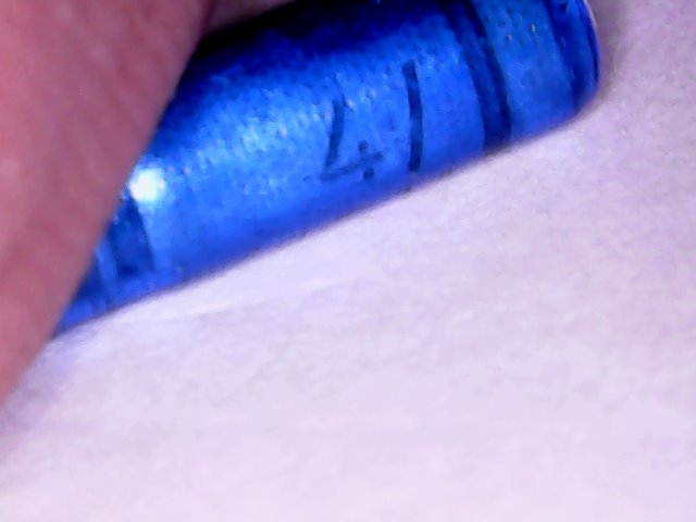

I hear the 4, but I can't see the 7. It looks much more like a 4/
I enclose a pic of the offending cap, and a pic of the markings on the only other similar cap on the board. They seem to have an odd way of marking value...
The 4/ is the lower pic you can see why I don't think it says 4.7...

0.64 seems an odd value to me as well.
640nF... The usual steps are 560 > 680

...and perhaps it's a 0.47uf. How would I tell?
