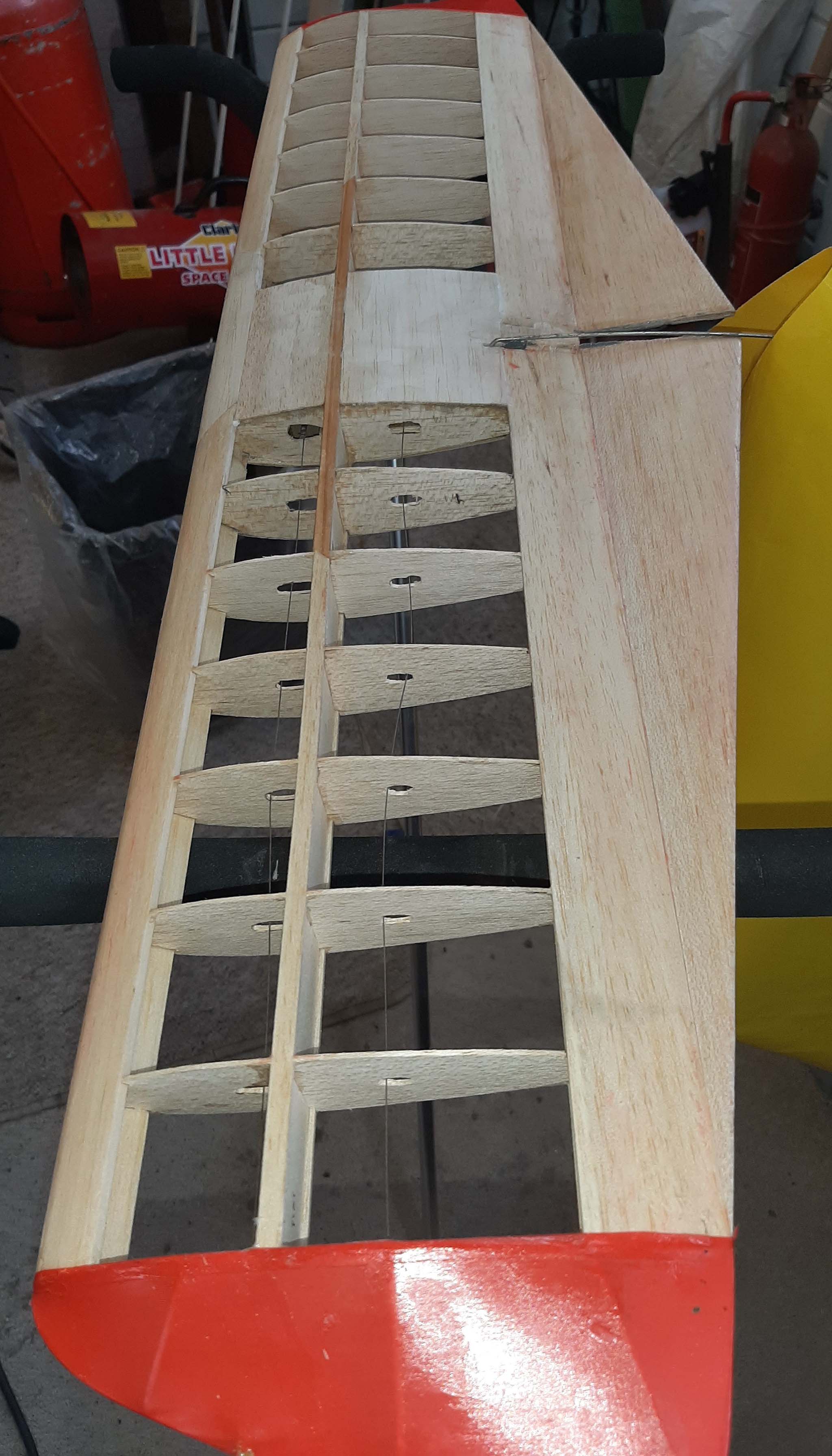

Just finishing off the rebuild of my PAW 19 powered Peacemaker, rebuild required following an abrupt stop following a vertical landing (!) which was the last part of a looping manoevre started two feet too low in altitude which snapped the wing.
Wing has been pieced back together requiring new centre ribs and with spruce spars spliced into the original hard balsa items.
Decided to go iron on tex covering route instead of the original nylon and making it a bit more colourful with yellow glosstex leftovers from the Rudder Bug wings.
Posts: 589
Re: 1958 Peacemaker
Got the wing covered in glosstex which was about 10 grammes heavier than the nylon it replaced so hopefully CG will not prove too problematic. Epoxied and dowel pinned onto the fuselage and now going to get the wing/fuz joint filled and get some glosstex on the fuselage.

Re: 1958 Peacemaker
So managed to get some good light this morning to take some piccies of the Peacemaker
Finished weight 550 g or 19 ounces.
Balances bang on where it should do (slighly in front of main spar and outboard of fuselage), so no excuses not to make a racket with it now! :D :D
Fuse and wing finished on glosstex with ferrari red Oratrim wing stripes to break up the sea of yellowness, tailplane and tips in doped nylon, all gaps, overlaps and trim edges sealed with a coat of thinned dope.
Hope you like?
