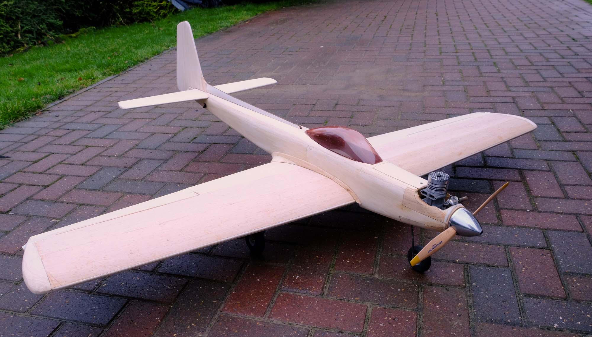

Notwithstanding the snow and other work related stuff, I managed to convert some precious balsa sheeting and block into more than a few ounces of balsa dust!

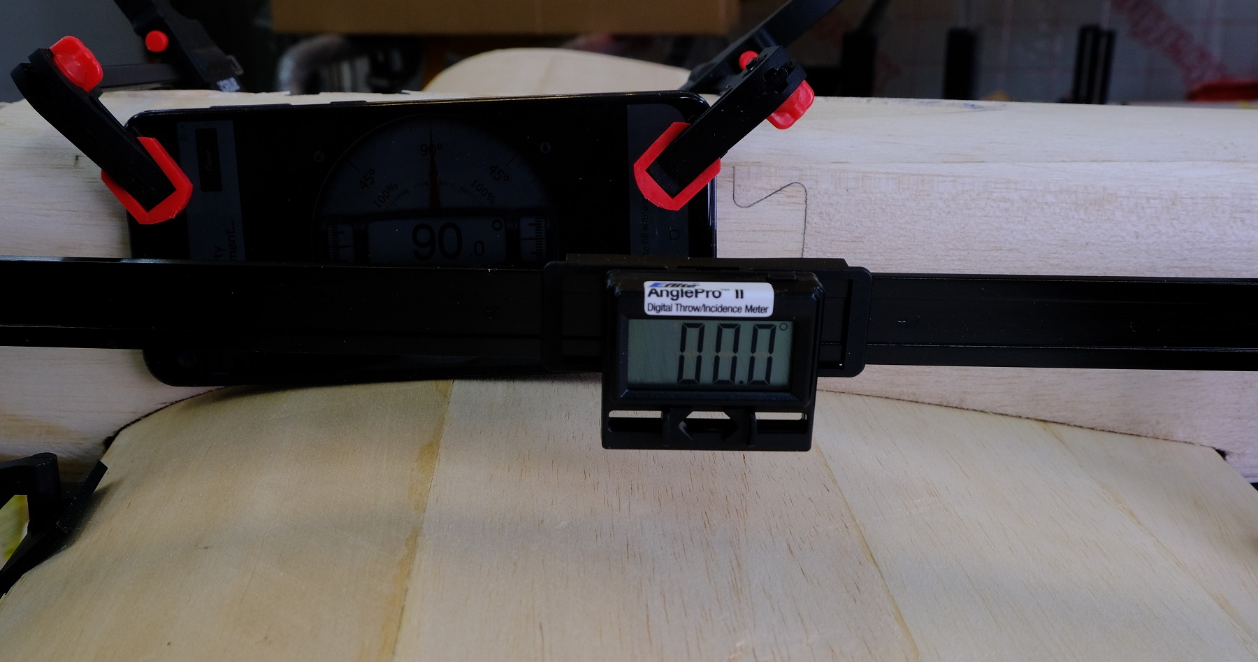

Also checked out the incidences and decalage with my new digital pitch gauge and mobile phone incidence meter app...pleased to report all zero-zero...phew!!
Made a tank hatch and also completed the underwing fairings...
it is starting to look like a toy aeroplane now!

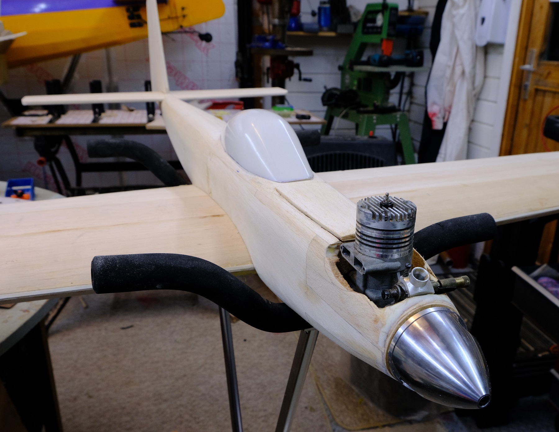

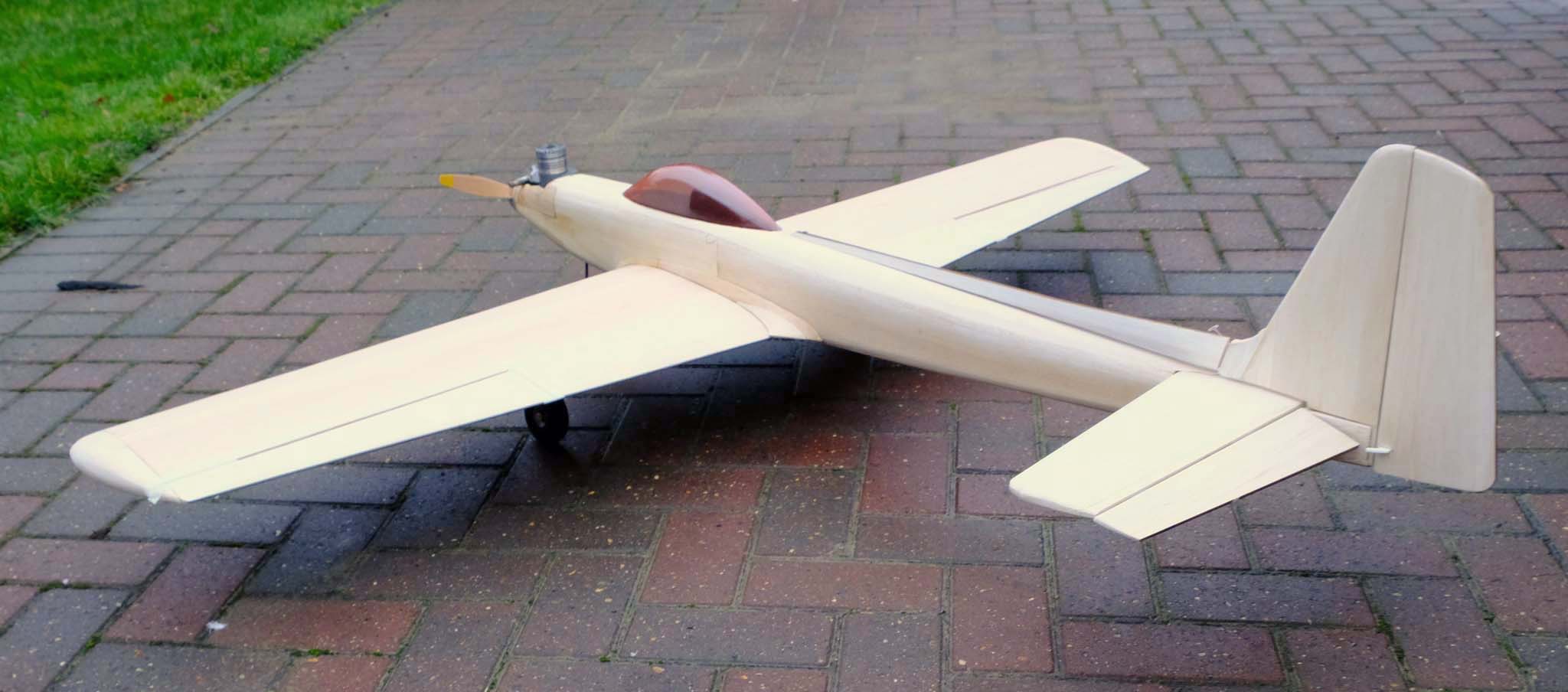

Some slowish progress since the last update with several fiddly jobs, mostly creating even more balsa dust, which fortunately the shop vac has taken care of!

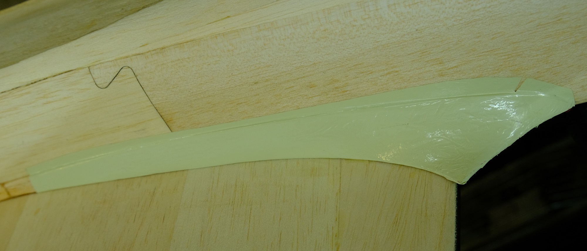

One job I had kepT putting off was making the wing-fuselage fairings which I made detachable at this stage, as I cant decide whetehr to stick them on before or after covering the fuselage..any recommendations???
I spent some time tidying up the tailcone and again was mulling over whether to leave the tail off until the fuselage sides have been covered.
The wing has had quite a bit of sanding fortunately the 2mm carbon rods I had ordered to add to the trailing edge arrived today; so they were a cinch to bond to the trailing edge with thin cyano and really toughen this area up with very little weight penalty.
So I was able to finish sand the wings and cut out the ailerons and was pleased my pre- installed hinge slots all worked out find after cutting and bevelling the ailerons....PHEW!
I had completed the cockpit floor and airbrushed the canopy with Tamiya clear red as the fuselage top will probably have some red there when the covering is complete...

Stuart - The fairings on mine were stuck on pre covering.
It would be easier covering them first but then you would see the join.

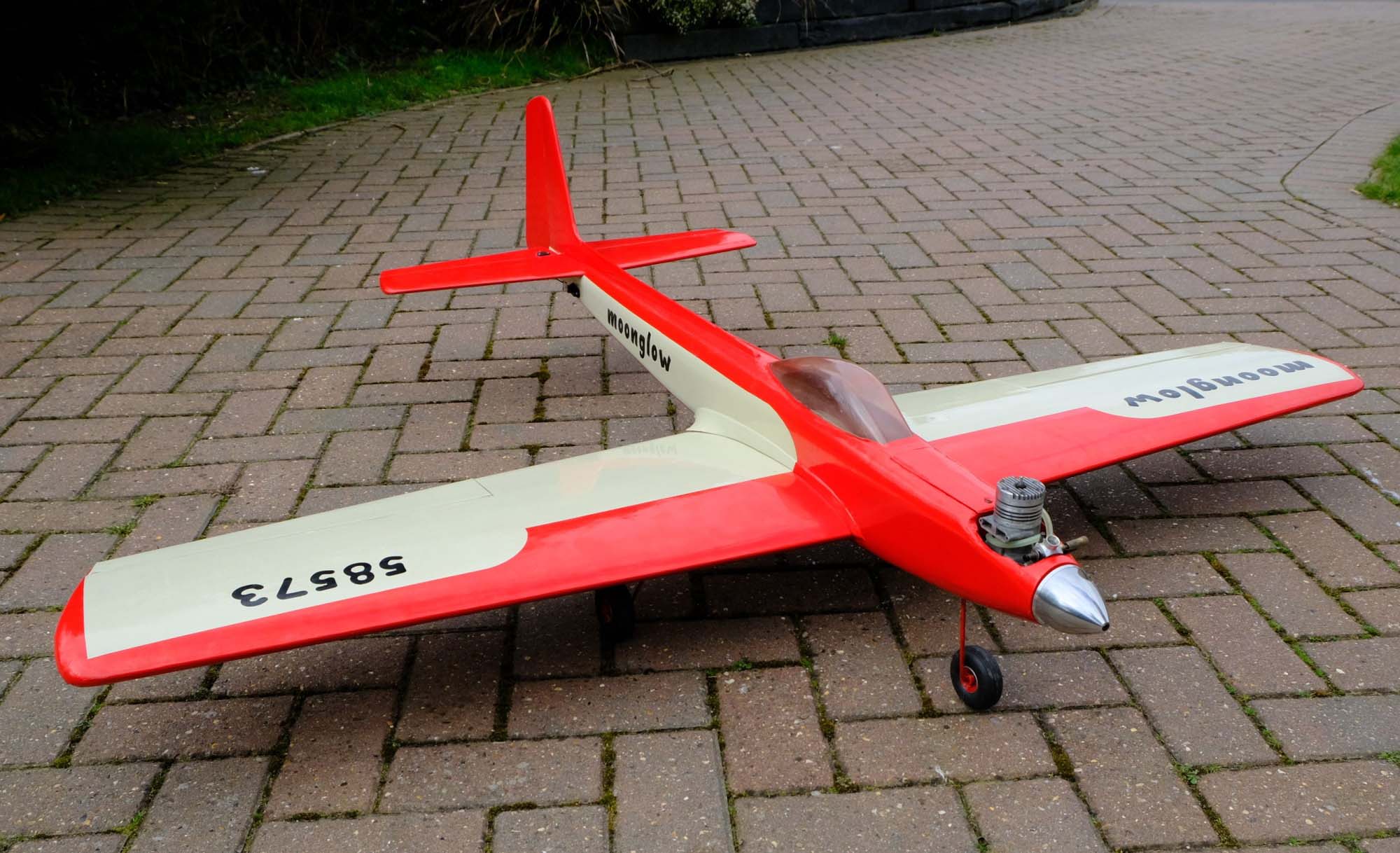

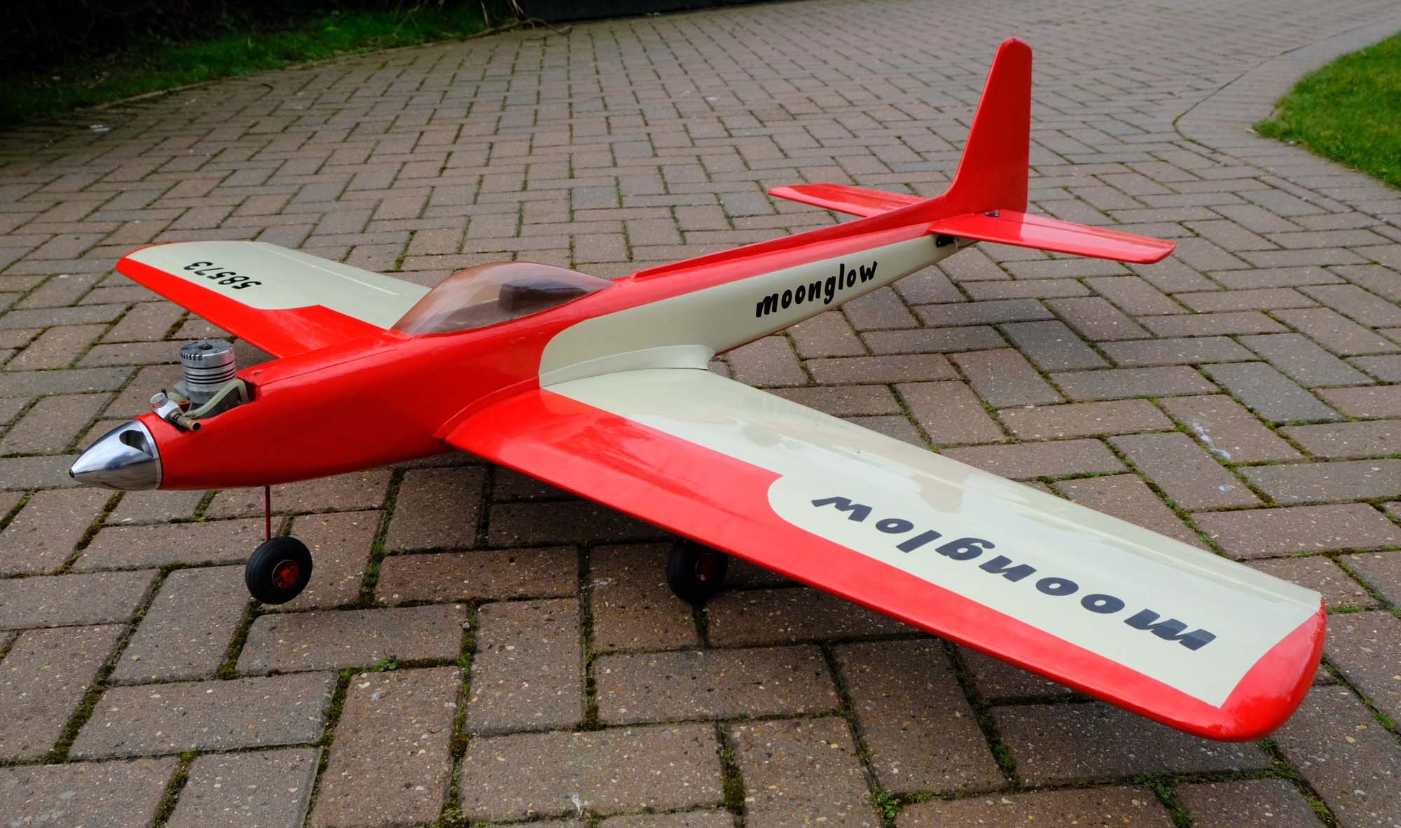

Final, obligatory driveway pics taken in the damp overcast this afternoon prior to switching the iron on!
Weight as you see it with all servos and battery is 2350g or 5lbs :D Hopefully, I can achieve my target dry weight of 5 3/4 lbs?

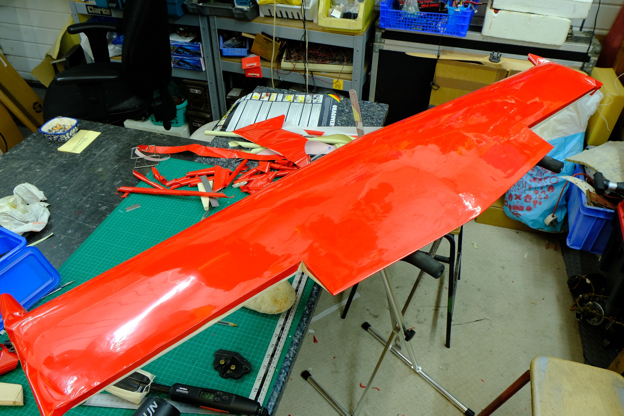

The colour scheme will be a blood and custard for those railway buffs amongst us :lol: :lol: , or in my case Ferrari red and cream Oracover based loosely on Mr Birch's original scheme.

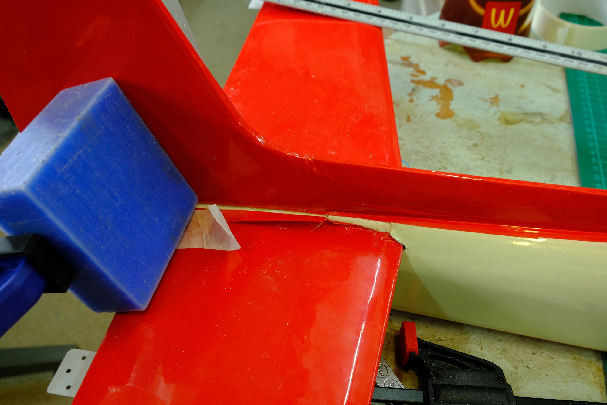

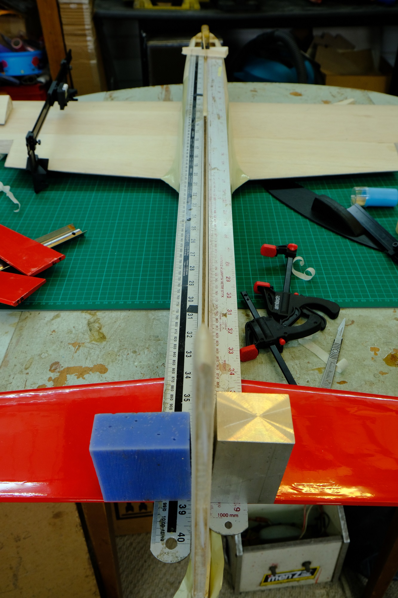

Iron and heat gun at the ready and I started on the wing fairings and managed to get the concave rear sections of the fairings covered ok: and bonded them in place and put the rear side and lower fuselage covering on first. I wanted to get this done, so I could then get the stab covered finally aligned and bonded with epoxy into place.

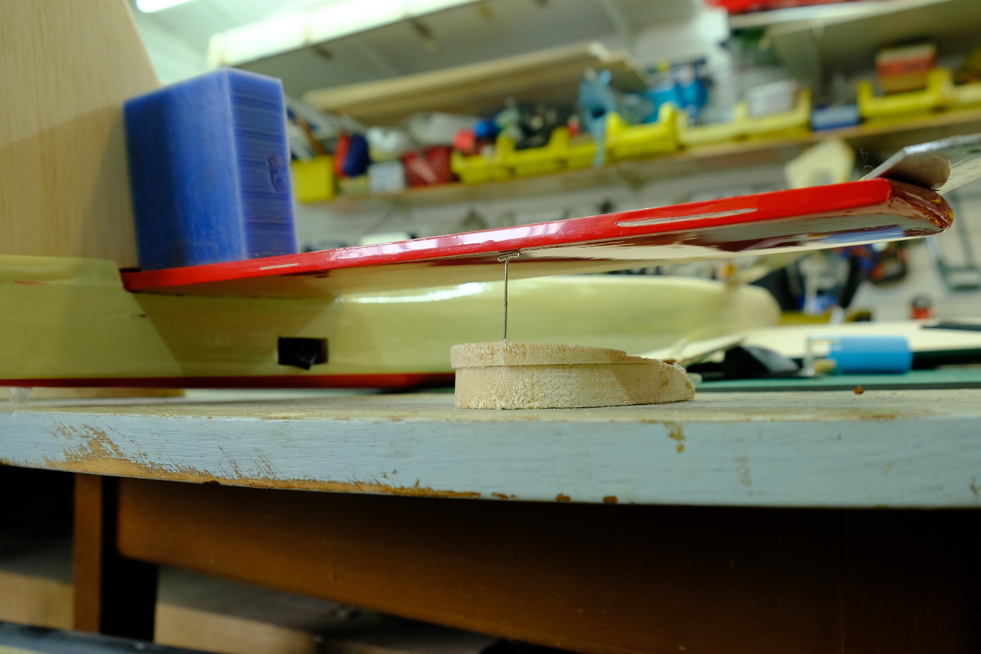

Next was to cover the stab (and luckily the second digital incidence meter that I had ordered arrived in the post this morning) and it was then a matter of jigging the model on a flat surface and, using two meter rules clamped to a fuselage centre line datum, I was able to triangulate the stab in the correct position
and aligned horizontal and in incidence against the wing using my improvised (balsa block and T pin height gauges)
and two incidence meters (one on the stab and on one wing tip)
More measurement and cutting away the covering on the stab underside and it was out with the 30 minute epoxy and go have a cuppa and write this!
Well the cuppa turned into teatime and the epoxy wasn't going off!! so get the methanol out and scrape it off and get the UHU Endfest to the rescue and it is sitting there in a nice warm workshop, so hopefully a few hours and it will be glued solid!

Testing the alignment was ok was made using my two metre rules clamped to my fuselage datum point (see pic) Only a small amount of adjustment to the fin post was required to get vertical and longitudinal alignment spot on.

I made a start on the wing underside and this has worked out fine so far!

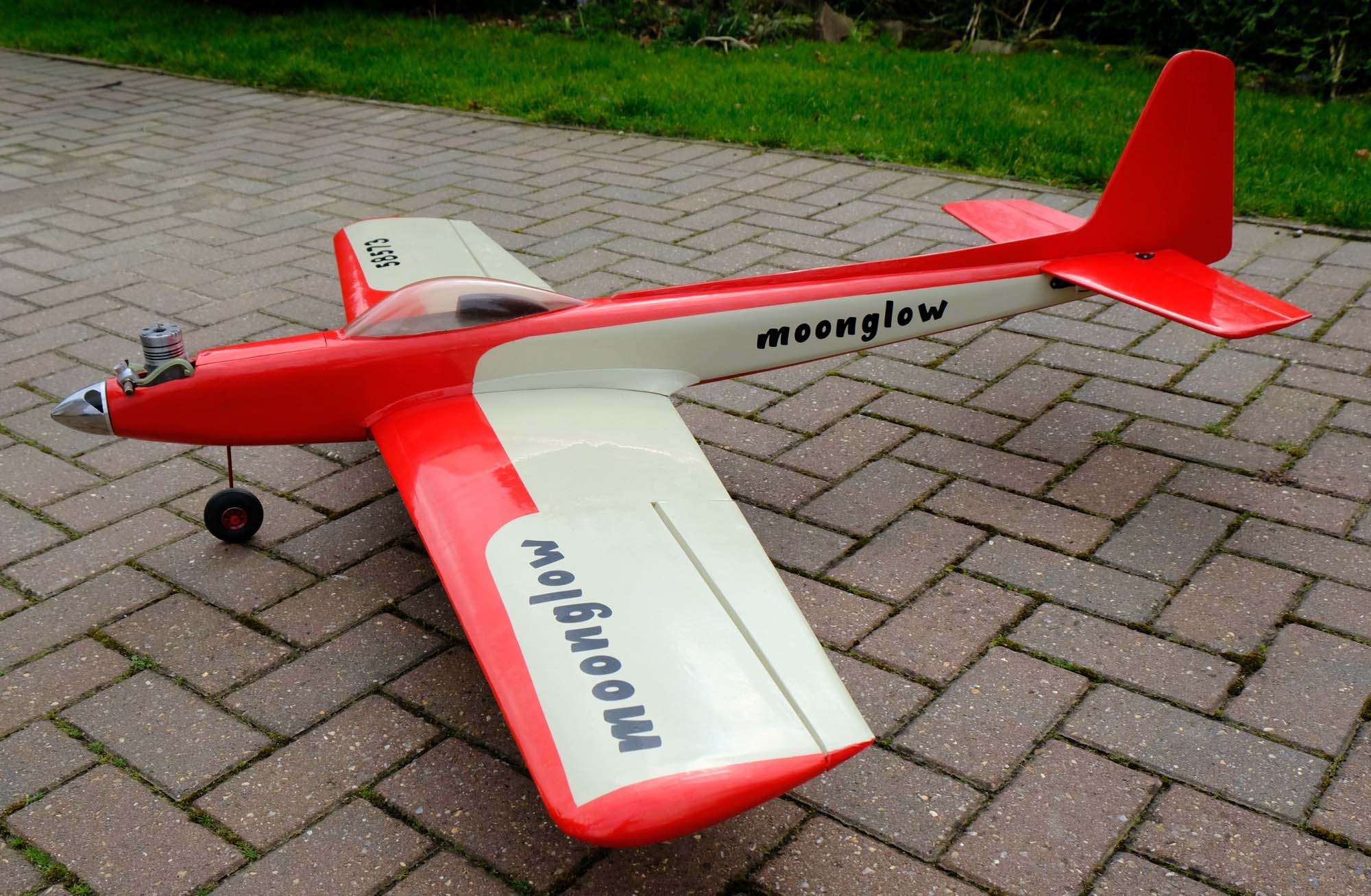

And here is the finished article!
Ready to fly 90 ounces 5 3/4 lbs
