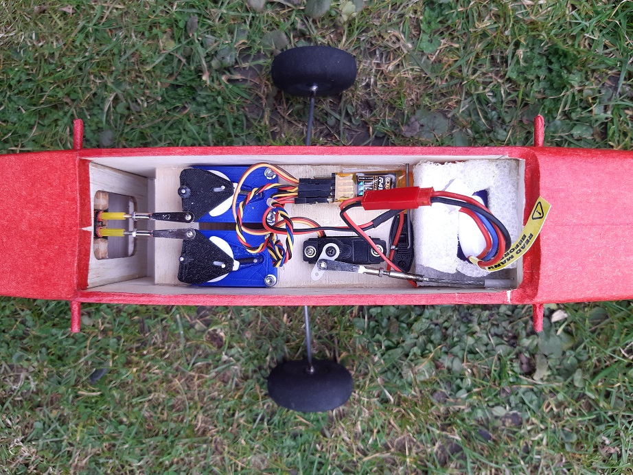

I've just finished my new Junior Falcon Galloping Ghost project, which was also a "learning project" in 3D printing. It was prompted by the coincidental timing of my aquiring a 3D printer and Tobe publishing the files for his Mini GG actuator. Here I want to thank Tobe for all the help he has given both in supplying parts and amplifier/recoders and helping me with advice on how to print them myself. Tobe prints his actuators in ABS but I didn't have much success with ABS and mine are printed in PLA+ (Blue), PETG (Black) and only the white disc is in ABS though this part is the most highly stressed part so hopefully the actuators will be OK in service........

Even if you haven't used the best plastic when 3D printing, if the parts wear out after a few sessions, just print some replacements. I could sit and listen to a GG actuator waggling away all day, who needs to fly them?! But I'm certain it will fly well, it's hard to believe that with all that waggling about, you see little or none in flight. And with separate rudder/elevator actuators you will probably have a little more authority than a Rand LR3.

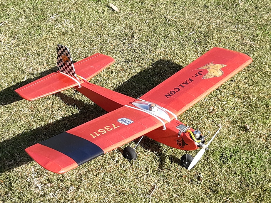

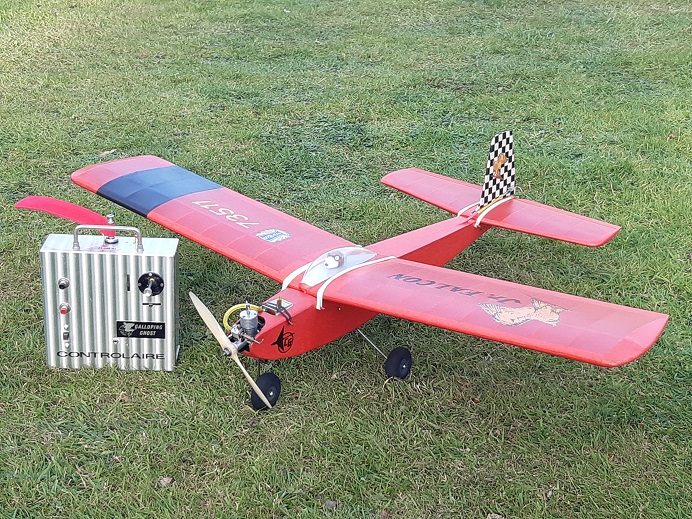

This evening the wind dropped enough to test fly the Jr. Falcon and I'm pleased to report that it flies just as it should and really looks the part, wagging it's tail as it goes! The Transmitter came from Shaun, and I converted it using Phil's 2+ Progressive Fast/Slow button encoder. So with Tobe's GG servos it was something of a "family affair"!........ Thanks Guys!

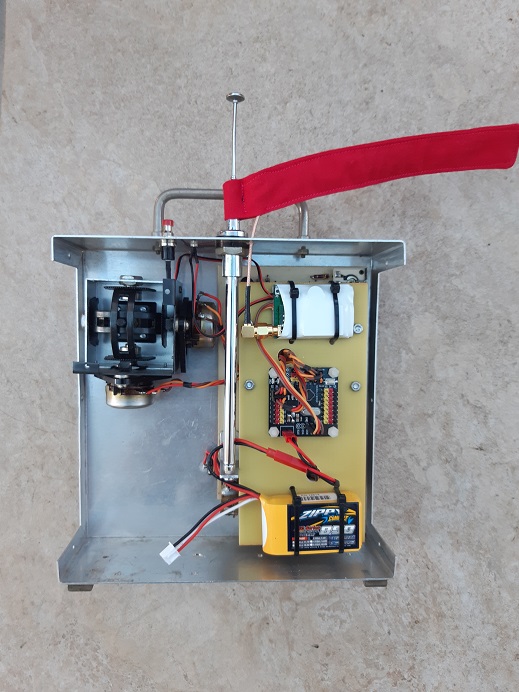

The transmitter conversion wasn't entirely straightforward because the Fast/Slow buttons, On/Off switch and antenna mount were all integral parts of the original board so I elected to keep that board in place and isolate the buttons and switch by cutting away the PC lands. I then piggy-backed another board onto it for the Orange module, new encoder and battery, taking wires from the original buttons and switch up through the new board.....

Tx conversion looks neat Paul. I like the stick they used in this set as it has a quality feel.

Thanks Shaun, yes they used very strong centreing springs....... There's no doubt about where neutral is!
