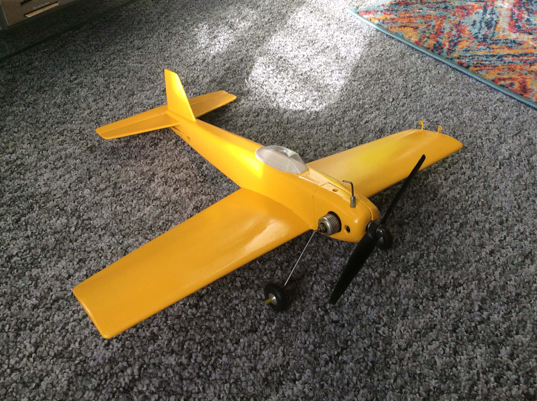

My current model has a Torcman NT350, capable of 800 Watt peak.
Coupled with an APC 13 x 6.5 E/F2B it's really something.
Model weight is 1735 grams
Aiming at 5.25 - 5.35 sec lap times it pulls like a freight train (relatively speaking, for such a relative small model).
I flew it in contest in Germany last weekend and in spite of the sometimes lively breeze it remained very controllable.
