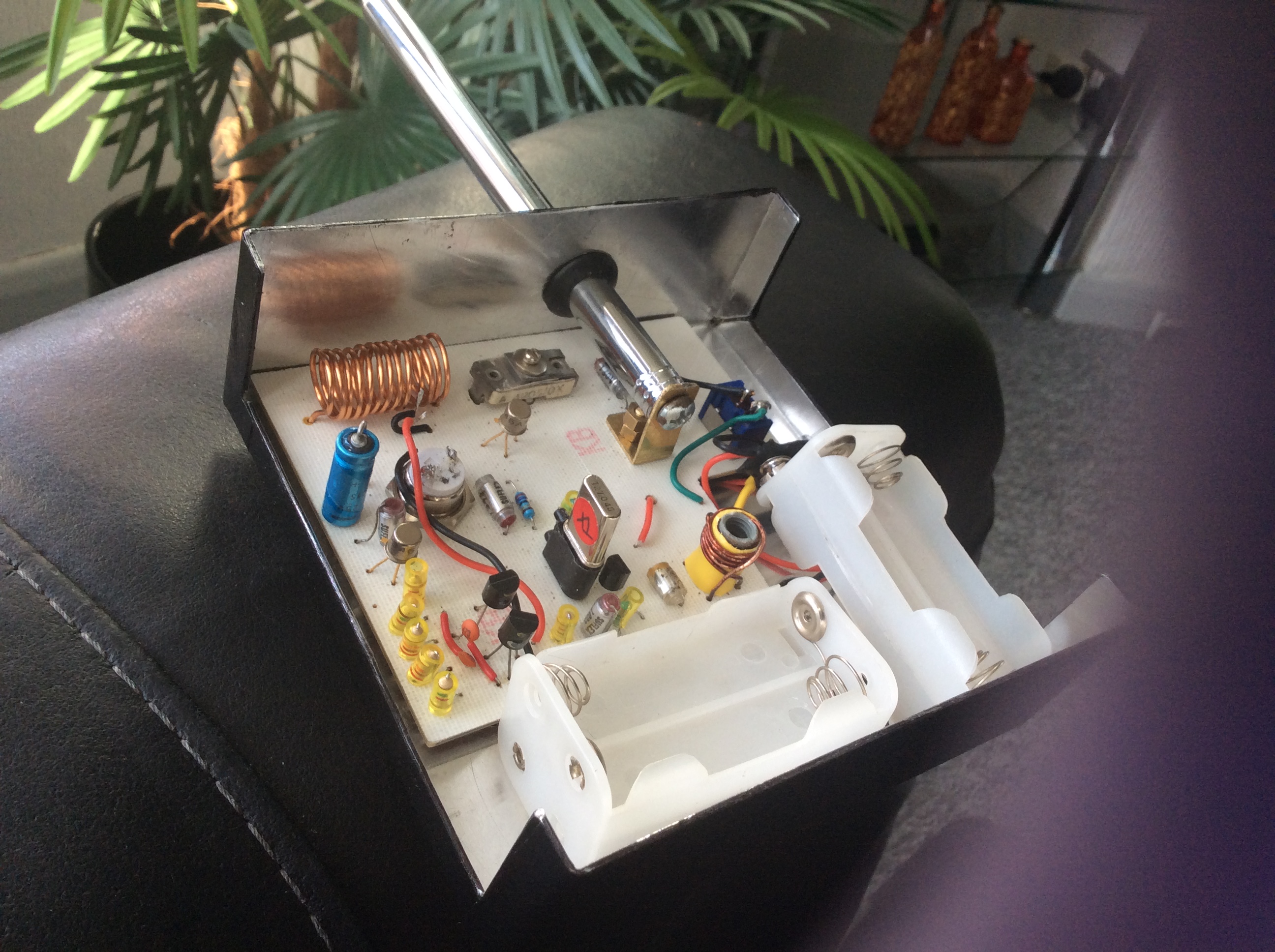

Hello lads ,
Success! It’s taken weeks ( not full time was finishing a couple of live steam engines) to find out what was the problem .First I tried a new oscillator coil no luck .changed one of the transistors , a different trimmer. Checked and checked the components. Still no joy ! For some reason the on off switch gave up .Still not working. Had a look on the net see if there were any ideas 💡 Came across a suggestion to check if it was oscillating put the TX next to an AM receiver .So using a transmitter that I new worked success.Must build a FSM) let’s try the simpletone to see if it was oscillating. Didn’t bother with a new switch,just connected the positive wire and left the negative loose. Obviously there was no signal,I just happened to touch one of the caps there was a slight buzz on the AM radio so I continued to prod around . Success I had the illusive tone ! I tuned the coil to get the strongest signal. Set up a rx and escapement. Hurray It works. Now for the embarrassing part . I looked where the negative connection was Guess what there was a duff joint it was hardly noticeable but there it was .so after all that F ing about I had the answer ! Thanks again for all your help I’m now going to get on with my knitting that shouldn’t go wrong or will it ?😂
