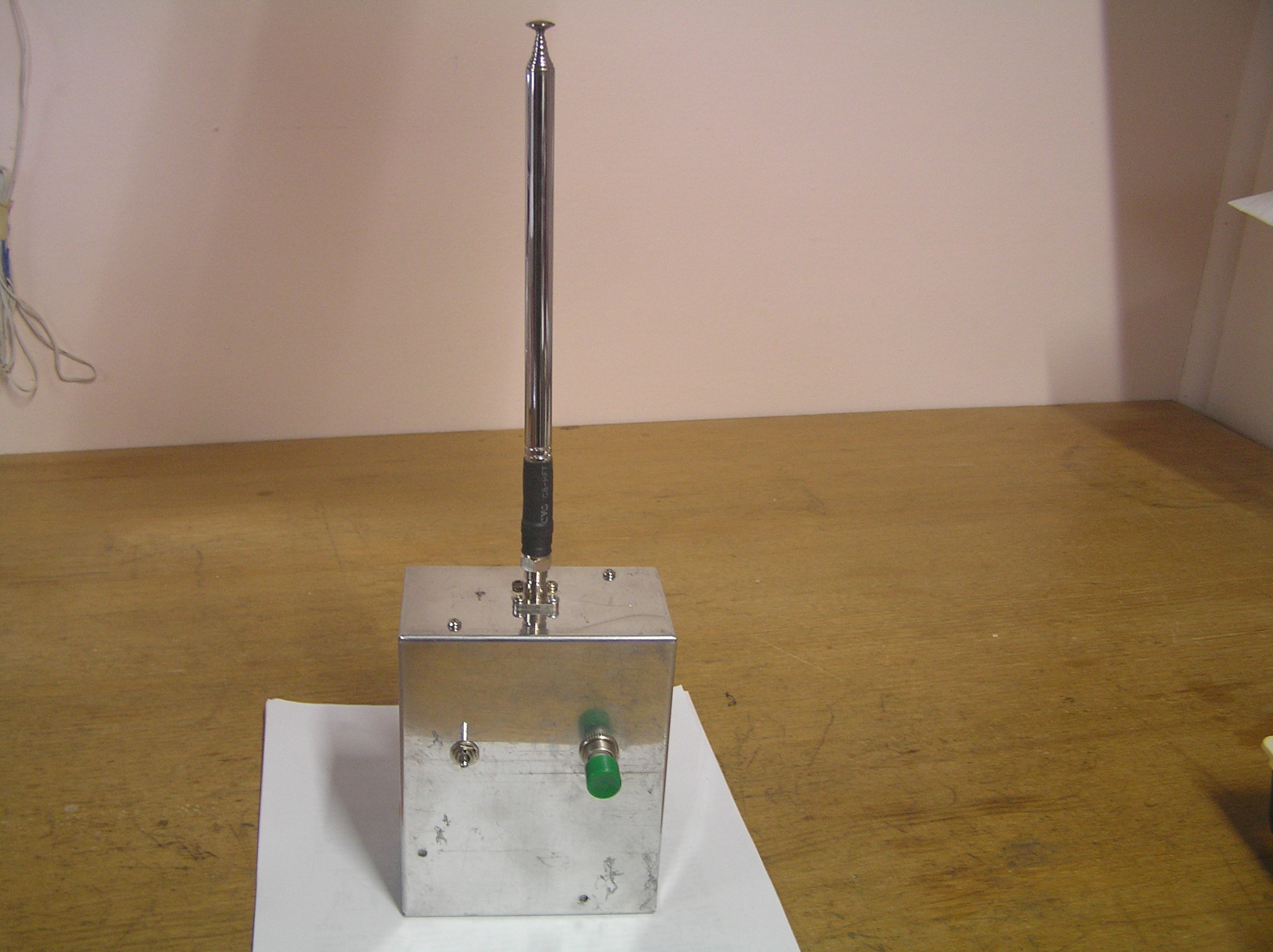

Well, I decided to re-purpose the RCS 27MHz electronics and fitted it into a second-hand aluminium enclosure, together with battery , on-off switch and microswitch button. Good strong output signal. I'm u sing a 1.2m telescopic antenna, but the RCS Guidance System MkII tx used a centre-loaded antenna. I now need to figure out the best way to add a centre-loading coil. I've got a "Rig-Expert" Antenna Analyser (very nice bit of kit, by the way) which should make the job of setting up the loading coil a bit easier.
Here are some pictures of the transmitter. The battery is made up of two spare 'Eneloop' flight packs connected in series, giving a supply of about 11V when fully charged.

Might be easier to add a base loading coil, rather than centre loading. Around 2uH should do the job for 27 MHz.
There's a handy whip aerial calculator here: https://daycounter.com/Calculators/Whip ... ator.phtml
For the diameter, use the average (telescopics vary from base to tip).
I was never a fan of centre-loaded aerials, as only the bit above the coil seems to radiate. Up to 1/4 wavelength, I'm a firmer believer in the old loudspeaker rules - "The bigger the better!" :)
Also, base loading is less prone to damage, and makes the aerial easier to replace!
The coil doesn't need to be anything special, as the Q will be fairly low anyway. A moulded choke of appropriate value would probably do nicely.

Thanks - your comments make a lot of sense. I'll try a base loaded antenna
