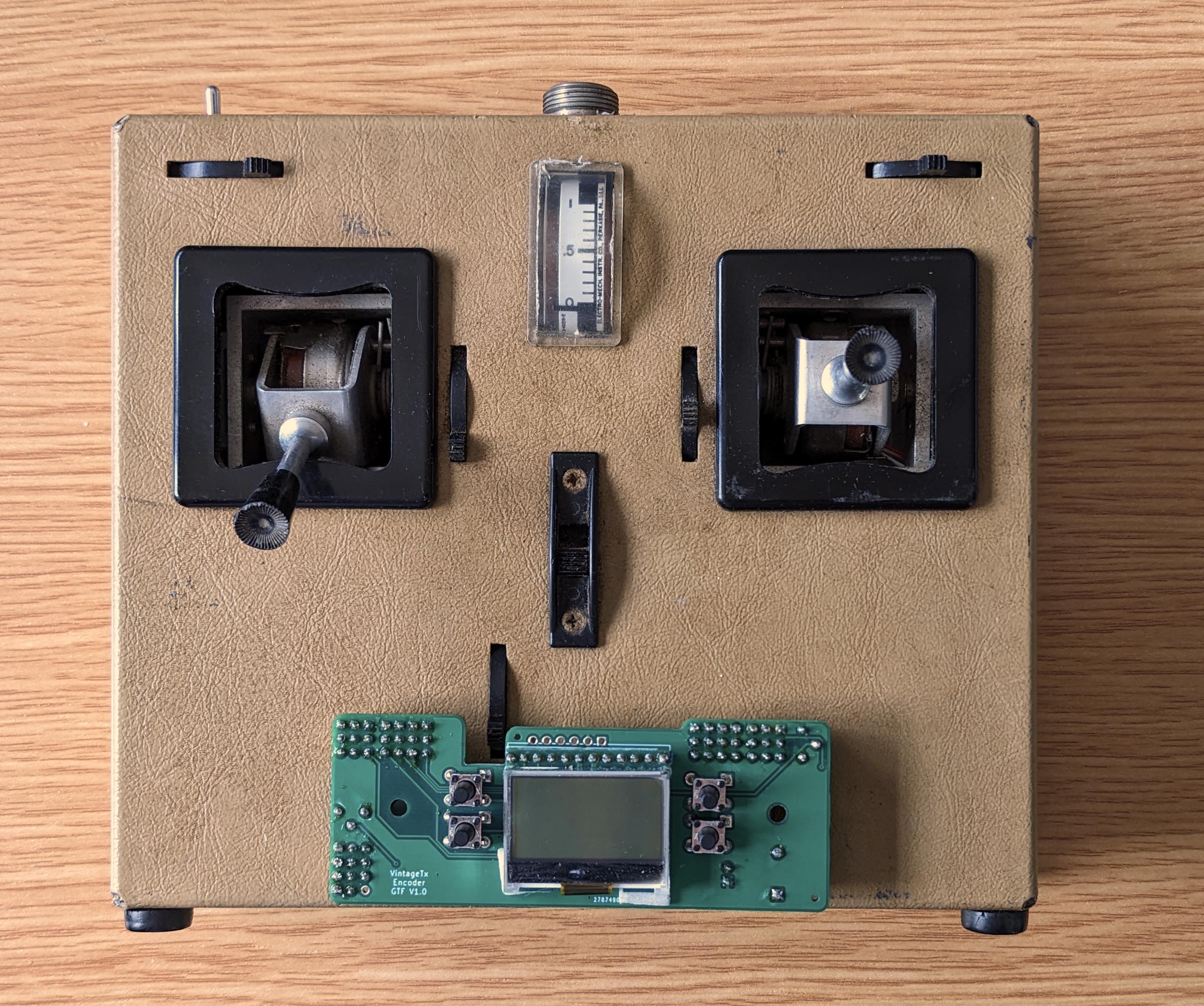

Re: S & O Proportional
Hi Wayne
I've designed a dedicated encoder board for the Futaba M6 (FP-T6FN elsewhere in the world) that nearly fits the S&O, the auxiliary lever just fouls the "slot" in the pcb. I'm going to see if I can file away the bit of the PCB that would foul the auxiliary lever (I don't know how bad an idea it is to file away a bit of a multi-layer PCB, but I know there are no tracks in that area) and then have one of my standard conversions with the encoder LCD and menu switches hidden behind the S&O badge. The worse that happen is that I mess up a circuit board, but I've around 20 left, so it wouldn't be a disaster.
I know there are a few S&O in the USA, it isn't unique, so I have no reservations about converting it. It seems the perfect candidate, it has a label in the correct location to hide the LCD and menu switches behind and it has such lovely joysticks that I fancy it as an everyday transmitter. The only downside is I will need to design a new circuit board to fit. Or rather I'll modify the design of the encoder board I did for the Futaba M6, so that it will fit both an S&O or a Futaba M6, there is a minimum order to have circuit boards manufactured and doing a "one-off" isn't cost-effective, but getting 20x boards is.
There is zero chance of me converting the Skyleader 3+1. I don't know anybody else who has one, so I would be reluctant to convert it on that score. Secondly, the Bonner joysticks are horrible, so I wouldn't ever use it even if I did convert it and now I have the matching Rx and servo's I plan to try to get it working again. The same for the Skyleader 4, I have managed to find a matching receiver and servos for that too, so they will both be restorations, not conversions.
