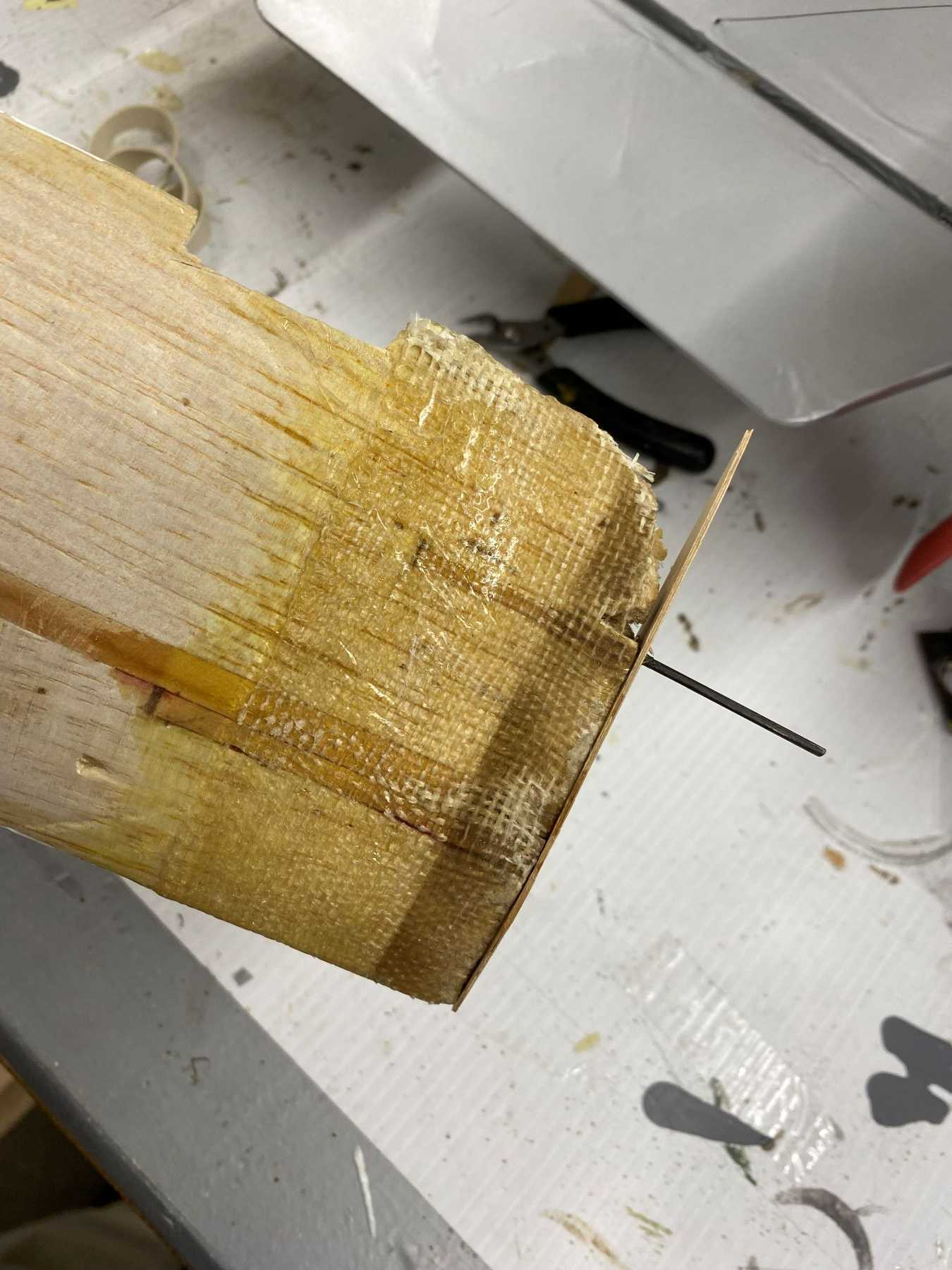

Stripping back the duct tape revealed a two piece wing with wire joiners, but with the wing roots in a perilous state of disrepair. I've cut a pair of thin ply root ribs to preserve the dihedral angle and started filling in the biggest gaps with balsa, trimming the mutilated trailing edge to a viable grafting face and refixing the wing joiner tubes, which were very sloppy. The wings are solid balsa with a hardwood spar and very high aspect ratio, as a one piece it only just fitted in the car, but as a two piece I reckon it will be a great extra soarer to fit in the rucksack.

This one looks like it's seen a lot of flying Phil and it does have that carved in washout as mentioned on the plan, which I've been careful to preserve during repairs.
I'm just about at the covering stage, but think I'll add a lightweight glasscloth bandage to make the wing roots nice and sturdy. Have decided to just go with replacement Solarfilm, even though it's my least favourite covering film, rather than laminating film and tissue. I'll add a bungee hook, as I don't currently have a bungee capable glider.

Thanks Tobe - the wing roots were the main thing to be sorted and they were in a very bad state, I've inset some suitably hard balsa to take the stress of the wing bands and reinforced the mating faces with some thin ply. Now, before covering I'll add a wrap of lightweight glasscloth to restore the rather rubbly surface of the old fibreglass bandage, before recovering.

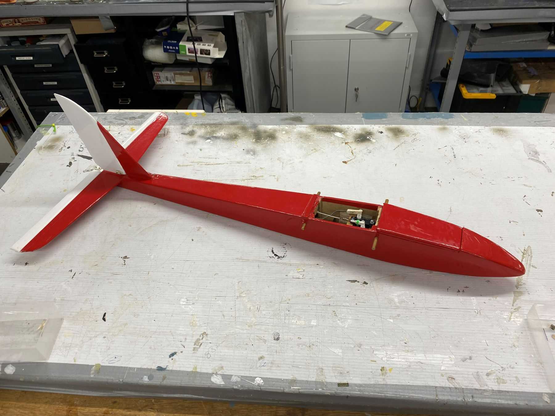

Miniphase restoration coming towards completion. Fuselage finished, all recovered, control surfaces rehinged and linkages restored, servos, receiver and a wee GWS 2A brushed ESC installed as a voltage regulator, to take a 2s1p 450mah lipo as a battery pack. I've inset a small hardwood block on the fuselage floor, under the servos to take a bungee hook and allow for adjustment in the position of that, but will try the model on the slope first.

The wing roots have been repaired, with a replacement glasscloth bandage applied with Eze Kote and a smear of lightweight filler to fair it into the balsa repairs. All goes together nicely and will be recovered with white Solarfilm today.

The Mini Phase is all done and ready for a maiden flight.
Needed to add quite a bit of lead up front to balance the model, using a lighter Lipo pack than what I guess would have been a NiCd or maybe even a DEAC and much larger receiver than the wee Frsky 4 channel job. The servos are fairly lightweight too, but they are bang on the CG so wouldn't make a huge difference. Haven't weighed the model yet.
Covering is from my dwindling stocks of vintage Solarfilm and there wasn't sufficient white to do both wings. I did consider doing the topsides white and undersides orange, but decided to go for the orange on one wing. Logos created and cut from vinyl using the Silhouette Cameo. Luckily I still had a Micro Mold tow hook in it's original packaging and so could scan that to make the logos.
